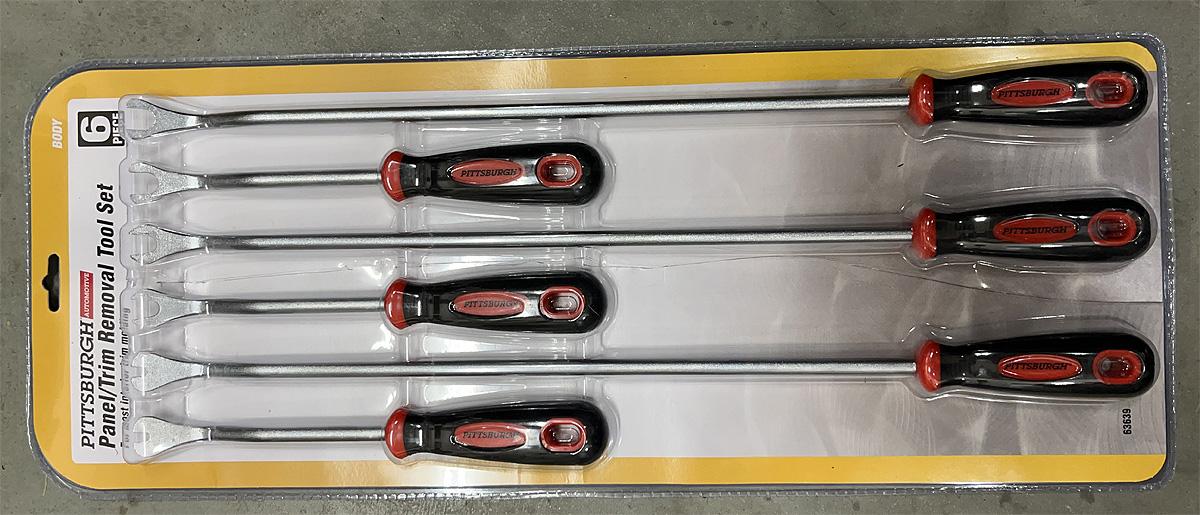

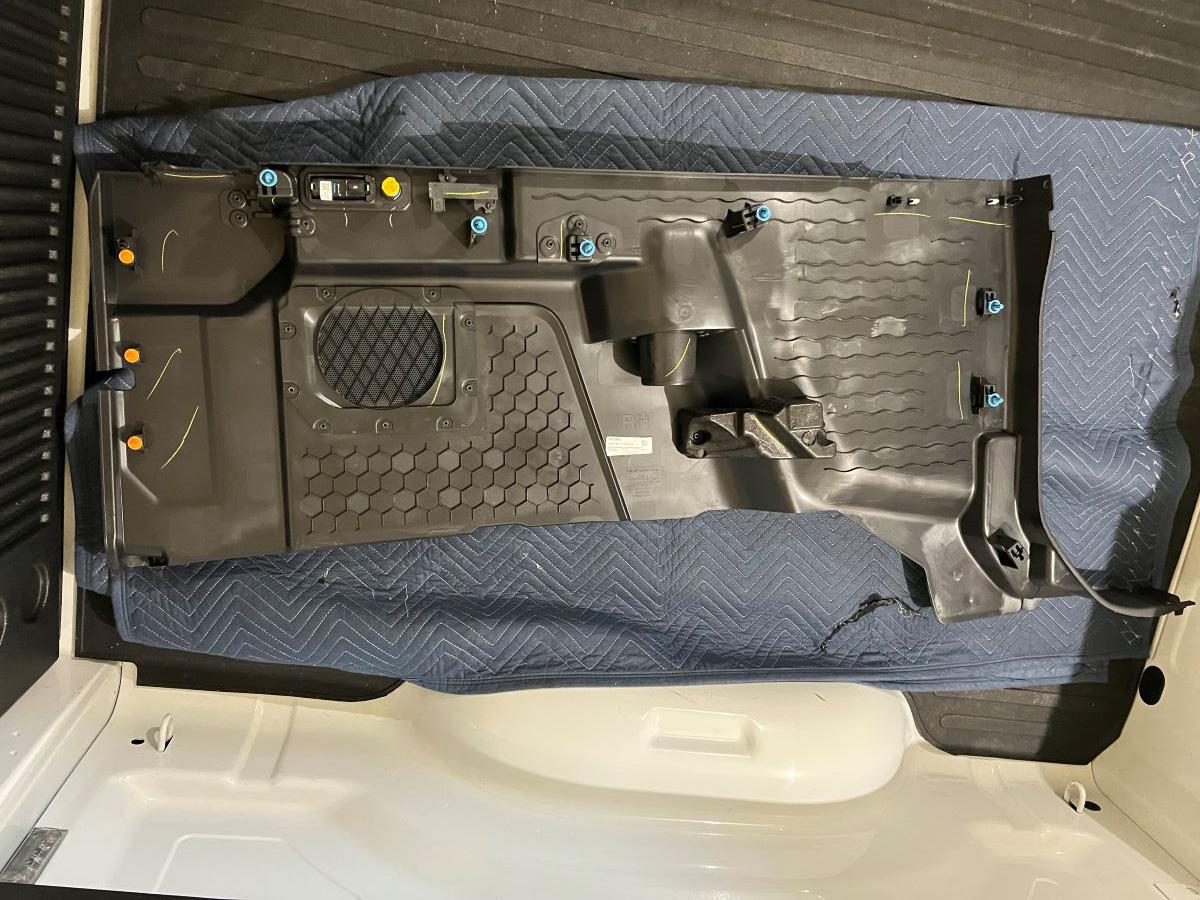

Just pulled the right rear panel on our 2d (prepping to install an OEM Fusion sub amp and Kicker 48CWRT674 6.75" subwoofer). This Harbor Freight Panel/Trim Removal Tool Set allowed me to remove the top clips with very little to no pulling on the panel itself. Started at the front passenger pillar, then worked towards the rear cargo area. Bent the upper part of the panel slightly more outward for easier access as I removed each clip . Was able to easily reach 3 of the 4 clips on the top part of the panel using the longer 19" trim tool. Used the shorter one on the last top clip by the rear cargo area. To clarify, I removed the 3 clips on the side of the passenger pillar first, the 4 top clips next, then the 3 orange clips in the rear. Zero damage to any of the clips.

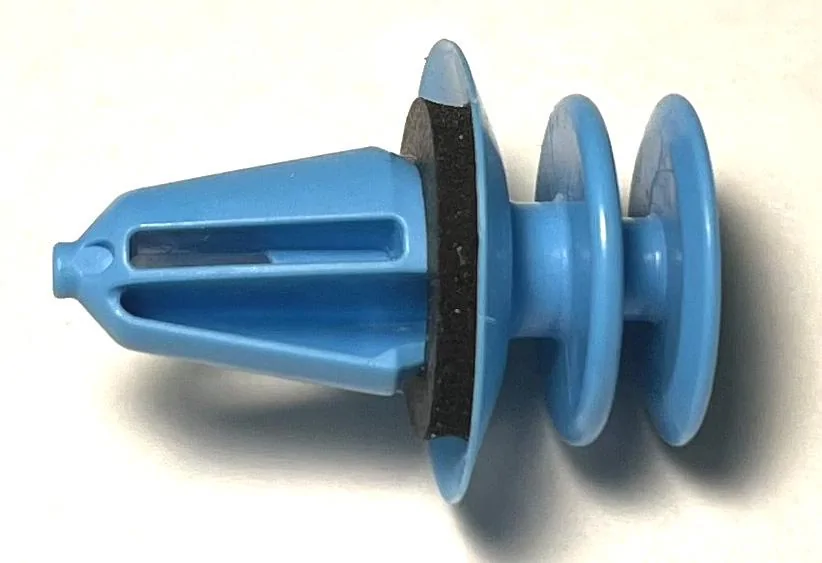

For some reason the factory used (one-piece) blue clips in our panel. They look decidedly different from the two-piece, white W721378-S300 clips (referenced earlier in this thread). Unfortunately, the factory forgot to install one clip (by the rear seat floor area), so I have to order one. To my eyes, these blue clips look somewhat similar to the (one-piece?) white clips with the part number W713297-S300 also mentioned earlier in this thread; however, someone said they were too big. Not sure which one to order. Probably order one of each--lol!
Ford Bronco Replacement clips for rear side panels HF Trim Tools
Ford Bronco Replacement clips for rear side panels Blue Cli
Ford Bronco Replacement clips for rear side panels Right Passenger Side Panel
