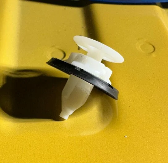

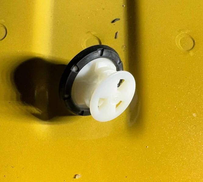

Be prepared to break some of those stupid way too expensive white plastic clips!
Grrr...
Anyone know of a place to get a handful of them for NOT ridiculous money?

I don’t think you’re going to find those type of clips anywhere other than a Ford dealer.

I took one off a ‘23 yesterday and they were blue instead of white. This was on a 4 door.
My 2 door ‘22 has those white ones so not sure if they changed them or what.
Only place I could find the white ones were Ford.

Blue ones are the updated clips. I don't remember exactly when they changed it, but the part number for the blue ones is W722128-S300
They're also less expensive than the previous part. Cheap enough to have on hand for "just in case."

Regardless of color:
The “old” style are like a button: part of the clip stays in the body panel and snaps to part that stays on the trim piece.
The new style is one piece - and a complete pain to pull out with some of the plastic trim being plastic-rivets and what not. It’s a lot stronger fastener. Much easier to install though

I am planning to remove the panel today. Do I pull to get the panel off of these white clips out since they are inside and not reachable via a tool?
You can try. The clip slides into the slot on the trim piece but I don’t think there’s room to slide the panel off all the clips. The panel is big, awkward, and in there pretty tight with a seat and seat belt all in the way.
I’ve always just had to go one clip at a time and cry a bit every time one doesn’t go exactly right
They are made to have the barbed end be pulled from the body panel with a trim removal tool. But most of them are in the middle of the trim piece and you can’t get to them with a tool so…
Best of luck!
If you can pull as close to the fastener as you can get you might get lucky. Have e6000 glue and/or a plastic welding kit standing by for that damned part that is plastic riveted together - for me that always goes before the new fastener pops out
You can see why they tried the original design, it was just the button part had a tendency to come unbuttoned and start to rattle. They really should have just went to an exterior-accesses bolt or something.
