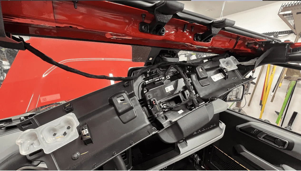

There are four screws to remove, one under each sun visor mount (hinge and holder each side). Once those are out you should be able to pull down on the console and it should pop out. You'll then see what else you may need to dismantle depending how far you're going.
Edit: the hinges are 7 or 8mm, the holders are a torx that is a PITA.

Here's what it looks like under there.
