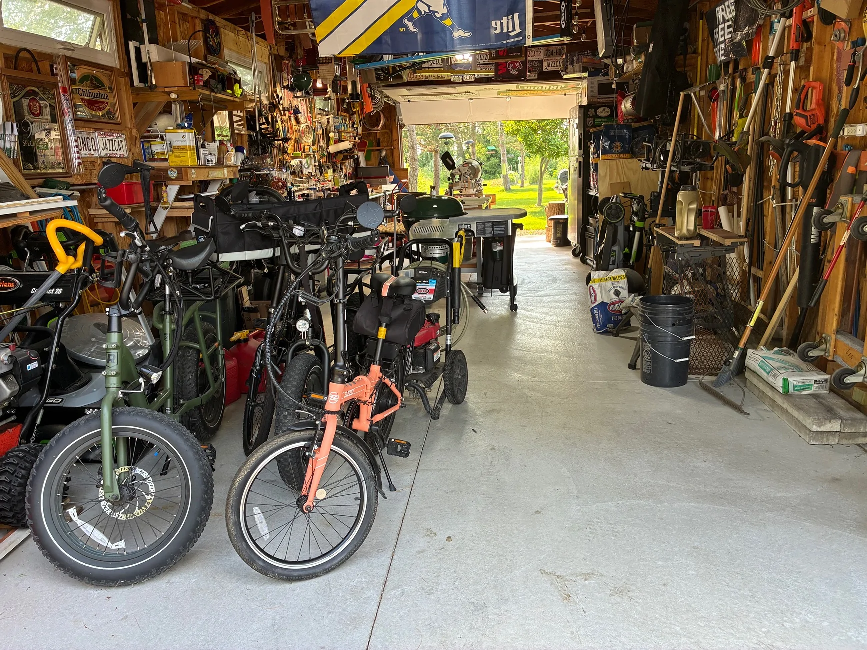

In full transparency, My wife's Subaru has to sit outside when the roof is off, it's a price I'm willing to pay.😅
This is my two car (deep) garage.
Our two vehicles sit outside 24/7… 365 days a year.
The garage is for storage and my work shop.

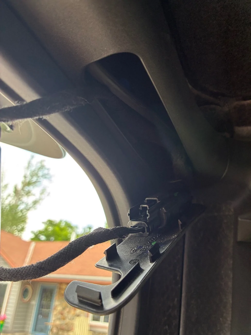

I've taken the glass out many times as I swap it back and forth with my custom half cab...its easier w 2 people, but only takes a few minutes.
How did you remove the wiring leading to the wiper mechanism?? I see no easy disconnect at all.
I recall the plug behind behind the upper trim panel on the rear upper inner portion of the roof. I think it just pops off...the plug has about 1 foot of wire from where it slides into the window Chanel on the drivers side.
Yes, I found it after a short search.

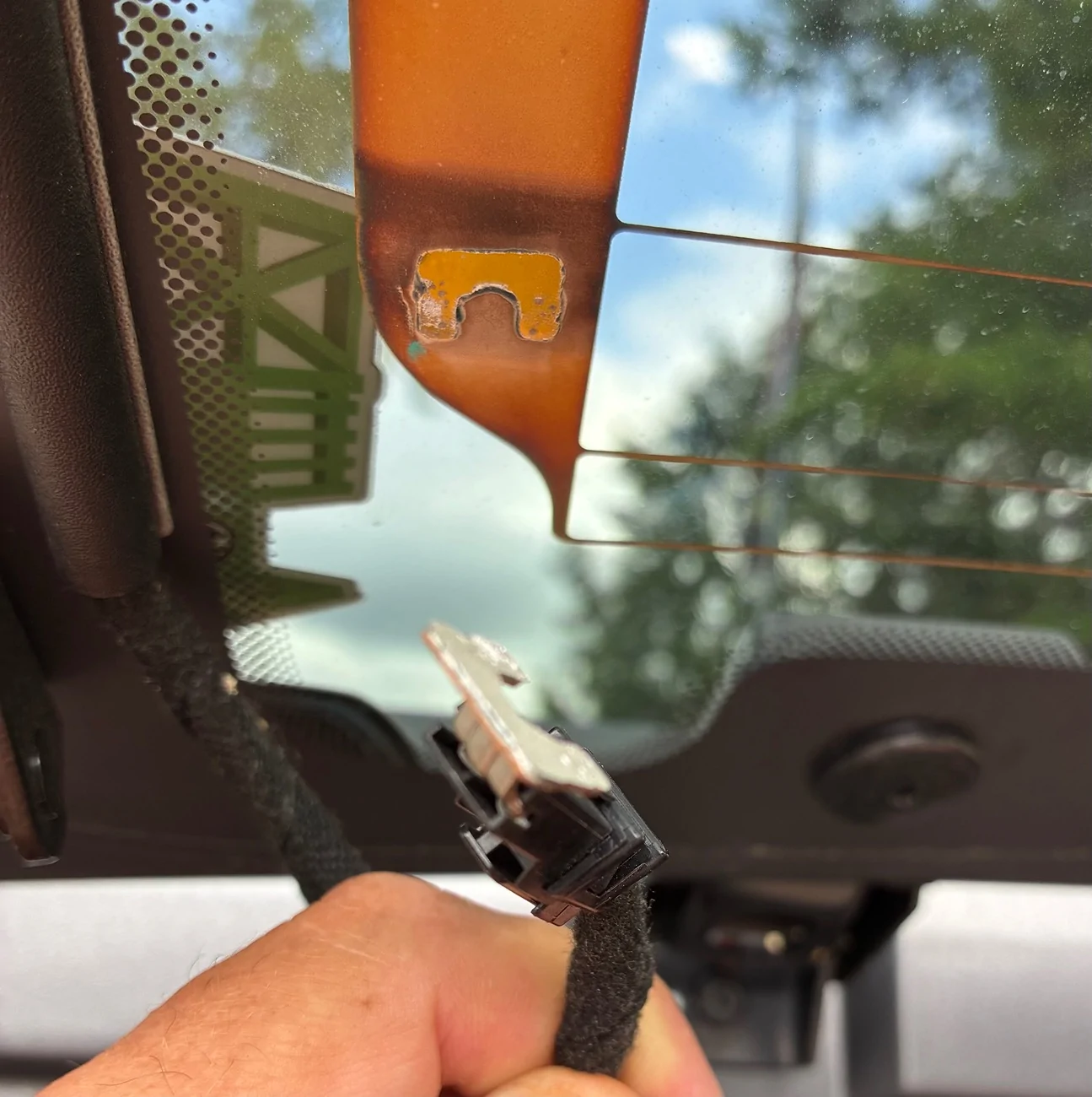

…however, don’t allow this to happen when disconnecting the rear defrost
I kept my mouth shut to not jinx you. It happened anyway, those break off so easy I figured this would happen when you tried to unplug it.
I may not reconnect it… since January of 2024, I haven’t used the defrost yet and I live in southeastern Wisconsin.
now, if I can disconnect the other without screwing up
