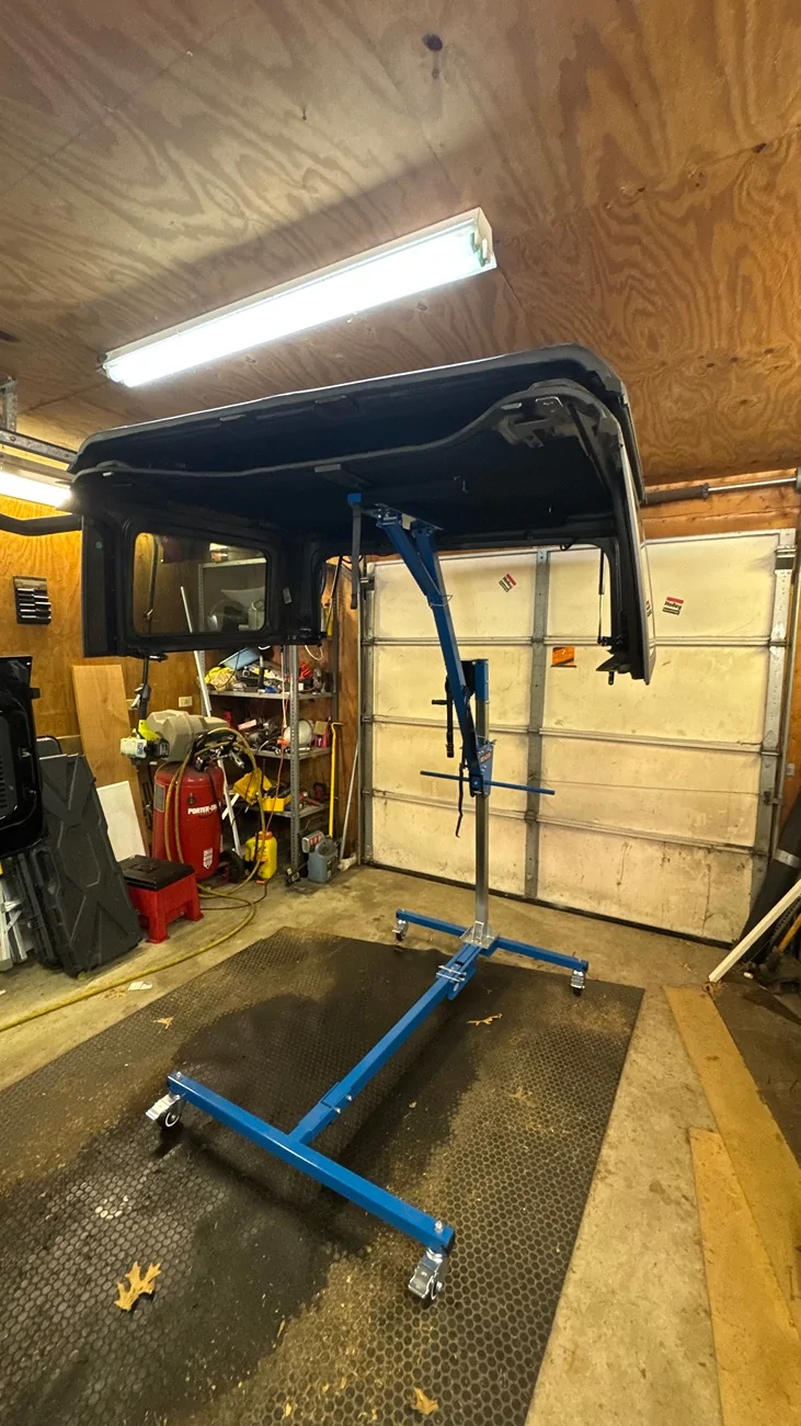

I'm not advertising BUT the lift (if you have room) is easier and cheaper than messing with the glass. And since it's a halfway decent weather between the IL/WI border I do suggest it. I was also worried about f'ing up the glass, so I bit the bullet got one.
Nice! How much? Link?
I was even thinking of making a custom rack for this in the garage with a hoist. Something with combined door storage would be great.

Let me get you a link, you're new and havent seen all the toys yet. this is a lift from EZ4x4. (not advertising just a fan)
https://www.ez4x4.com/collections/ford-bronco-4-door-accessories
this is a link to the Moar Door or 4door section. My next grab might be the door cart. take a look. most products have videos with them. So far the quality is materials is amazing.
Thanks! Might be less expensive than a shelf.
Definitely getting overwhelmed with all the cool accessories. Hopefully picking mine up Thursday.
Oh I forgot you were still in a holding pattern. Prepare to start liking things that you have never considered buying before.🤔 This thing folds up nicely as well, I had zero room for anything that takes up space.
Sorry for hijacking the thread @T800 is about to get his Bronco.

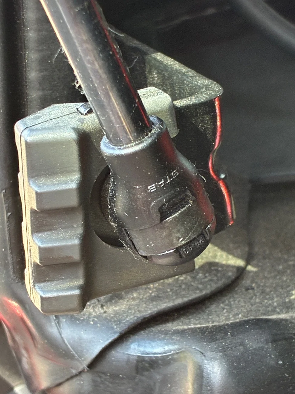

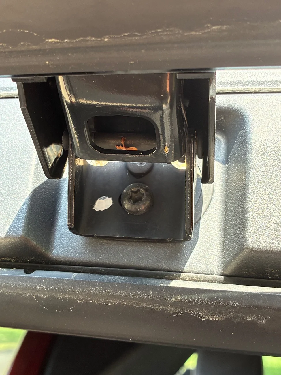

I've taken the glass out many times as I swap it back and forth with my custom half cab...its easier w 2 people, but only takes a few minutes.
You just remove the two T-30 star screws and the clips on the ball socket?

of course remove the two lines for the defrost and the single washer tube…
That easy?
