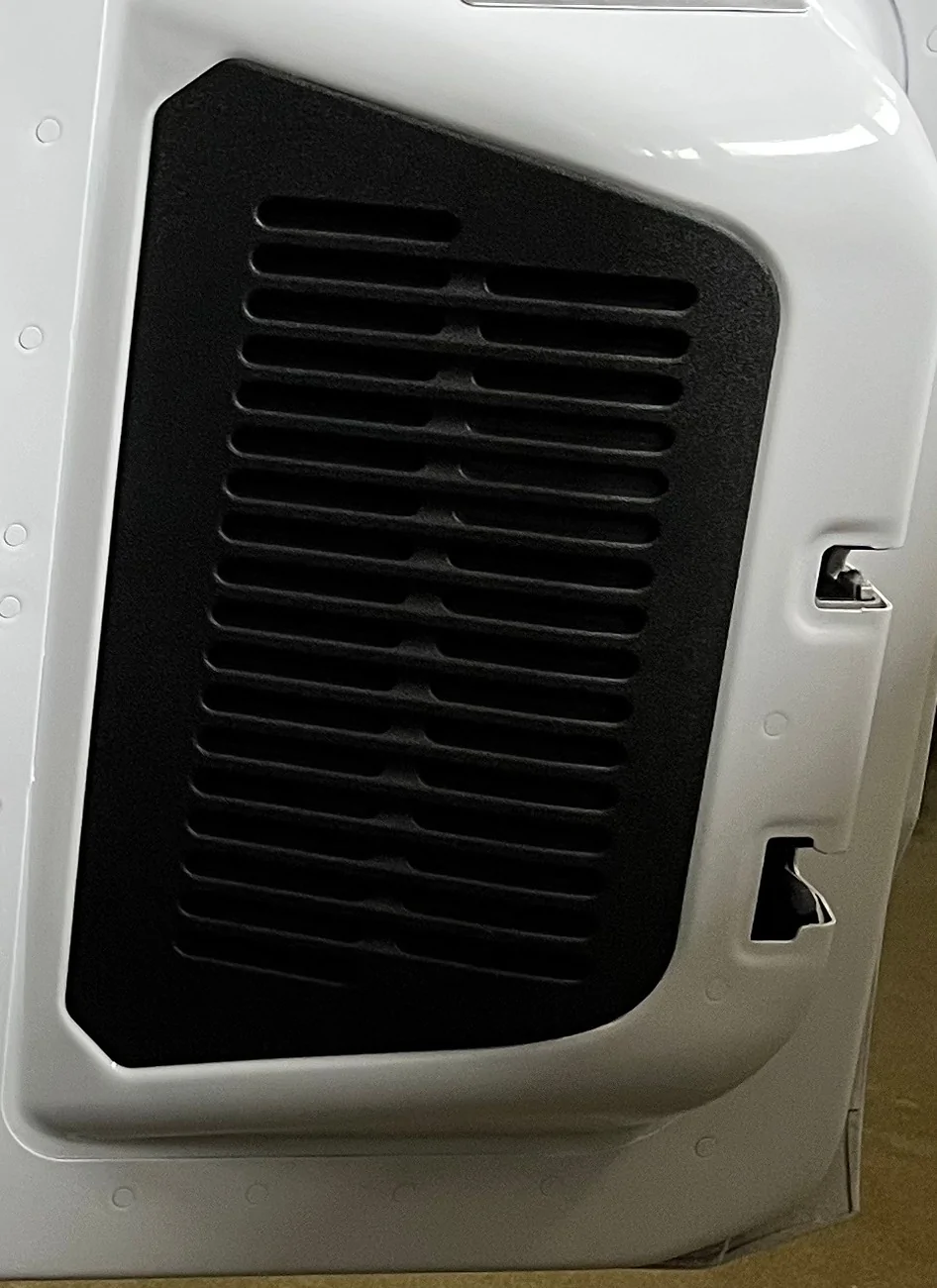

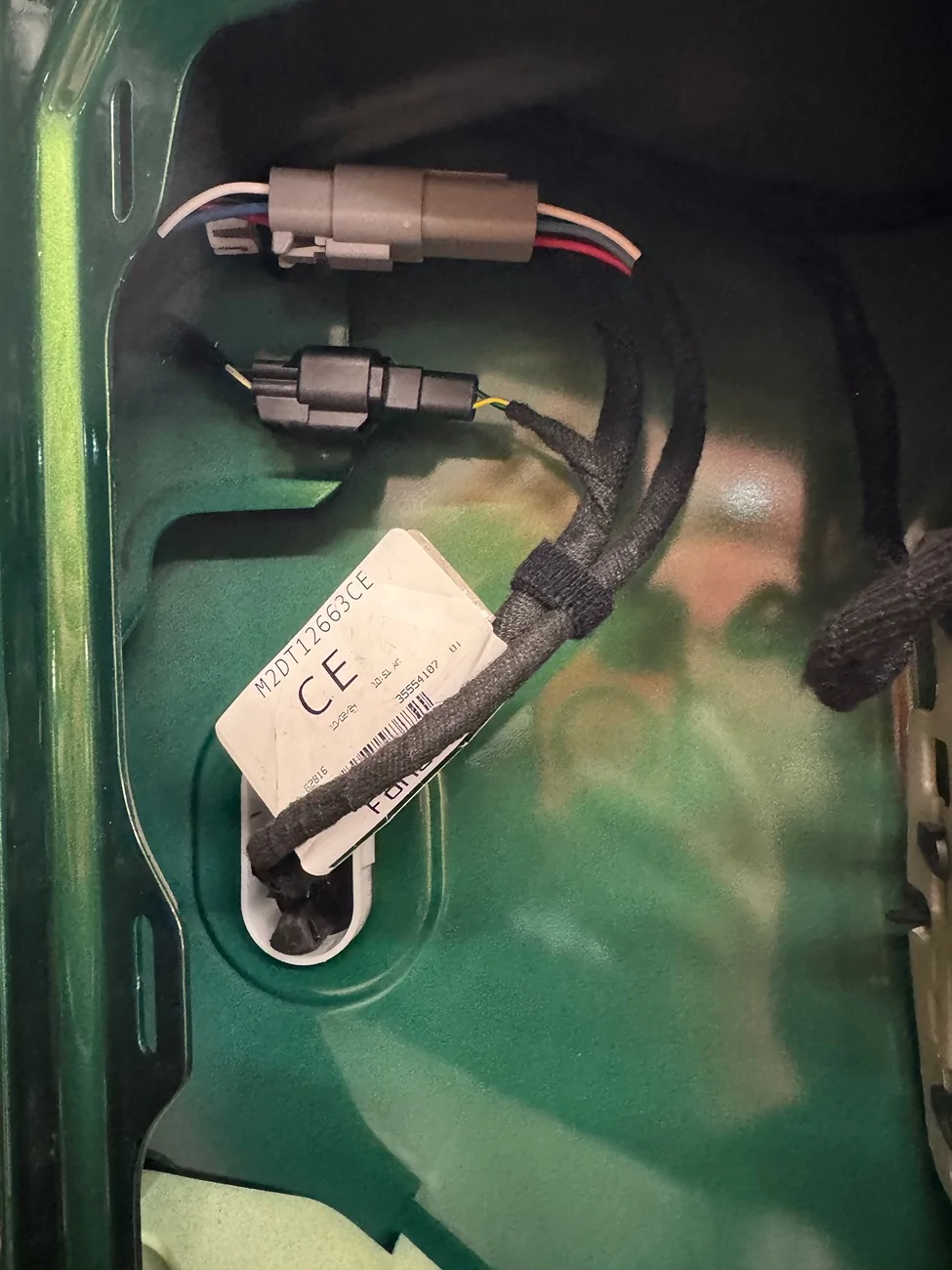

Is everything accessed from the spare tire side or did they have to go from the inside of the tailgate ? I have mine scheduled for camera and shock recalls on Monday but wondering if I should remove my tailgate table myself if it needs to be off .

Primarily from the exterior side. I asked @Ducati1098 the same question for the same reason, to avoid removing my tailgate table.
Edited to correct: there's some connections under the interior panel but nothing requiring table removal.

All from the exterior side. I asked @Ducati1098 the same question for the same reason.
Yeah they’ll need to go from the interior also, but just to go through the little vent area to unplug a connector. So a tailgate table shouldn’t matter for that.

This is where they have to disconnect the camera
