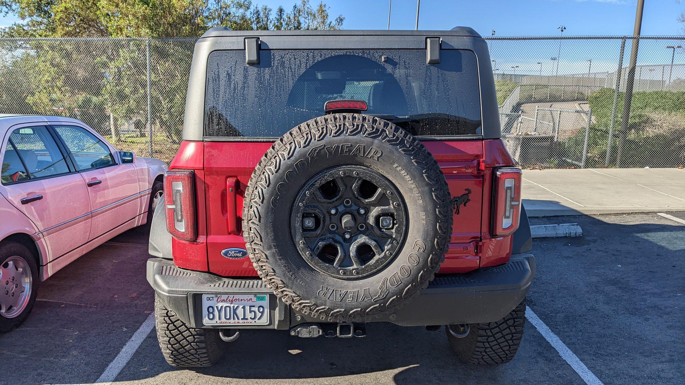

That's absolutely perfect, exactly what I was thinking. Thanks for the daylight photos!

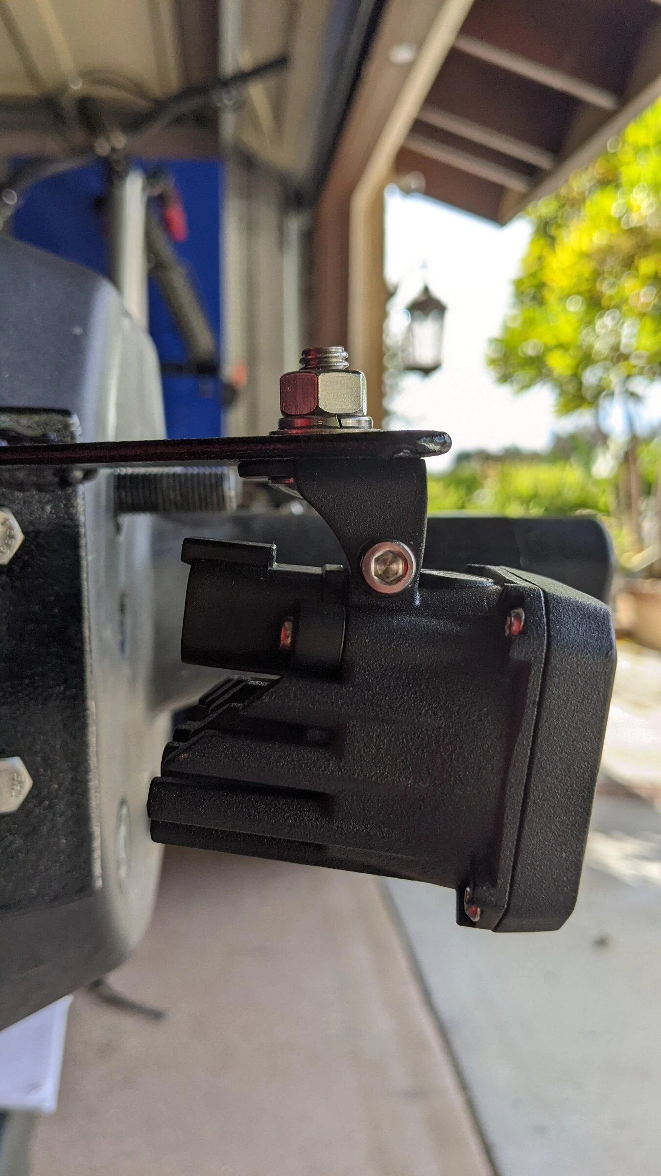

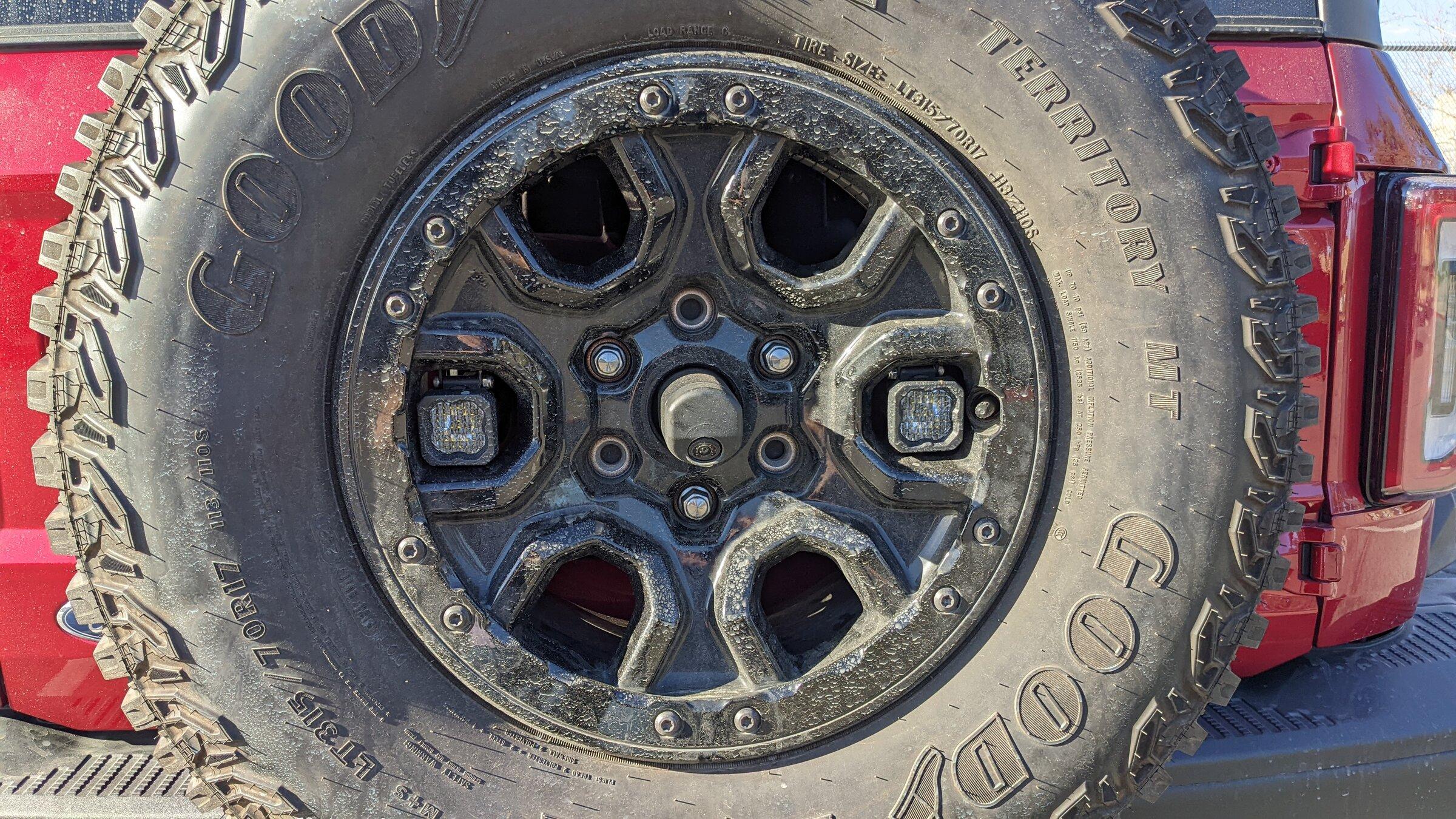

I've had a number of people ask if I'm making these and in all honesty I'm a backyard mechanic with limited skills - Lol. I do wish I had the tools to do this, but I'm fortunate enough to have a good friend with the skills tools and knowledge necessary to fab something up based on an initial concept. This was more of a one-off but I don't mind sharing what I did and walk thru the install best I can - note I didn't record or take pictures of the build or install but don't mind helping anyone out!
At this time I don't know of a fabricator but imagine it would be an easy item for them to make given that I think it's a simplistic design. I could ask around and see how many they would need to produce and how much it would cost if there's enough interest?
Material cost was quite low - it was more of the initial time of set up (mocking it out) and grinding but with the right jig and with the measurements known I don't think it wouldn't cost much (but then a piece of bent metal to hold lights cost more than I can think it should - Lol...)
For the time being I'm going to share some pictures and measurements to hopefully help someone out whom knows this world better than I...

One question regarding the use of this as a fog light - This may vary by state, but assuming the placement is illegal to be used as a fog light? Also, wouldn't they be a lot less effective being so high up? Fog lights are typically low to the ground.
Not crapping on your idea by any stretch - I still am looking at doing this, as it's perfect for extra light while backing up or if you need some area lighting. But I don't think I'll add them as a rear fog light option. Just my 2 cents. Curious if you've tried them in fog?

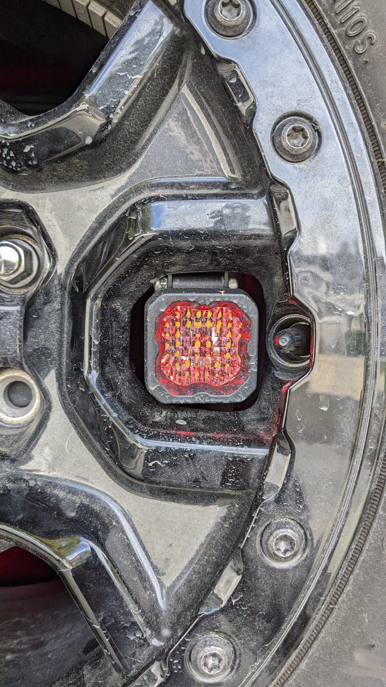

A very valid point and no criticism considered.
I actually did a very quick look as your comment on being low is valid, although it appears to apply more to front driving lights. For the rear they need to be min height off the ground (didn't see a max but could depend on country) and provides a means for other motorist to see you easily. So I believe this fits into that category. Original placement appeared to be on the left side of the vehicle with higher end vehicles having them on both. They are now also being placed in the center - which is where the factory Ford Bronco is located.
Regarding being able to be seen better in fog from the rear I can't comment yet - we haven't had any since installed. I do believe they will help but will also say for true rear fog the light output should be brighter.
I'm using Diode Dynamics SSC1 lights with red backlighting. The light output is a smidgen brighter than the rear running lights, not as bright as brake lights. Most rear fogs I've seen are closer to the brake light output so these would definitely need more lumens to get there. Since Diode Dynamics came with a backlight I didn't want that to go to waste - primary use though is for the work light - I thought why not use the backlight for a purpose. Now if Diode made a brighter backlight then I believe it would act as a rear fog light and placement would allow other vehicles to see me from the rear quite easily. I do need to test your question in real world thought and see how much further if any these lights add.
