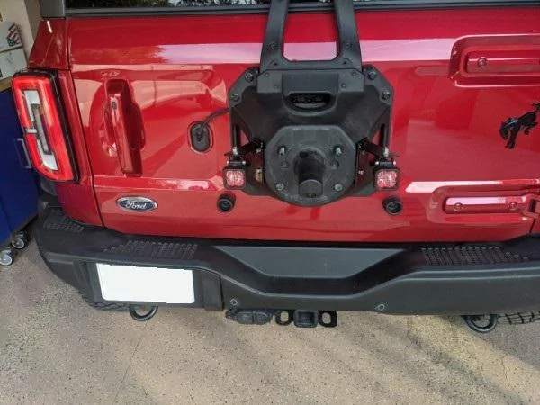

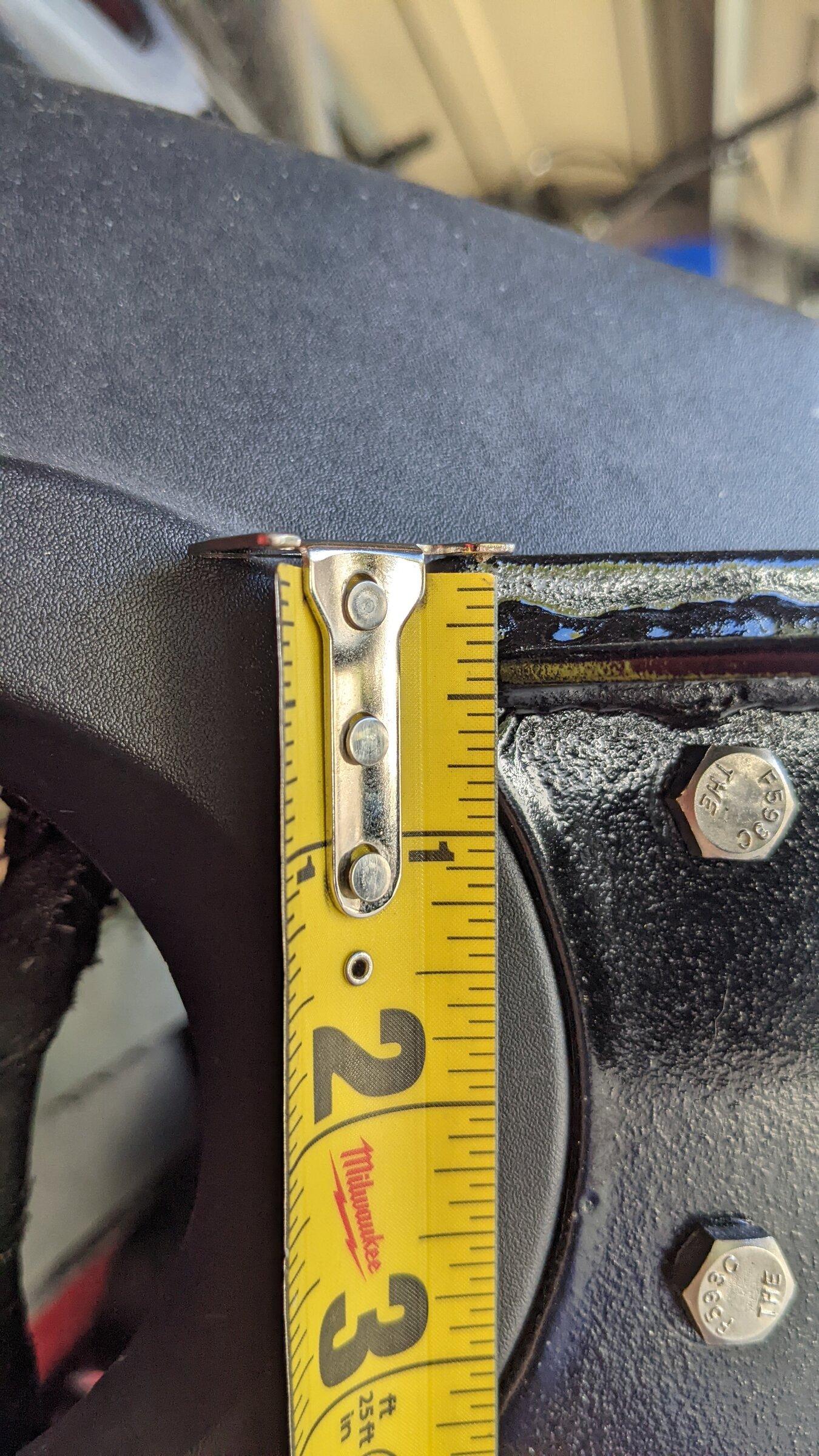

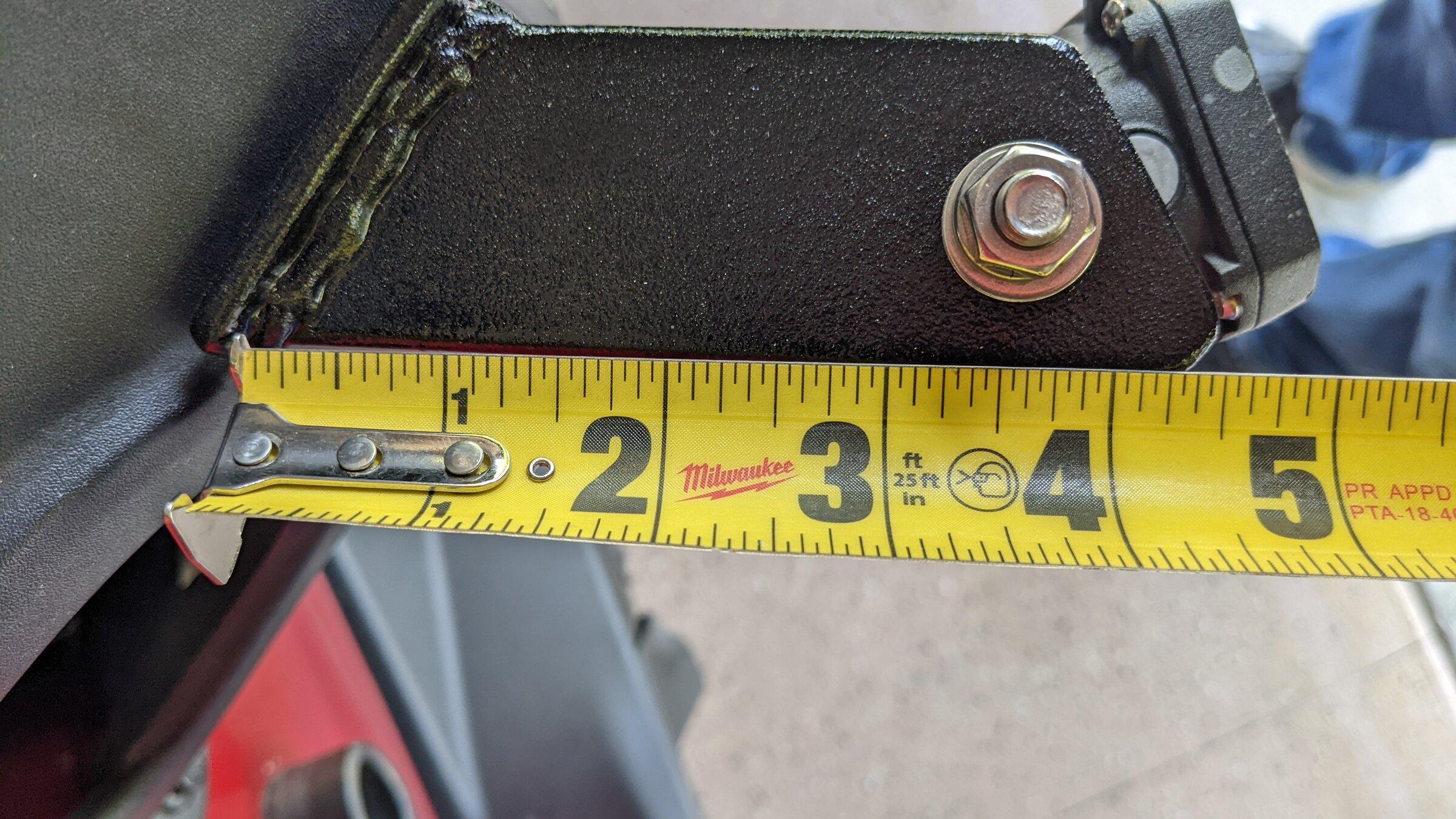

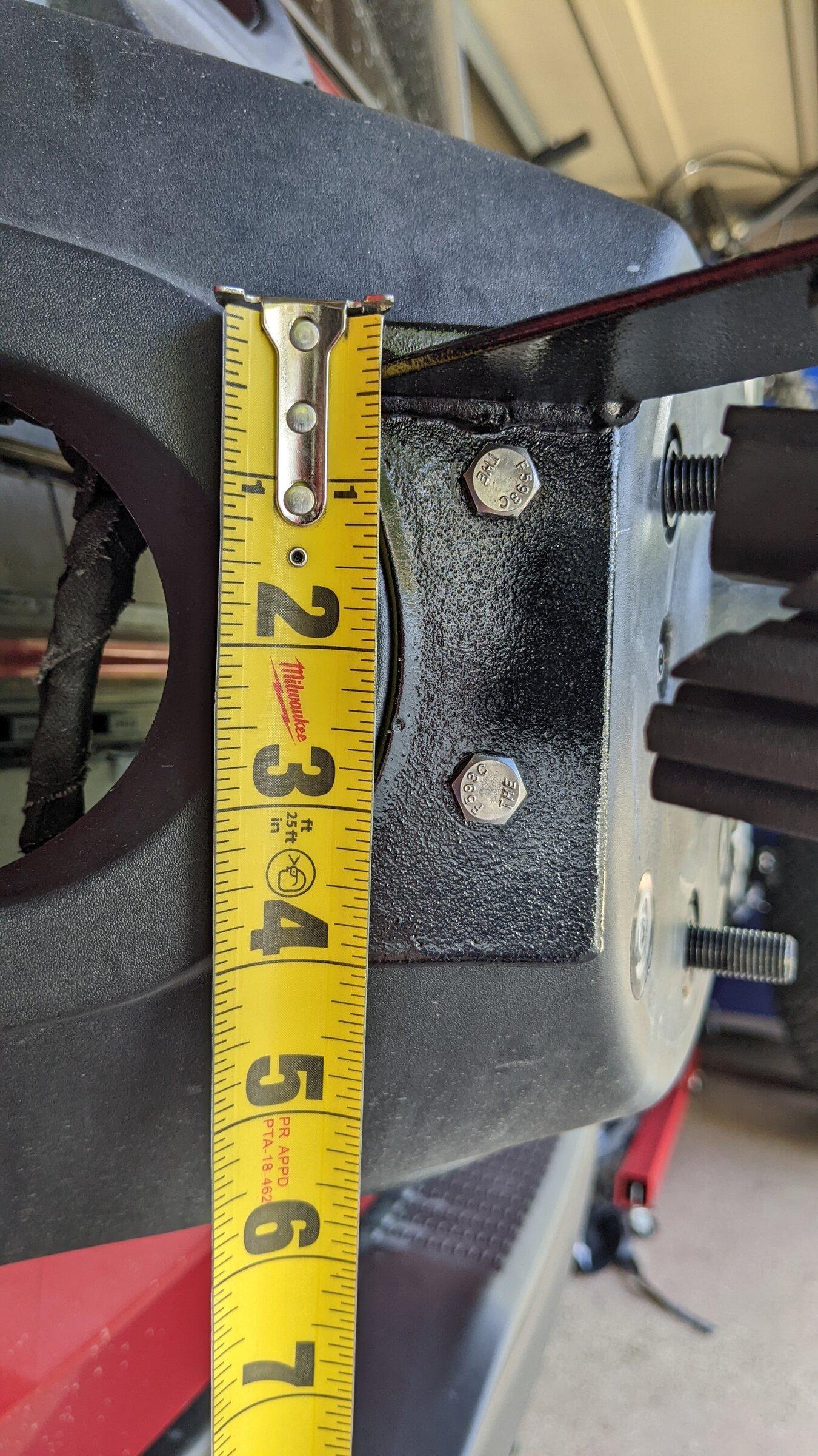

Bronco fans,

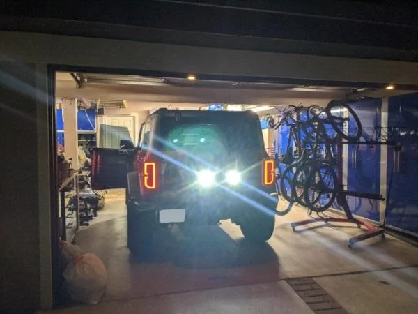

I wanted to share a project that a good buddy of mine and I worked on which turned out better than expected!

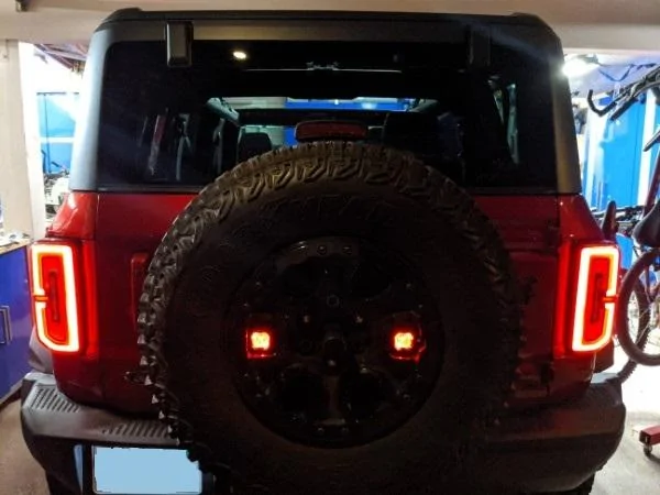

I love camping and many times arrive to the site later in the evening (have to fight traffic to make it there on Friday), so it's important to have good lighting when setting up camp. In addition - since Bronco's have the ability to have rear fog lights, I thought it would be a good idea to incorporate this feature into the work lights.

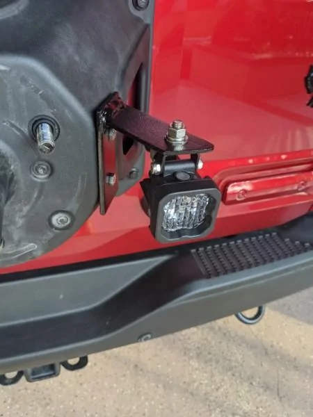

I looked at a few different solutions that use the spare tire studs to mount rear lighting, but those plates stick out past the tire (and I need all the space I can get to fit in the garage with all the other stuff in there), so I had an idea - lets mount them onto the spare tire holder and have the lights stick out thru the spokes of the sasquatch wheels.
After a little trial and error we had success. This is my first fab - likely over built but were driving a bronco so why not!
Pictures to help show it off/explain it.

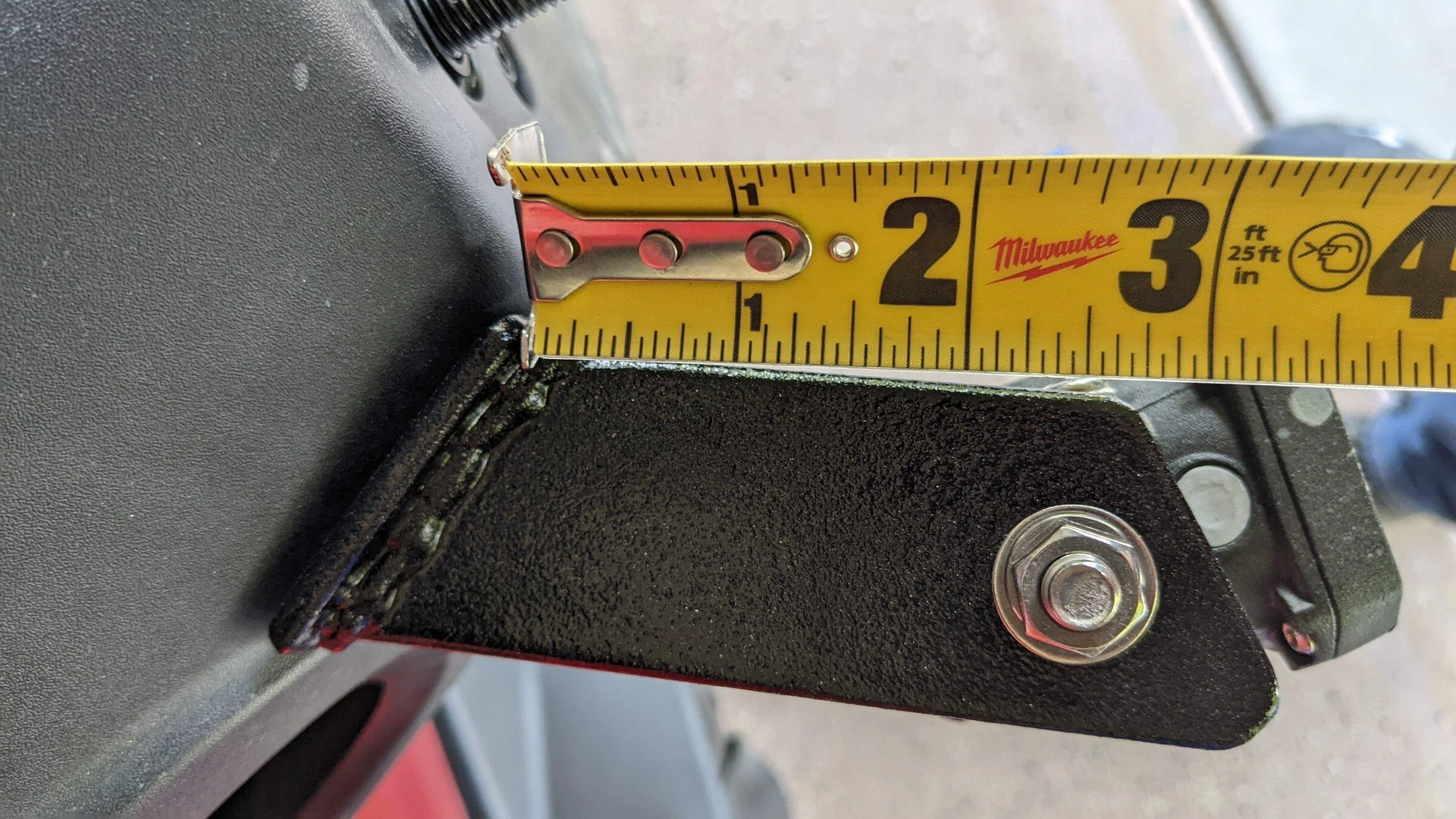

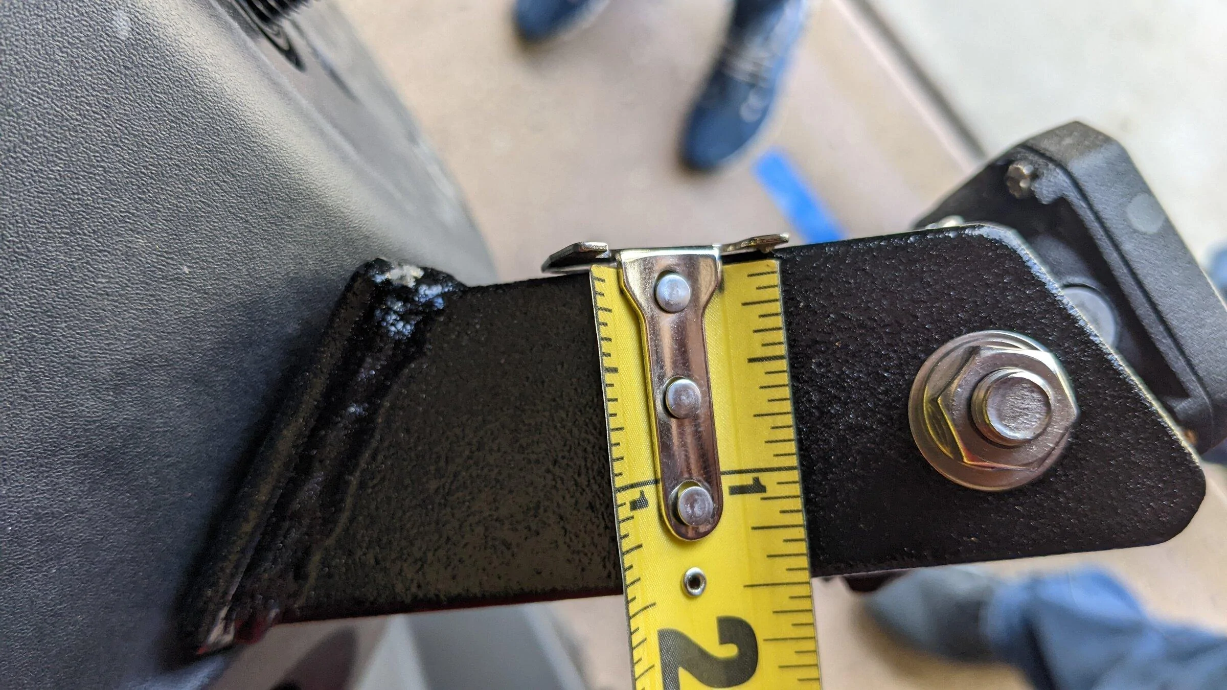

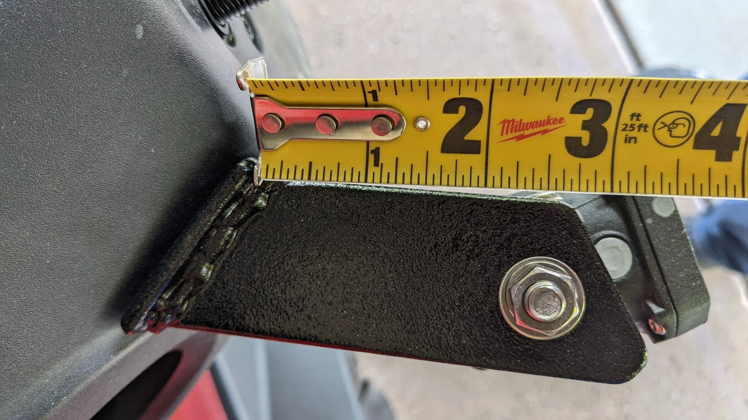

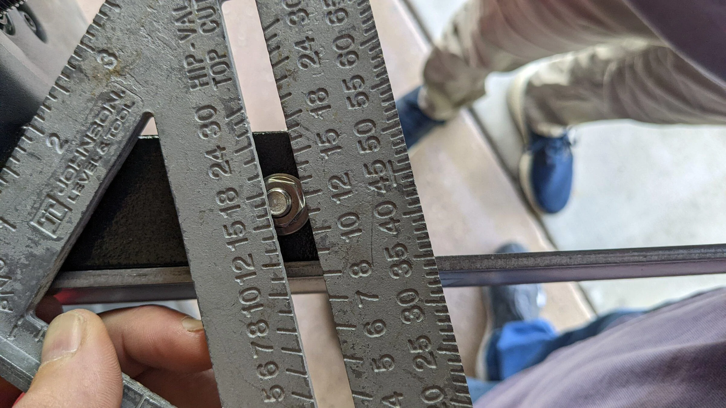

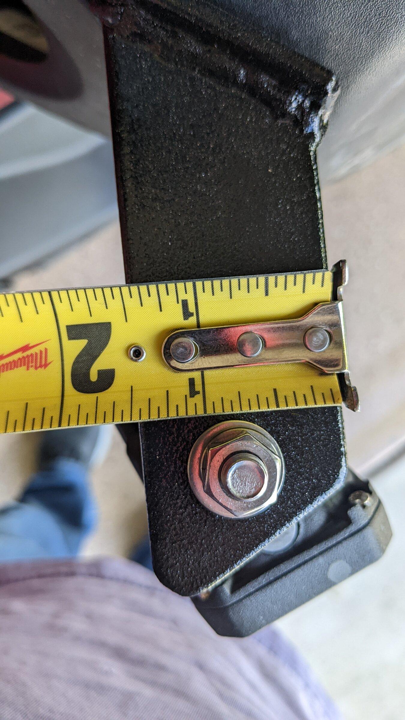

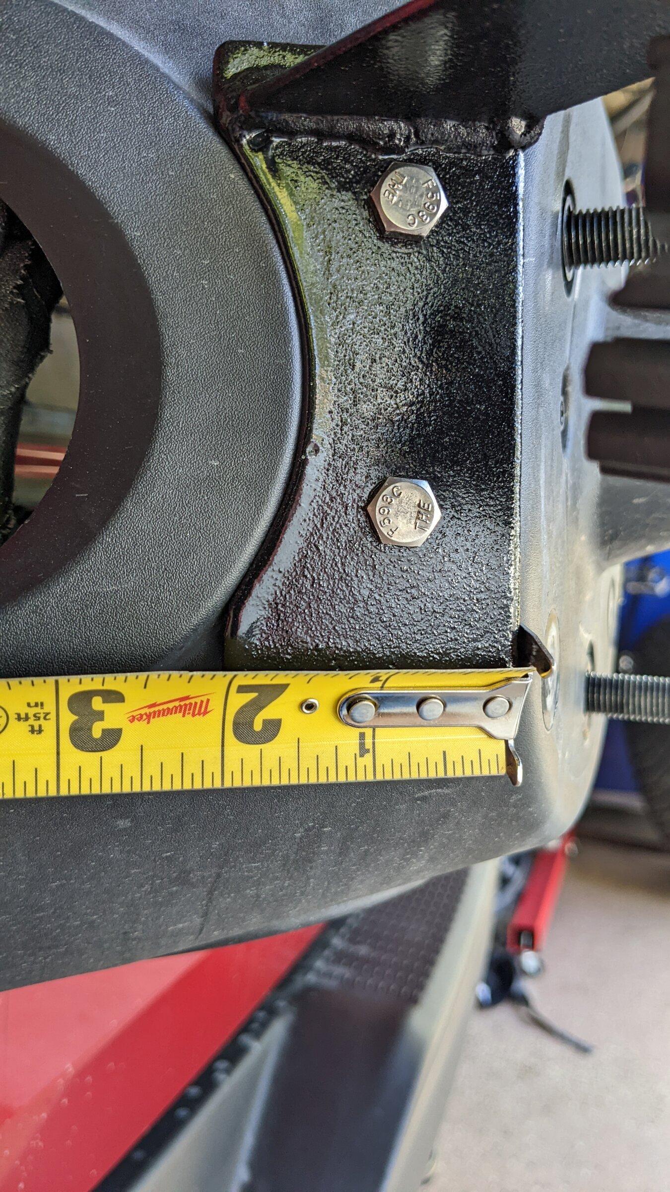

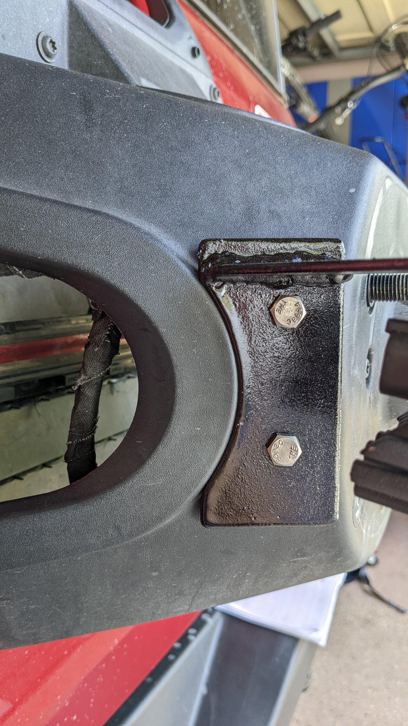

Bracket made with 1/4 Steel (2" wide for main support, top support made with 1 1/2")
Lights - Diode Dynamics SSC1 Pro with Red backlight. These suckers are bright
Wiring run thru grommet where rear stop light and camera comes thru. Unwrapped tape from factory and fed new lines thru.
I have it connected to an upfitter switch. If you want you can get fancy you can have it work with reverse, a switch or a combination of the two. - upfitter connection allowing multi-use of lights.
Note that the rear tire mount appears to made from plastic. It's actually more stout than you think. It has an aluminum core in-between the shell.
Let me know what you think!
I like it! Nice idea and the brackets look solid. Spare comes off, no issues... Open tailgate, unload an setup camp. All works...👍👍
