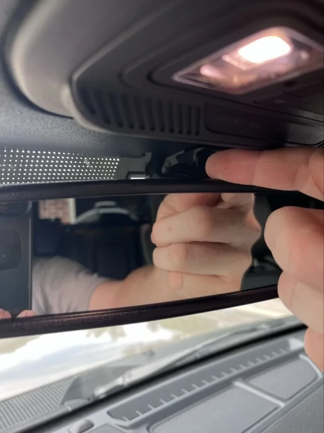

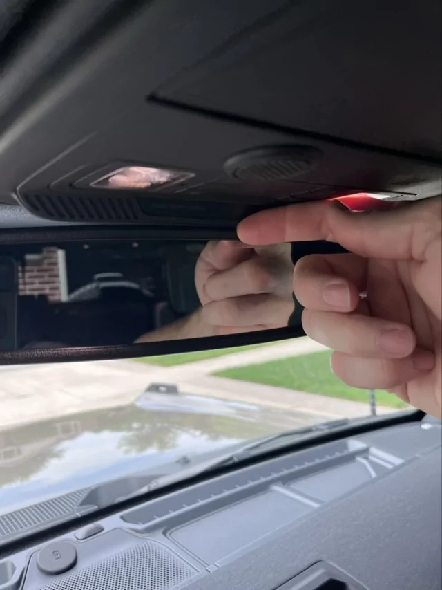

As a follow up to my previous thread HERE I was looking for a way to raise the rear view mirror as much as possible.
Well I found one, it's cheap and easy. Just how I like my...

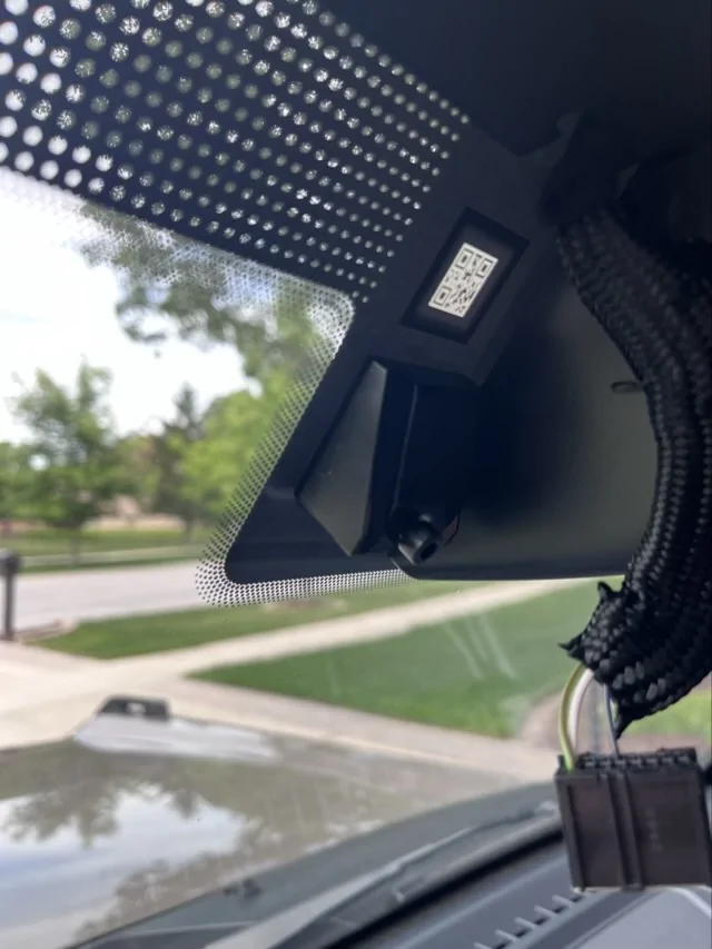

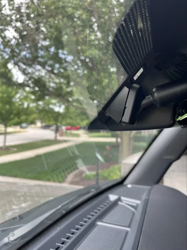

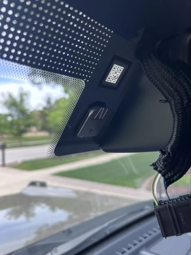

This Billet Alum Rear View Mirror Riser is for marketed for a Toyota Yaris but some digging said folks have use it on Fords, so I gave it a shot an it works perfectly. Just remove the mirror with a torx bit, add the wedge and snug it down (Allen key), reinstall the mirror and adjust to your liking. It will hit the overhead console before you run out of upward adjustment.
Before, one finger gap:

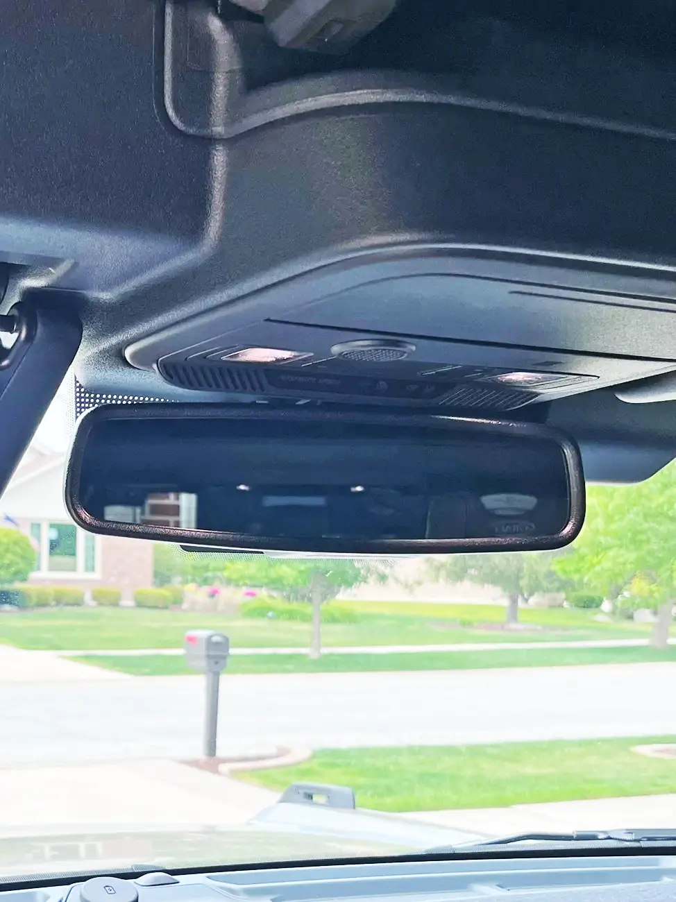

No gap.
Ford Bronco Raise Rear View Mirror - SOLUTION: Mirror Riser IMG_6003
This is my perspective, at 6'6". I can just hardly start to see the mirco dots on the glass under the mirror, perfect. Gained about 0.5-0.75" field of vision under the mirror.
