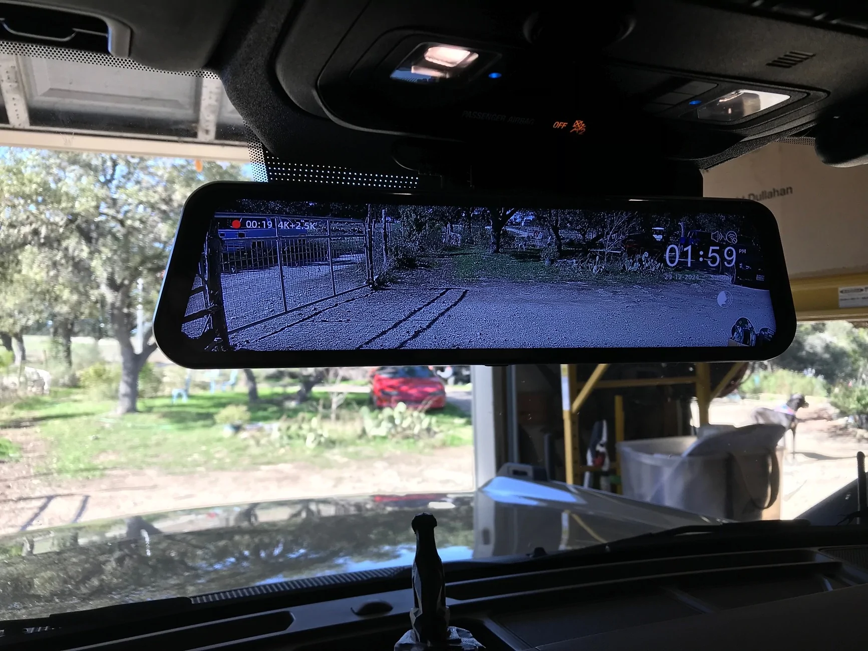

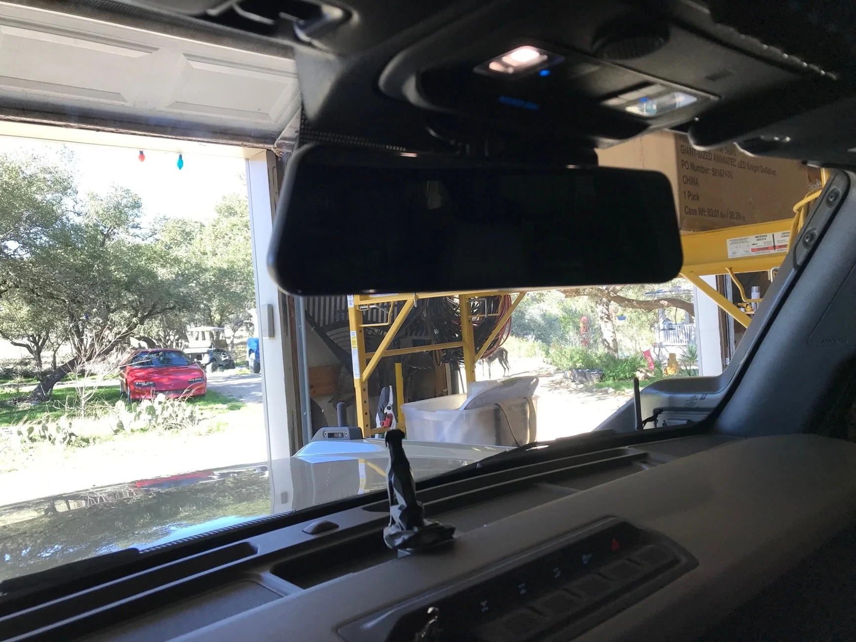

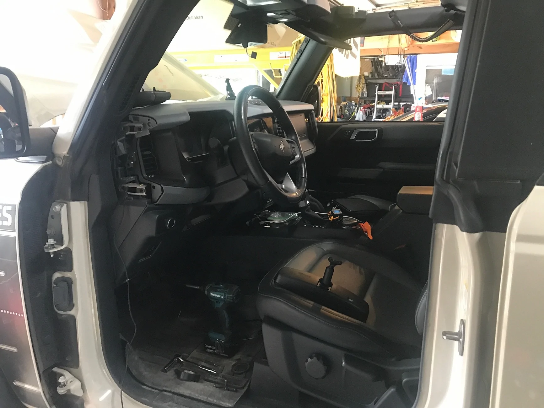

I installed the Wolfbox G900 Pro but I ran the rear camera to the front to use as a trail camera. you will not lose anything but auto dimming. I use mine as a regular mirror most of the time so it is basically a dimmed mirror. it is as reflective as a cell phone screen turned off. but the cameras are great. I removed the drivers door to make routing the wires easier. FYI the screen is much nicer in person this was a low res upload.
