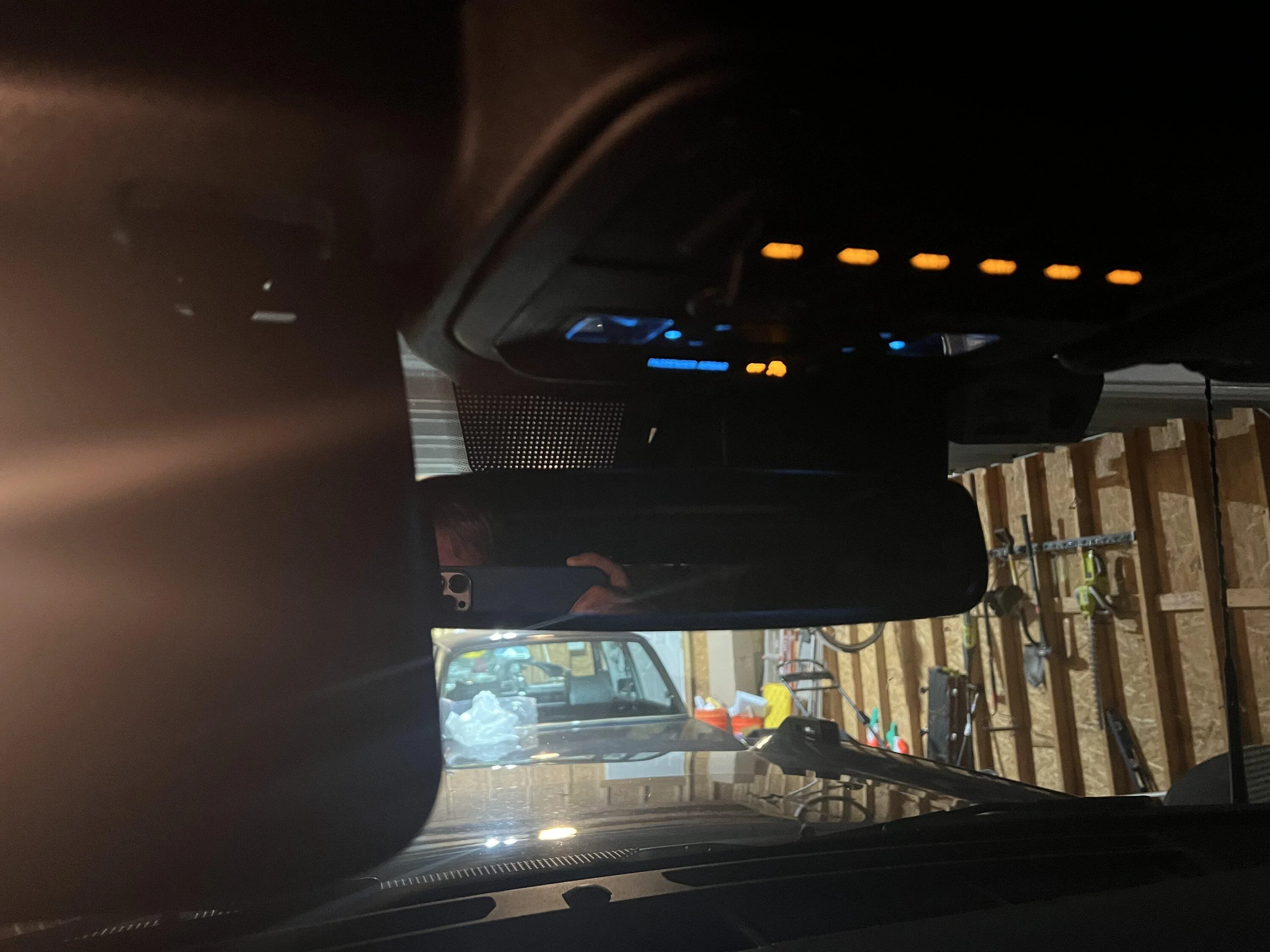

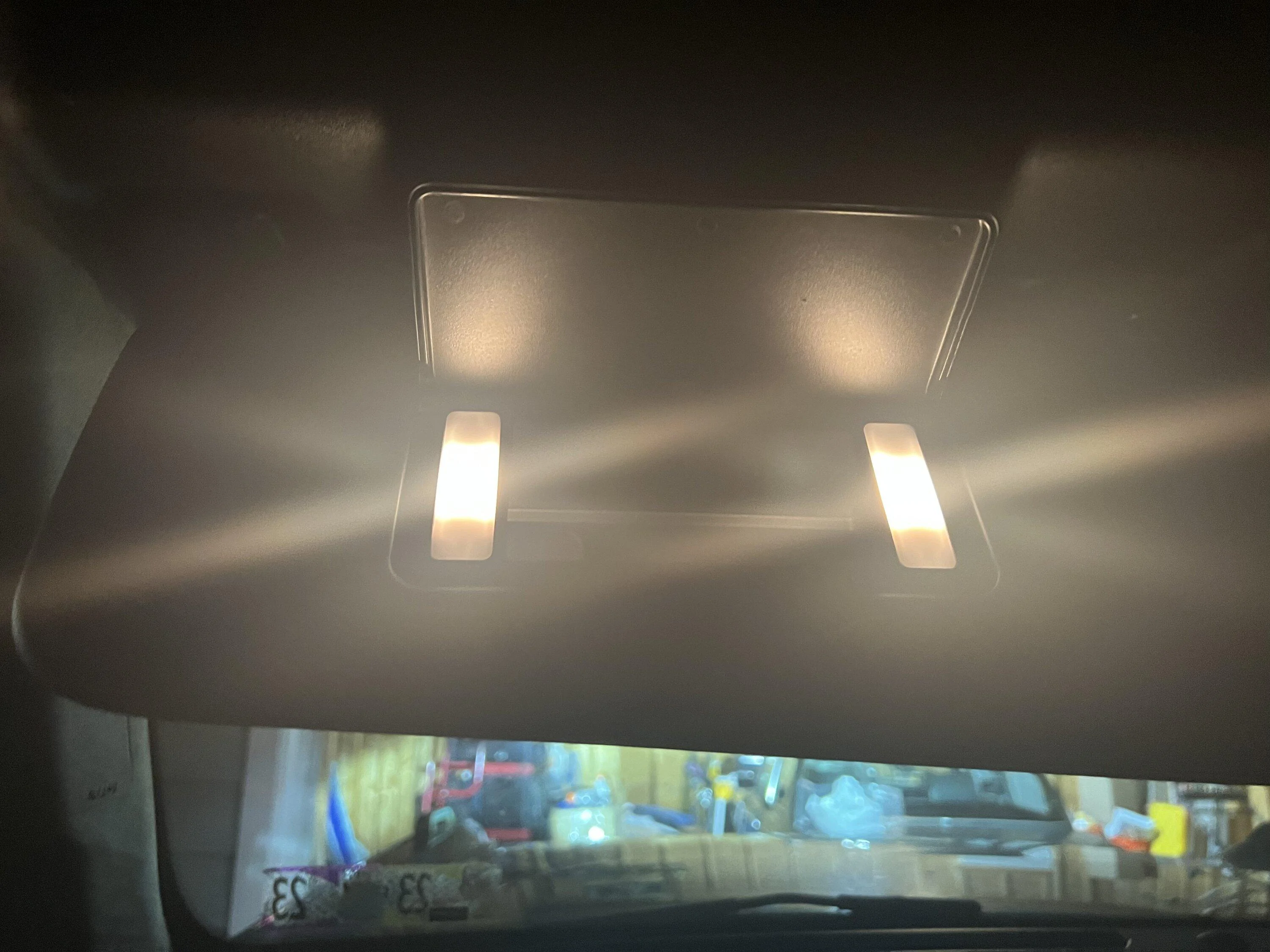

So, I’ve figured it out, though you may not like the route I took. I have a 2022 Big Bend that did not come with the Aux switches, auto dimming mirror, lighted sun visors, etc. I ended up doing the Aux upfitter switch install found here, along with ordering the lighted visors and auto dimming mirror, plus a trim piece I broke in the process.
The harness you need to buy for the aux switches includes the connections for the auto dimming mirror et al. Once that’s in, it’s a T something to loosen the mirror, and off it slides. The auto dimming mirror will slide right on and clip to the new connection in the harness. This will cost you ~$1k to go the OEM route with all the crap I bought, but it works (though I haven’t actually tested it with high beams yet…)
