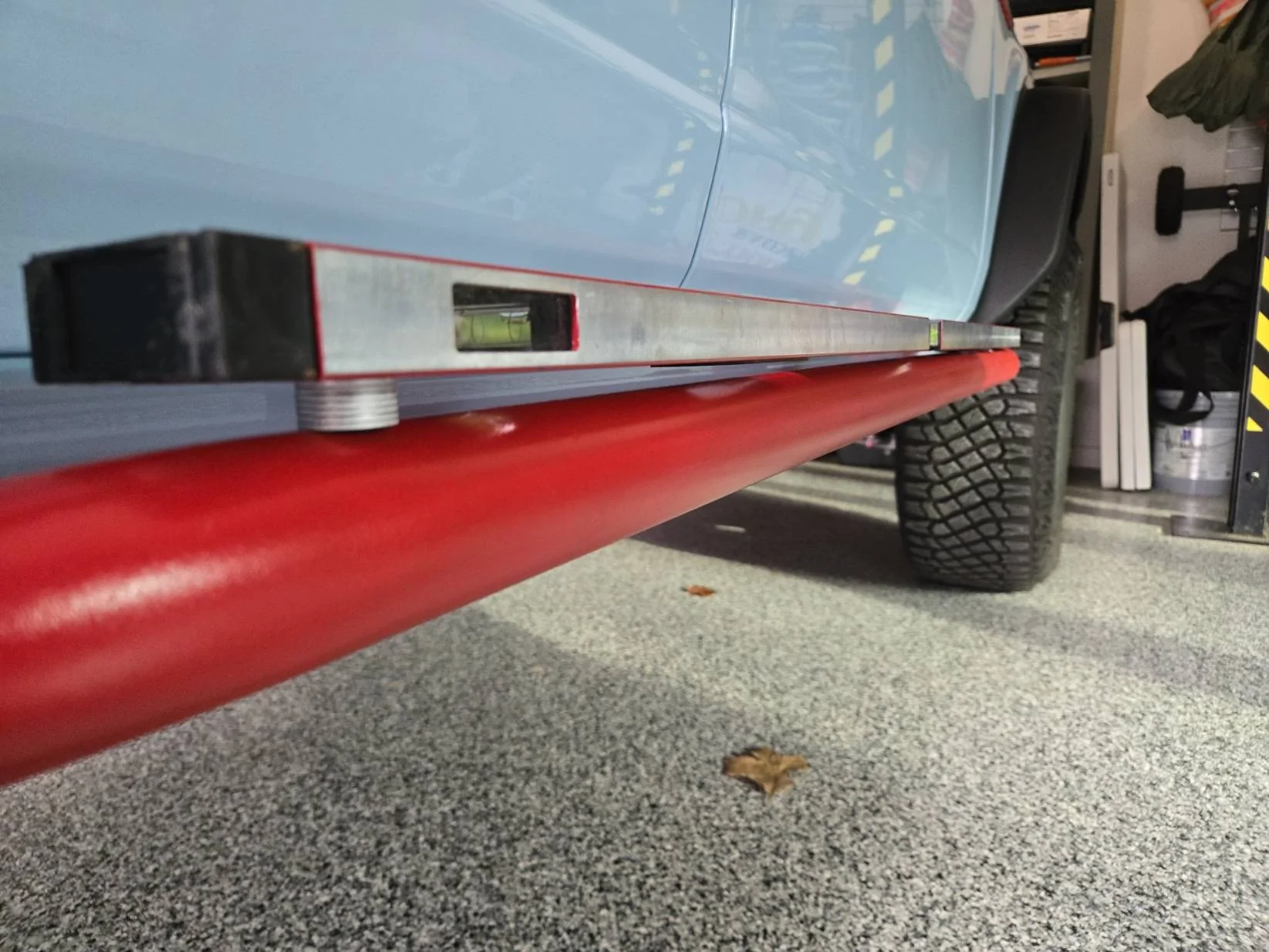

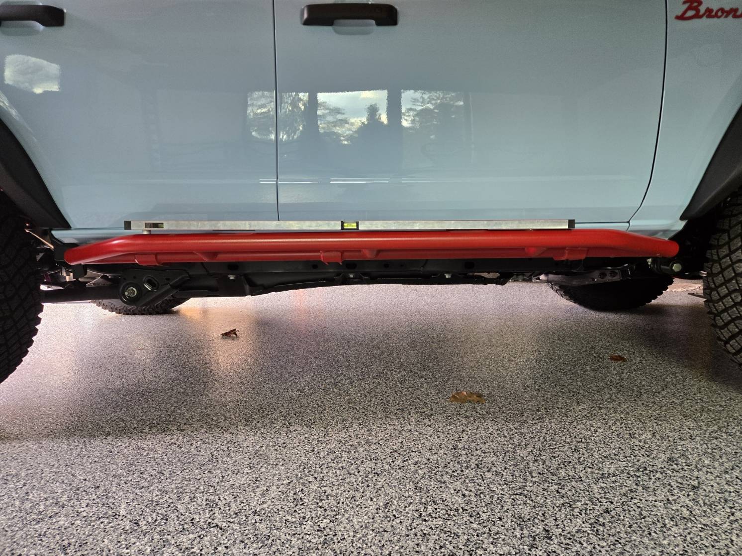

1st, The pictures you sent are from a garage floor which are typically slopped 1% - 2% for drainage, so a level on a rock slider isn't a reliable form of measurement.

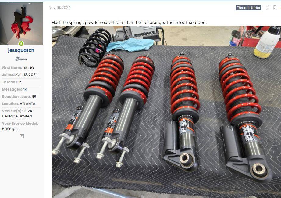

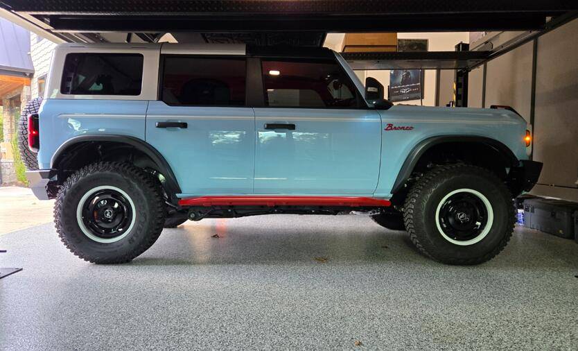

2nd, The measurements you sent us do not match the measurements you posted up on the "Fox + Eibach - Springs powder coated Fox orange" AND you never sent pictures of these measurements like we asked, just pictures of the actual vehicle which honestly to me look great (see below)
And lastly, you failed to mention these springs were stripped and re powder coated which voids our warranty anyway and could be the cause of your issues. If they stripped them with chemicals or fire you can affect the molecule structure of the metal and cause deformation and or weaking, which could result in loss of height. Regardless it's in our warranty that altering our products in anyway voids our warranty.

I just received my new Eibach 2.0 coilovers. Got them for $1,538 on the Black Friday deal. One of the main reasons I purchased from y'all is due to all of the positive reviews from around the web and here on B6G. This thread is the first negative I have heard. Powdercoating is baked on in an oven.... And just from this picture, I do not see any rear sag, actually looks pretty damn level.

Kind of surprised they said they would help after you powder coated it. Most companies would say good luck to you.
that being said, they looked good powder coated
Thanks for the education. Well, this leads me to wonder if this is the reason why new springs & coilovers need settling time. The internal friction heat when the spring is working will change its microstructure.

By the way, this is what I sent them. You can clearly see the sag.
Am I the only one who noticed that the Spirit Level is on its side? That is not how you use a level :)
