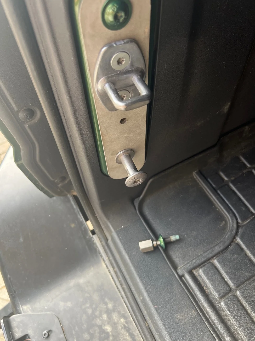

Welp. I figured you guys were all just bad at using hand tools and this would be a breeze. Had only the middle painted bolt left to loosen and rounded out the head on the first push of the ratchet… it seemed like the paint prevented the bit from seating properly though the top one worked no problem. Had to use the drill and smash a bolt extractor into it… then still a lot of pressure required to turn it. Whoever put those on must’ve had a perfect storm of improperly calibrated tools, loctite, temp variations and galvanic corrosion for it to be so challenging.
not sure the official part number but it’s an M8 dog end. I’ll be replacing that one, right after I have a slice of humble pie.

For everyone having issues, heat is the answer. I destroyed a crappy T40 bit before I broke out the heat gun. Once I applied heat for 2-3 minutes, they broke free easily.
Also, I am not sure how any of you are getting it off with a TP30. That was way too small for my bolts and had significant play. I used a regular T40 bit and had to rubber mallet it into the bolts to get it to fit, I'm guessing because of the paint. Once it was heated up they broke free. I'm guessing some high temp loctite was used.
