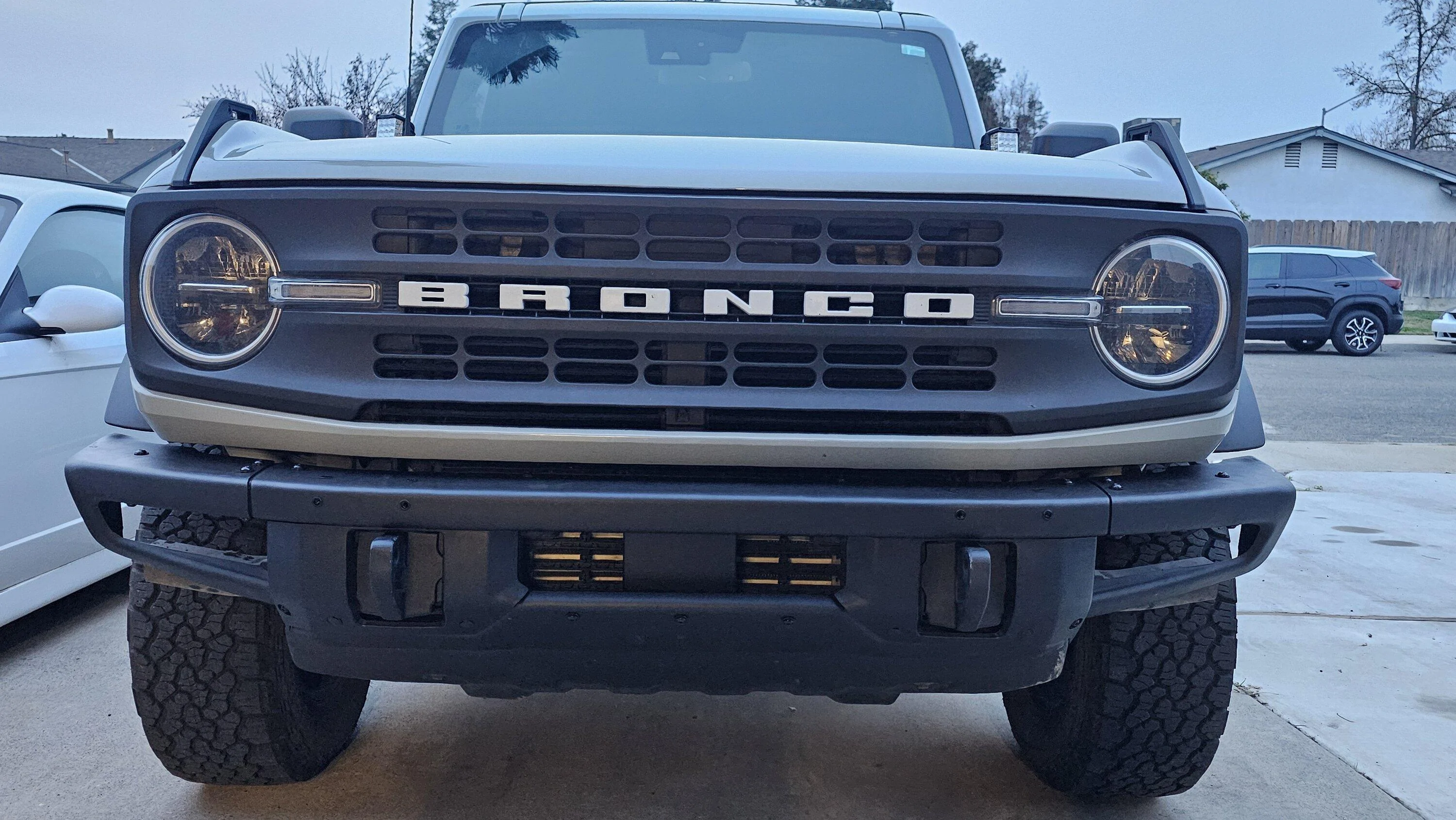

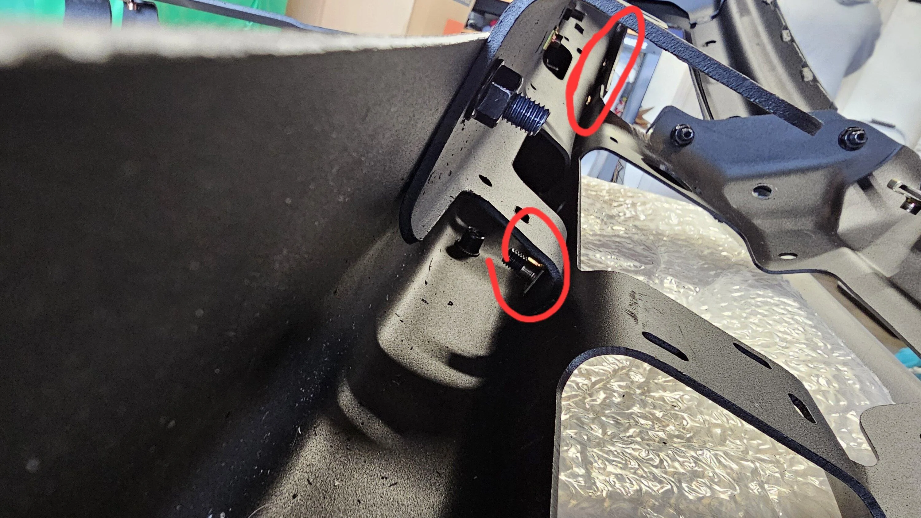

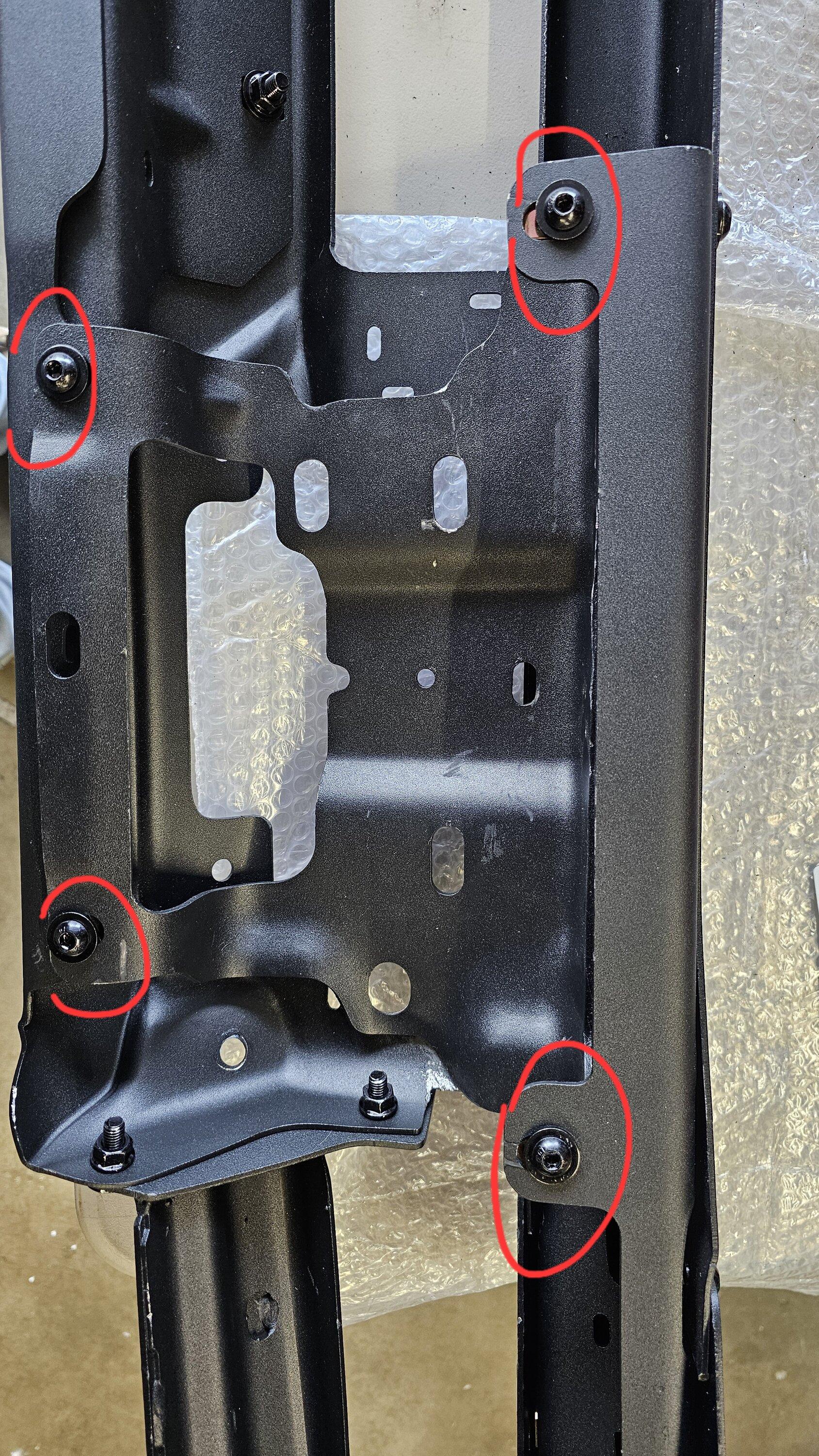

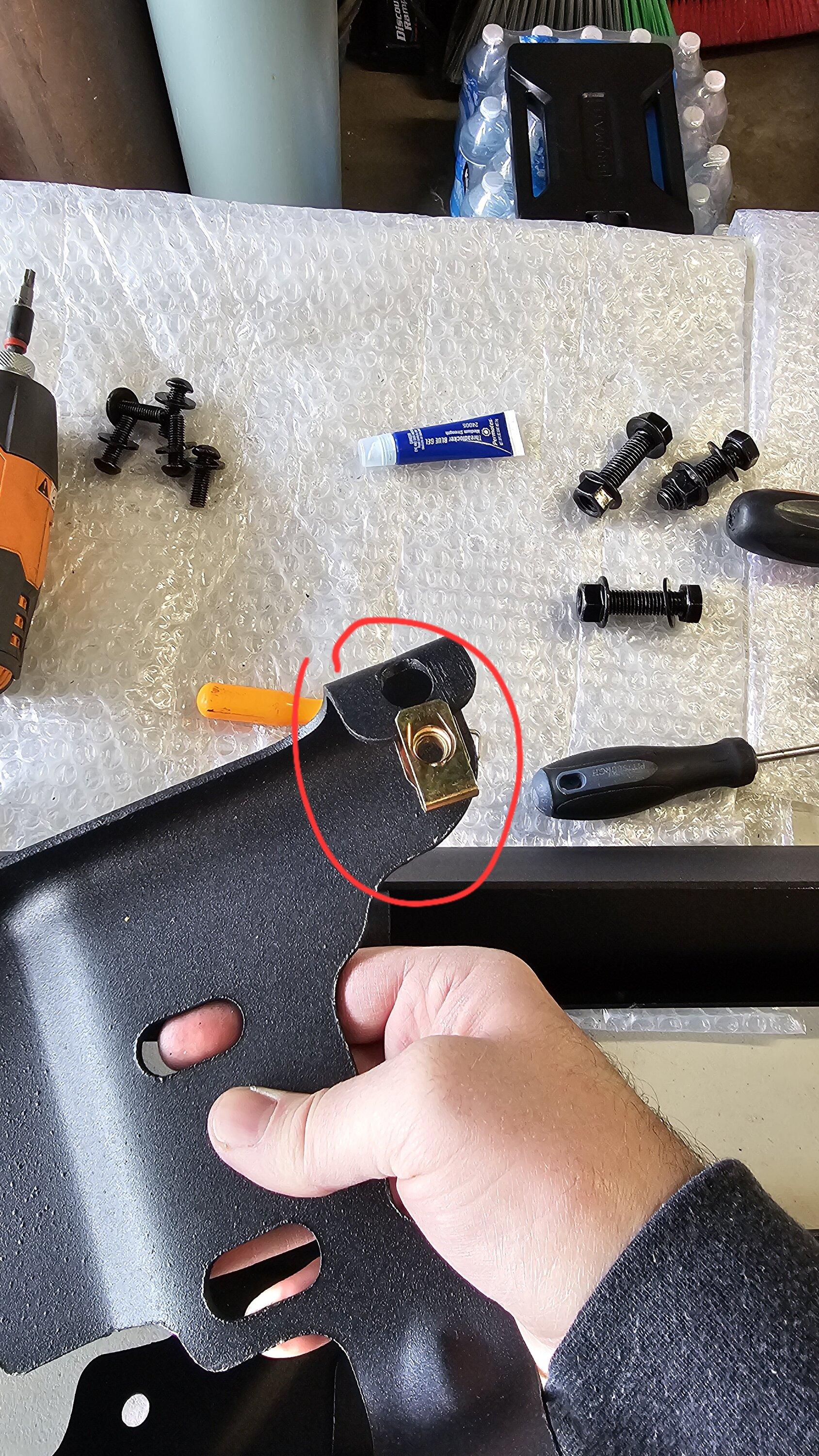

Well it's on... I don't totally love the bumper. Save yourself some headache and get the speed nut clips from Ace or AutoZone. The supplied one are weak.
Those speed nut clips go on the inner brackets that support the ends and brackets that the big anchors sandwich.
When mounting the clone to the truck, I needed to use three washers on the bottom mount to level it out.

It's fairly straightforward, I thought I took a picture of all the locations that needed the speed clips and what uses bolt/nut.
You did, sorry, I don’t think I realized this was how the factory assembled it; thank you!
