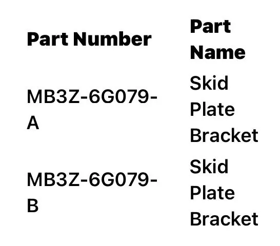

I just got my Amazonian one today, it shipped crazy fast (I just ordered it Monday I think) but it shipped with 2 left-handed mounting brackets. Contacting seller to see if they can get me the correct bracket before I just return it.
Had similar unboxing to @Jb7 - mostly intact, a bit of the paint marred here and there - nothing major bend up - apart from the incorrect mounting bracket that it shipped with.
Brian_B
Sep 14, 2023
65
8,870
15,816
Central CA
So after some back and forth with the seller - I don't think they have a lot of latitude to fix things - they are just importing these things boxed up by the shipping container, and flipping them on Amazon.
At first, the seller countered asking if I would take $80 and keep the bumper. So I called my dealer. The part for me that was missing, my dealer wanted $130 to replace, so that's what I countered with, and the seller accepted and credited me back $130. Now to see where I can find that mounting bracket cheaper elsewhere online.
I really can't complain about the seller - they did what they could to make it right.
