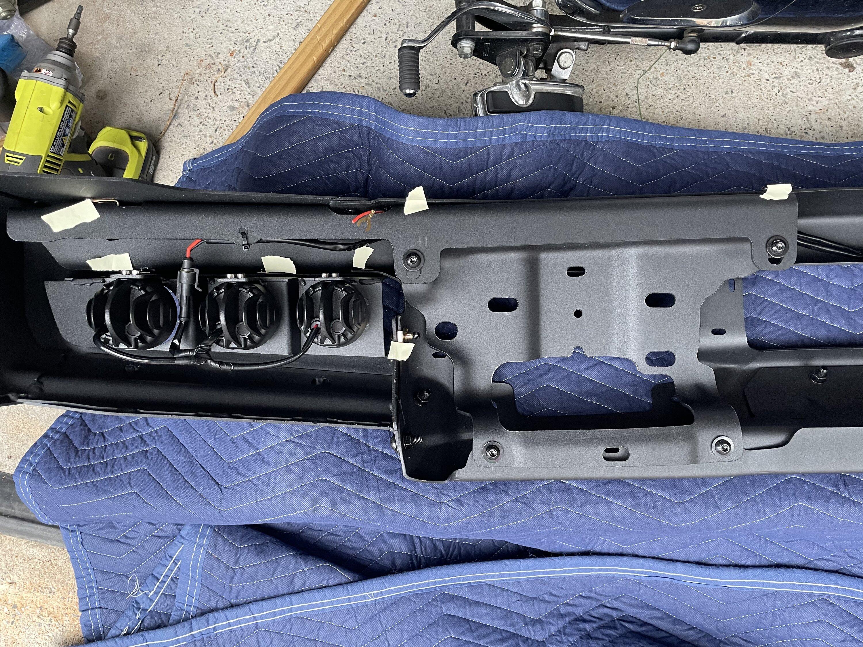

either mine came with way too many bolts, or I have no idea what I'm doing.
any chance you have a picture of where you used a nut clip vs an actual nut? I'm also confused why I have so many washers, do some of these get a washer on both sides?
Ford Bronco Cheap modular bumper 13F3A339-2C01-47AA-A813-9F9F5383C870
the place with yellow stickers is where used the clips, the three along the top the bolts come in from top of bumper. Where you see the electrical wire ends sticking out at top is where I used the longer bolts coming into top of bumper, I only used one washer per bolt
this is a huge help!

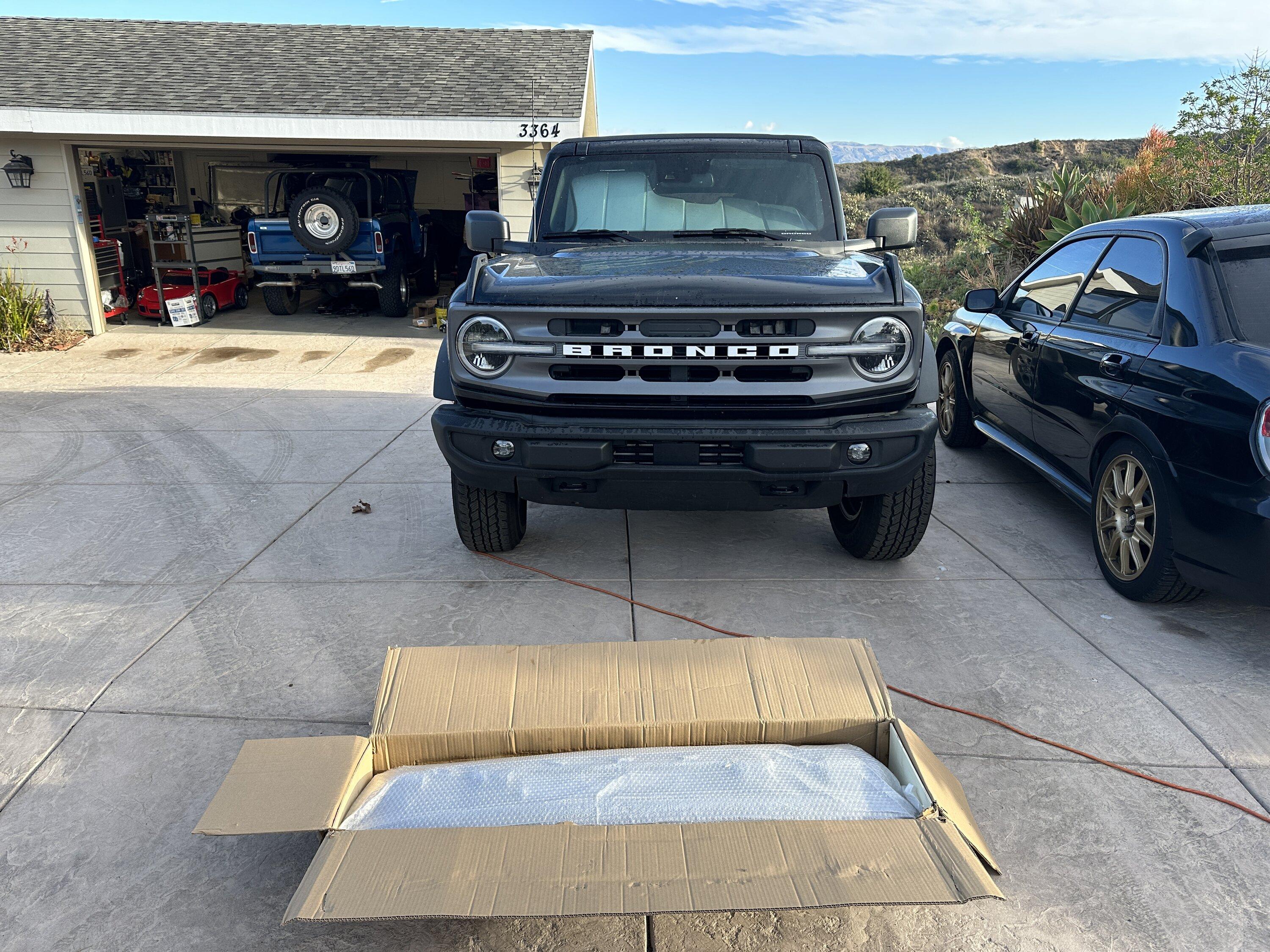

Its here!
I'll start off by saying; I wouldn't be shocked if these are actual ford bumpers.... metal is thick, hardware is a factory match, even the plastic face covers feel like ford plastic.
Now on to the important stuff.....
It arrived last night, I opened it this morning, the box looked like it was in good shape, upon opening; the bumper definitely had a tough journey from China.... And there was no assembly manual.... I reached out to the seller to see what to do next, as I'm hoping for a discount. Here are some pictures of the panels up close as well as some of the damage. Also, I love the text on the box, I was laughing pretty hard when I read that.
Also, this amazon bumper is the exact eBay bumper, box has the same part number.
Glad to help, it was a puzzle putting together for sure and no resources for where clips go etc, a little trial and error got me there so glad to pass it on

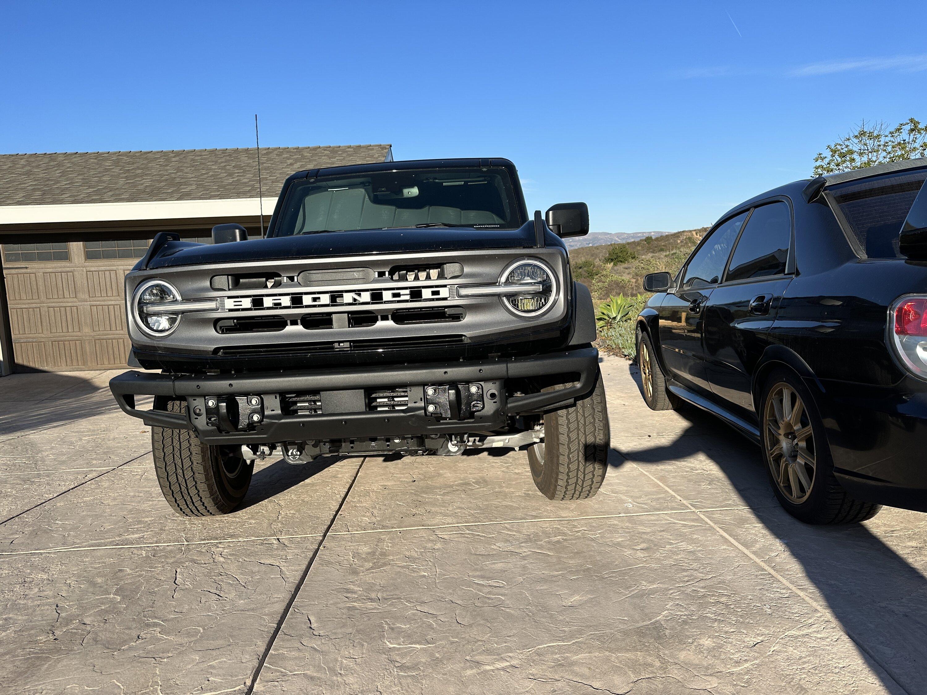

Bumper is on!
You cant beat the look for $300. I made a video showing where the clip bolts go, and frankly I may have been missing some. I found a photo on thee bday auction for this bumper that helped identify what goes where on the inside.
All said, I might as well be the ford bumper.... makes the truck look great. Total install was about 4 hours, and that was after I burned up 3 blades cutting the factory recovery points.
Plastic covers aren on yet as I'm still deciding if I need to move over my fog harness.

could you shed light on where the longer hex bolts go?
The longer bolts are for where you would mount a bull bar.

Bumper is on!
Dope looking bronco in the back man!
