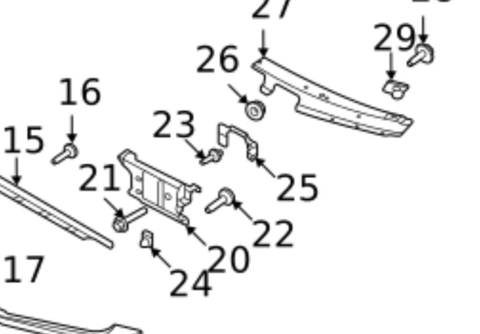

Well, I got a second hand Raptor bumper. Now to figure out what parts I need.
Ford Bronco Replacing factory bumper with modular bumper IMG_3920
Looks like pieces 20 - 25. Found something that said 6 of piece 21. Not sure on quantity for 22 - 24. Left and right for 20 and 25. Haven’t found part # for 24 yet. Plus tow hooks… Maybe I should’ve bought a more complete bumper… :ROFLMAO:

I think 24 is this one… LC3Z-17C756-A

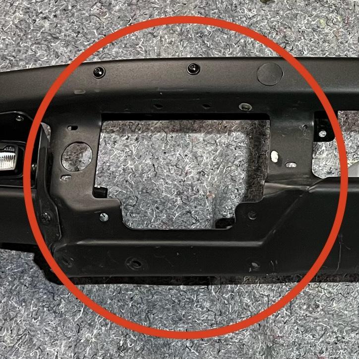

This is what I’m dealing with. All the stuff that goes in the red circle is missing.
Ford Bronco Replacing factory bumper with modular bumper IMG_9616
