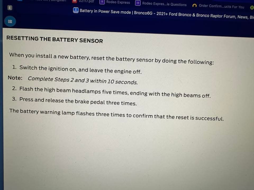

I need to double check the manual (too lazy right now), but I think it states the BMW will reset after sitting 8+ hours with the doors locked and it goes into a deep sleep mode. Or there is the brake and flashing lights thing you can do, saw a Youtube video on it once.
I happened to see that on a Facebook post the other day and saved the pic they took!
In case the pic gets deleted and this website's photo archive goes defunct some day in 20 years, it reads:
"RESETTING THE BATTERY SENSOR
When you install a new battery, reset the battery sensor by doing the following:
1. Switch the ignition on, and leave the engine off.
Note: Complete steps 2 and 3 within 10 seconds.
2. Flash the high beam headlamps five times, ending with the high beams off.
3. Press and release the brake pedal three times.
The battery warning lamp flashes three times to confirm that the reset is successful."
