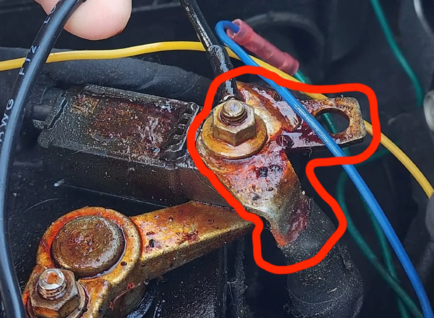

I think I actually do have mine hooked up after the BMS then! Didn't realize the BMS was actually part of this stud. Black wire I'm touching goes to the battery tender. (The brown/orange goop is NOCO battery terminal anti-corrosion spray-on goop)
Just do what @Ducati1098 says, but hey, clean up those damn terminals looks like you spilled pancake syrup all over it and just left it. That's gross and can be dangerous.
Grab a cheap brush off Amazon or at the Harbor Freight and try to keep that area tidy. :)

That is NOCO anti-corrosion coating, as previously stated - basically a fluid film version of dielectric grease that gives better coverage as it seeps into cracks where dielectric grease would miss. If I clean that off then they will be more susceptible to corrosion. I have battery terminal brushes lol. I periodically use them to clean my battery posts and terminals and then re-coat with battery terminal protectant.

I’m a little confused ……why does it matter if connecting to actual battery post or tab coming from BMS, both locations are on battery side of BMS…..??????
No only the battery post is on the “ battery side” of the BMS and therefore the BMS cannot do its job. Using the tab allows the BMS to sense all the charge heading towards the battery.
Hmmmm……..I’m just not seeing that. Battery post connects under tab on BMS and then comes the BMS housing and then the wiring comes out of other end of BMS…..I can’t see how there’s a difference between battery post or tab on BMS
I would understand if tab was on other end of BMS near wire exit
Because just as you describe the BMS is between the battery post and the tab. Anything on the tab or beyond it (basically the rest of the bronco) forces the current to pass through the BMS allowing it to measure the current. Anything connected directly to the battery post itself bypasses BMS.
I didn’t say that….BMS tab is on battery post side then to the sensor then outgoing wires. If tab was on wire side coming out of BMS then yes it would make sense. I’m not trying to argue with anybody on here I’m just not seeing BMS between tab and battery post. Post and tab are both on same side of BMS
Not correct - the tab is not on the battery side of the BMS. If it is, then it was installed incorrectly somehow. The black box to the left of my red circle is the BMS. The red circled item is the tab we're talking about.
