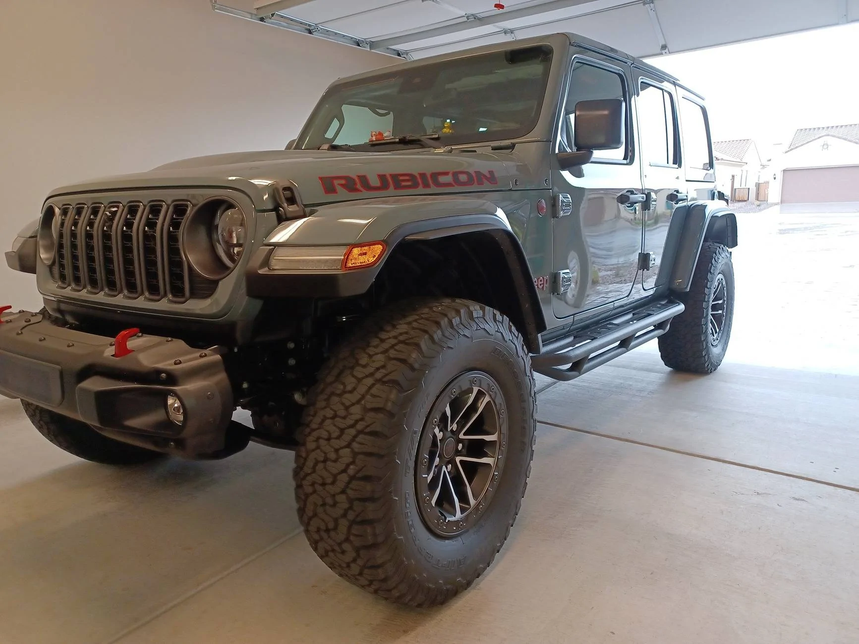

been looking at Broncos, or as they say in my 4x4 club "thinking of going over to the dark side" :unsure:
My current ride is a:
Ford Bronco Perspective owner - Questions 20240107_123055
I'm pretty versed in off roading in a Jeep, however in the Bronco world I'm looking at 23 / 24 Wildtracks and Badlands (both Sasquatched). Seems to me that the major difference is Wildtracks = Hoss 3.0 and Badlands = Swaybar Disconnects. That is one of my questions. In my Jeep, I disconnect the swaybar , (when I remember to - because I just push the button). I'm pretty sure most of the places I go it isn't necessary but it may make things a little easier. That said, the Hoss 3.0 setup appears to be all the suspension I would need and appears more "heavy duty" the hoss 2.0 on the Badlands.
Any thoughts on this, and has anyone added Swaybar Quick disconnects to the wildtracks? Any additional information that maybe useful? One thing I noticed on the test drives is the Bronco is "head and shoulders" above the Jeep on the highway. The 2.7 is more responsive than the Jeep's 3.6 and it out handles and accelerates on the road. If anyone has experiences off roading the Bronco, I'd like to hear how the Bronco is on trails and in the desert (AZ & UTAH).

The Rubicon looks great by the way. 👍
