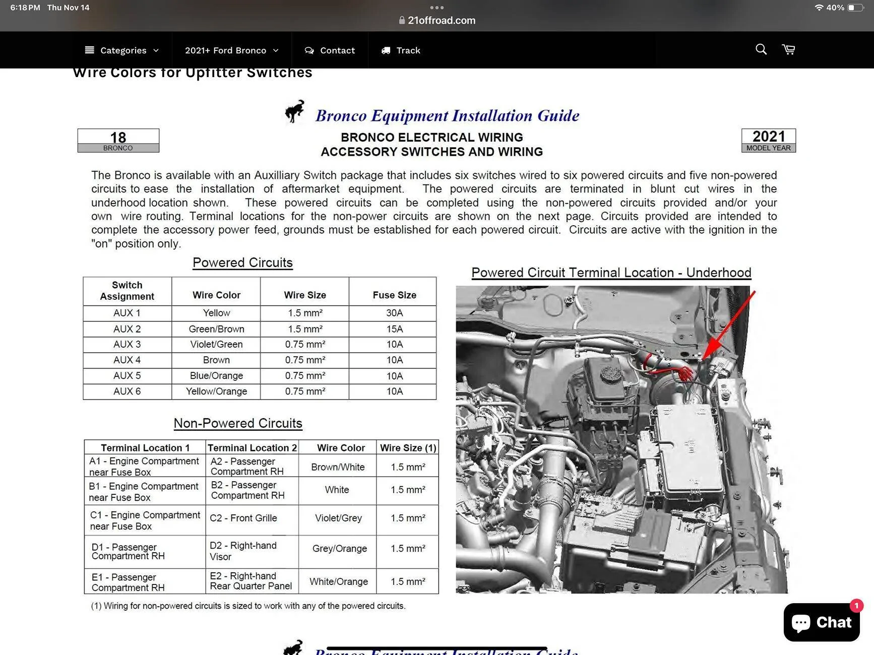

5)Any guides for how to wire into the aux switches for lights and such?

#5. I found this one.
