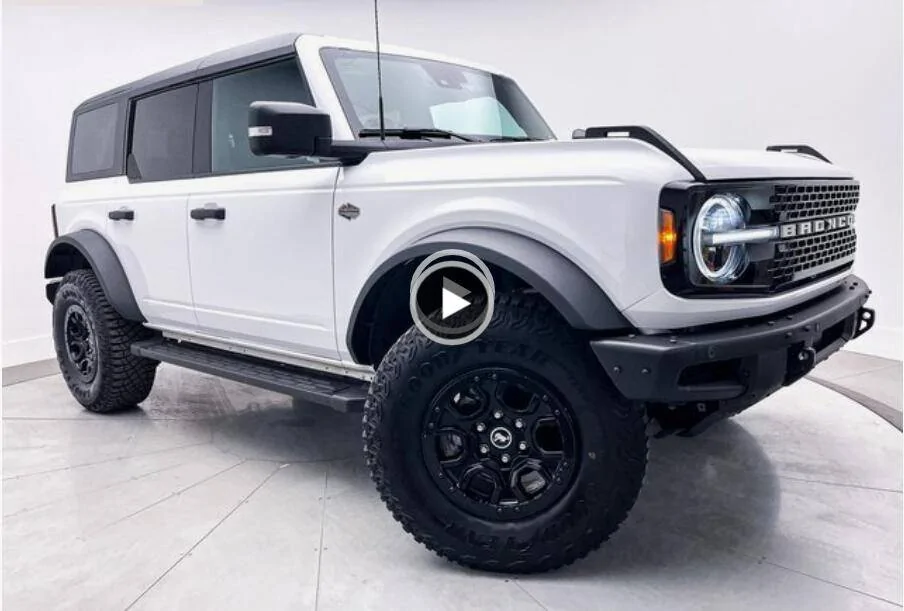

I may be getting ready to pull the trigger. This is a 23 wildtrack. 28k miles, power seats NO LUX. I believe this means I'm giving up: Homelink (can fix that) the base stereo (that too can be fixed), No wireless charging pad (don't care about that) and ACC (can't be fixed). It does have regular cruise control, and the NAV requires some subscription.
Anything I should be looking for or at, besides the issues of needing swaybar disconnects? How much skid plating have you WT guys added underneath?
thanks

Looks nice.
The high tech stuff is personal - and you said what you think about that.
For skid plates -- It should have a steel engine plate, but that will be about it. Most folks will do the full Ford Skid plate set - starts at around $800 - less with sales and Ford Points - it includes trans / t-case / fuel tank skid.
There are a lot of aftermarket options as well, none all that much better than Ford's though - but if you wanted aluminum to cut weight, or UHMW for slickiness or what not - they all exist.
You will probably want mud flaps with those tires - they are good traction, have somewhat thin side walls (if you do anything near sharp rocks or really bad pot holes), and are notorious for throwing small rocks until they are well broken in. 28k miles ~should~ be broken in, but...
The side steps - you may re-evaluate those if you get into rocks. For getting in and out of Starbucks they are great though.
I find the base radio is easier/cheaper to upgrade. The B&O isn't so great to begin with that I would forgo an upgrade all together, and it's way more expensive to upgrade, so it isn't a huge loss, at least in my opinion.
Swaybar disco - I threw a 21mm and #6 allen in with my jack. But it doesn't bother me to spend 5 minutes crawling under the truck before and after the trail either. You can get the electric one from the Badlands and retrofit it in, and there are a lot of aftermarket options -- the usual suspects from the Jeep world.
That's ... about it, until you get into super personal stuff. Nice find.

Looks like that one has a steel bumper, not sure if that includes skids or not. '22 WT 2-dr had plastic bumpers and, no steel skids at all other than the fuel tank. It had a thin plastic engine guard. I don't think 4-doors come with a fuel tank skid. Check out Stinky Fab Racing or SFR. They are very stout skids and they bolt to factory locations. They also have the room if you want to add the electronic sta-bar disconnect on later. Did you use the VIN to look up the window sticker?

I'm not 100% positive, but I think if it came from the factory with the Mod or Capable bumper, it will have the steel skid, and if it has plastic bumper it has the plastic skid.
Plastic skid won't fit any of the stock bumpers except the plastic one.

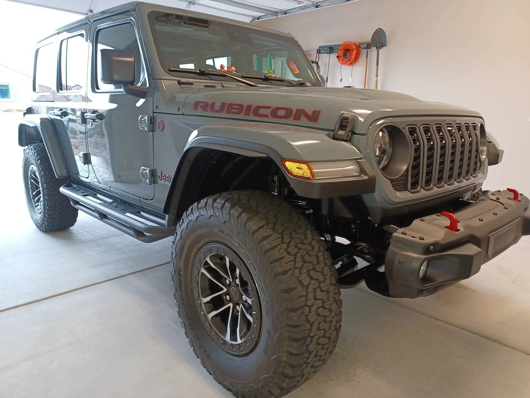

Yes those steps won't last a month.
Ford Bronco Perspective owner - Questions 1742949881164-iz
Sooner than later this type will make it's way to the Bronco. They can take a pounding AND they mostly stop rocks from being kicked up.
I will have to give the 21mm and #6 allen method a try. Admittedly 1/2 the time I forget to but in the rubi I just "push the button".

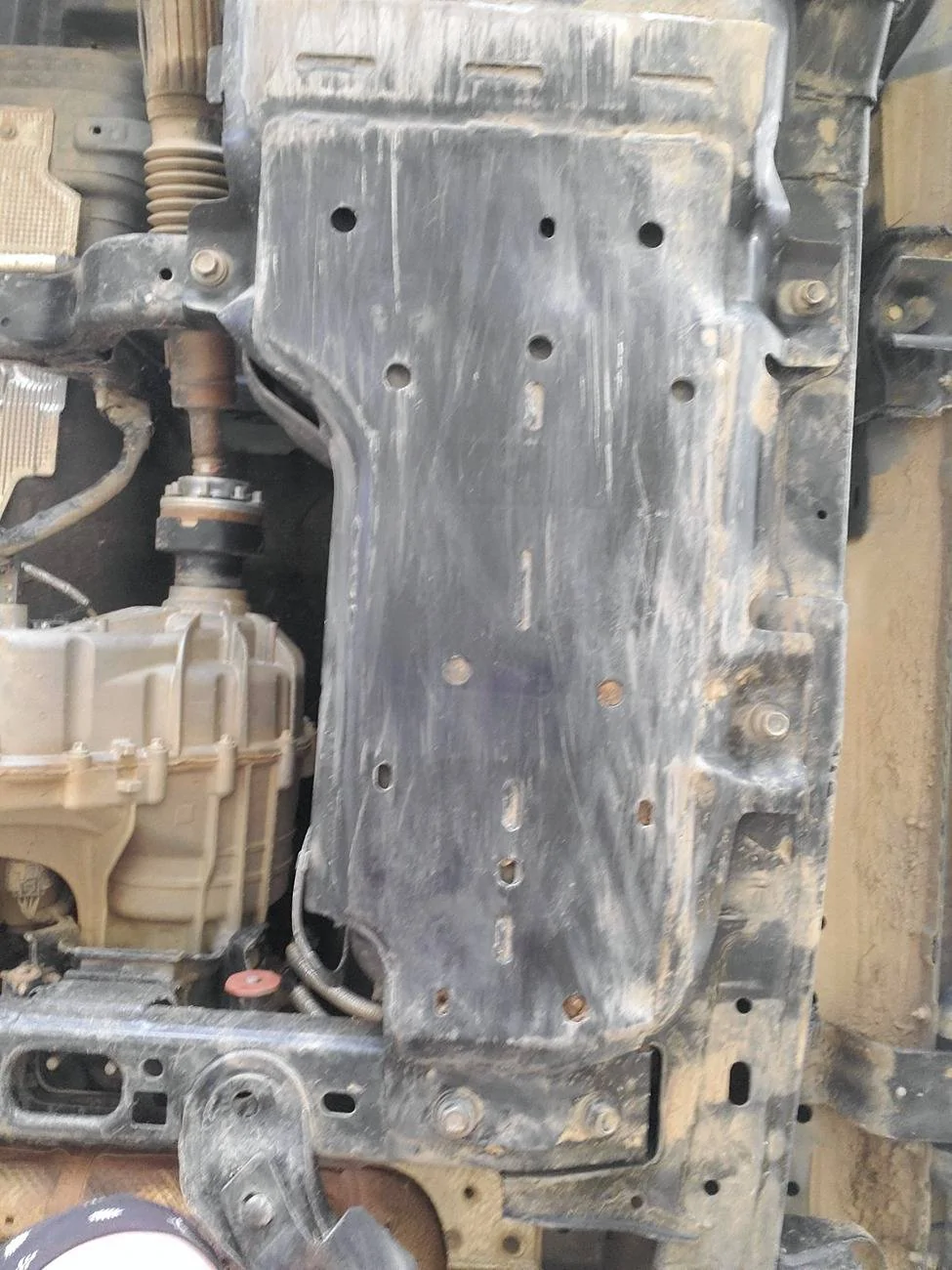

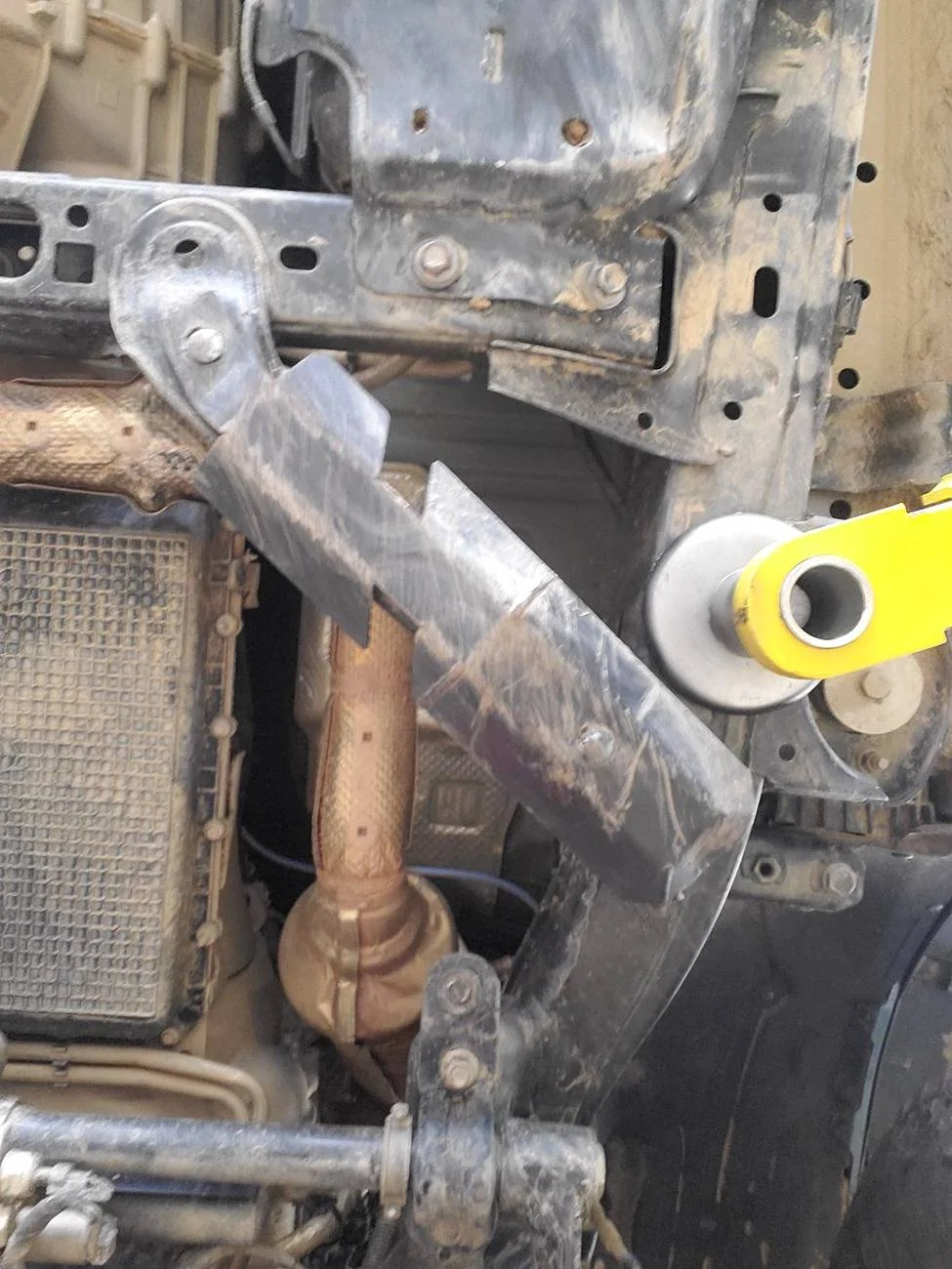

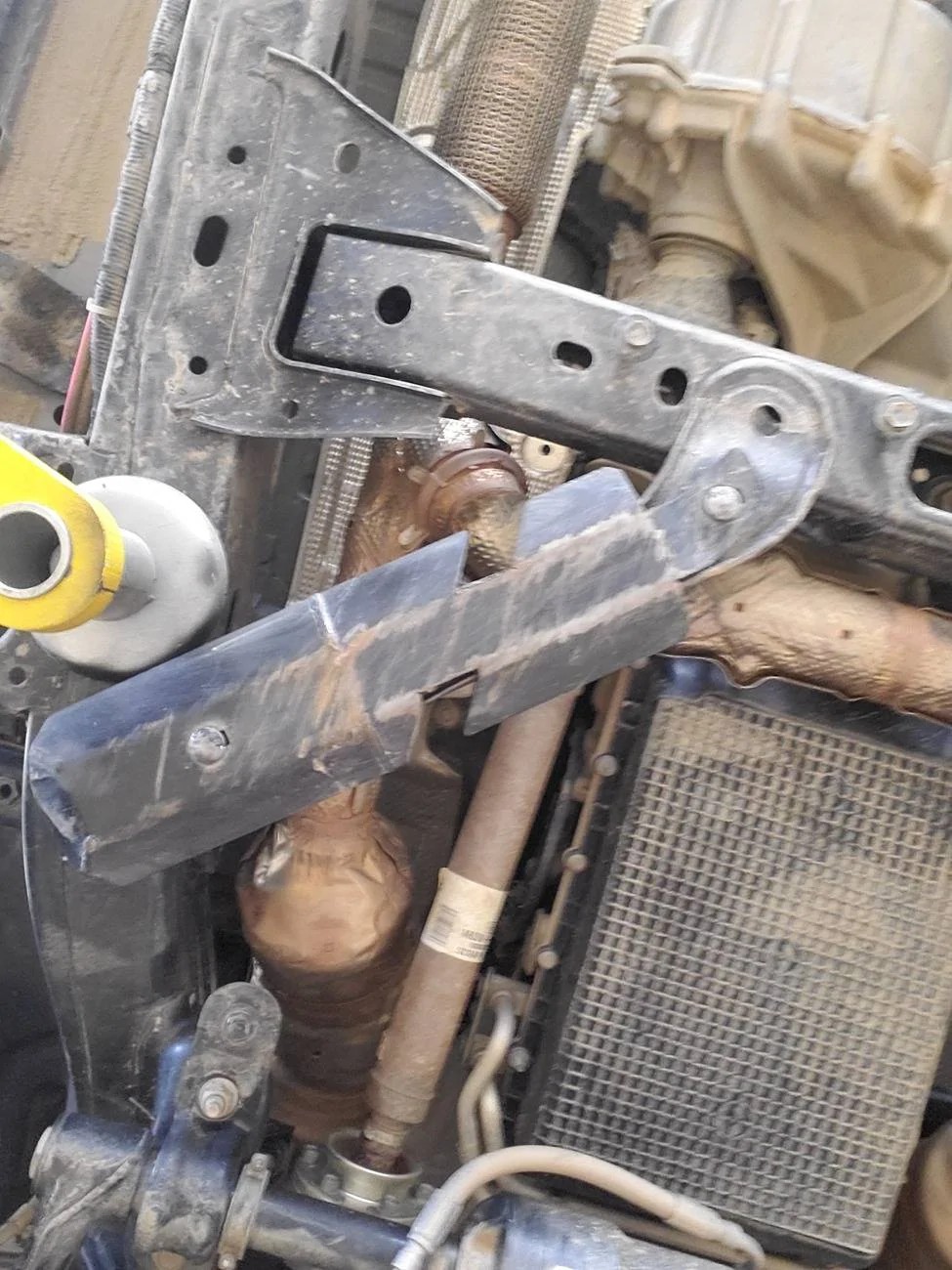

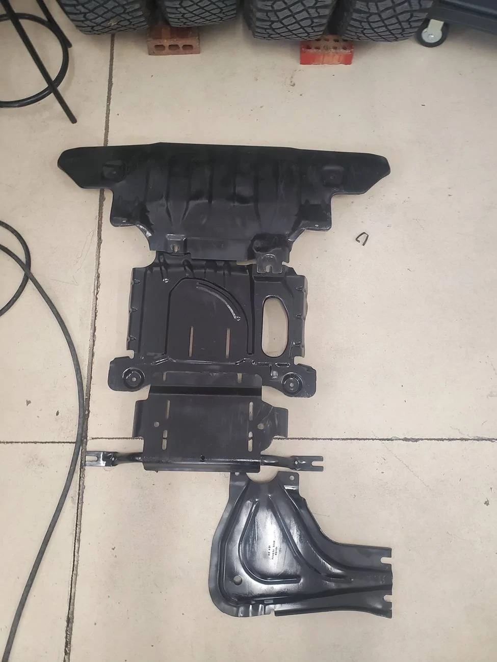

Skid your k members on the frame A arm mounts and trailing arms if you see rocks.
Ford Bronco Perspective owner - Questions 20250324_144458
Ford Bronco Perspective owner - Questions 20250324_144517
Ford Bronco Perspective owner - Questions 20250324_144503
Ford Bronco Perspective owner - Questions 20250324_144512
Ford Bronco Perspective owner - Questions 20250324_133328
That is all from the last trip and skids repainted. I'm team 2dr. On 37's.
