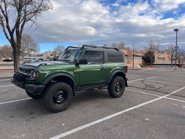

Just had the eibachs with standard springs installed on my 22 non sas BD the day after Christmas. Had previously put narrow 35” tires on the factory steelies. Ride ins noticeably softer that the factory shocks. I have a winch mounted out front and still don’t have as much brake dive as before. Made the mistake of not doing UCA’s and had to lower the fronts 1/4” to even out the handling as the adjustments were maxed out. Definitely recommend this change and new UCA’s
nice rig. What tires did you go with? You ended up with approximately what 1-1/2” - 1-3/4” lift over stock
needed UCA to get the alignment dialed in?
