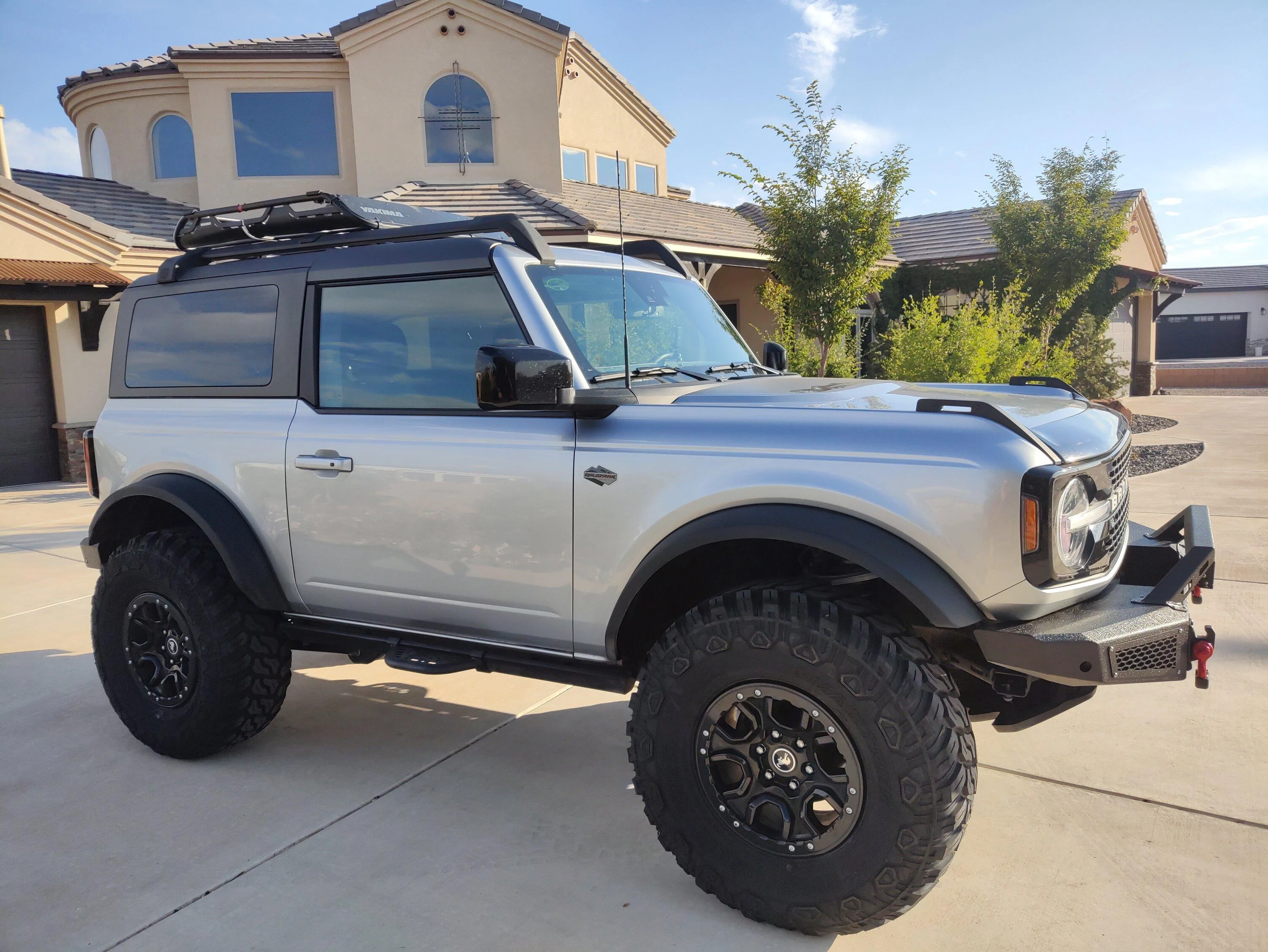

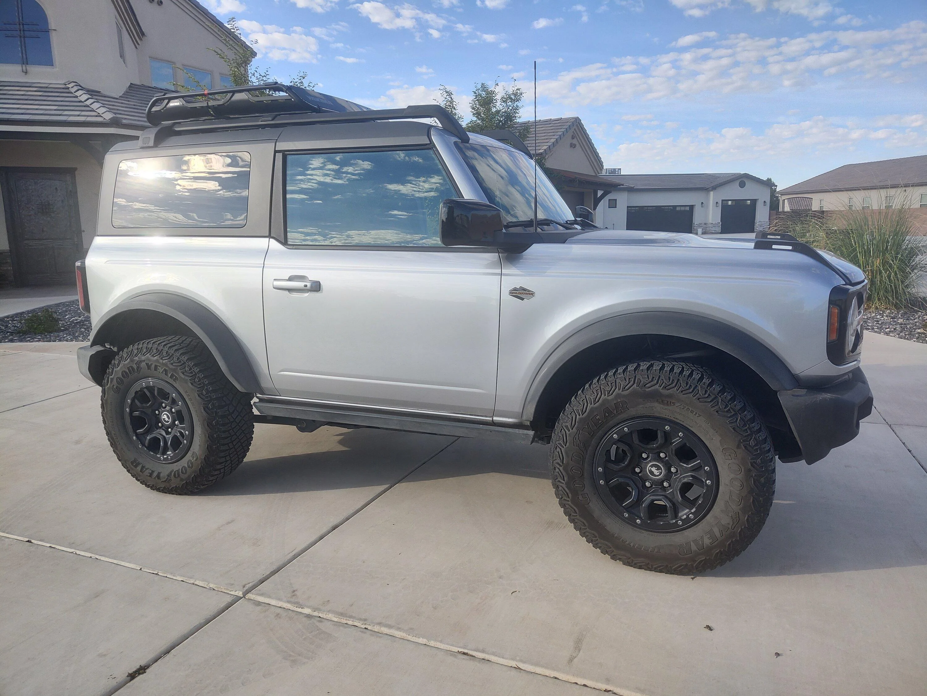

I have researched this for months. Finally went with SVC perch lift. FOR ME it is the best option. WT/SAS/2D- 1. I have an EB rock crawler don't need or plan on horse whipping this rig. 2. SAS is too soft for my liking- perch will help stiffen 3. Haven't had a flat or need for a spare in 25 yrs of wheeling Moab/ Similar 4. Reduce weight on rig/trail gate 5. Tighten up the look. 6. I am not sure what I am doing is right. 😐

Went with SVC, 37's and, 1" wheel spacers. Grades: Look "A", City ride "B+", Off road ride at speed "B-", Off road ride Trails "A-" gas mileage, "C+", Value "A+", Alignment issues "A" Functionality for casual wheeling "A".
I generally run high speed off road 65-75, the original set up is going to be hard to beat. Was super smooth and stable but I just didn't like the look. Not confident with new lift.
But like the look.
But like the look.
Thanks for the follow up. Looks sharp for sure!
I ended up going with eibach springs- majority of thread on that kit suggests they're "softer" than stock. Although that maybe doesnt add up when you think about stuffing more spring in the same amount of travel they do say they're progressive - think eibach did their homework
I think SAS bilsteins, esp rear, are pretty firm and I don't plan on running 2dr wheelbase at high speed offroad so I could stand to have it bit more squishy
37 load C K02s on motegi trailites, JKS tire kit, eibach springs, RC steer bushings, and DV8 shock skids all waiting for a long cool Saturday to install.
