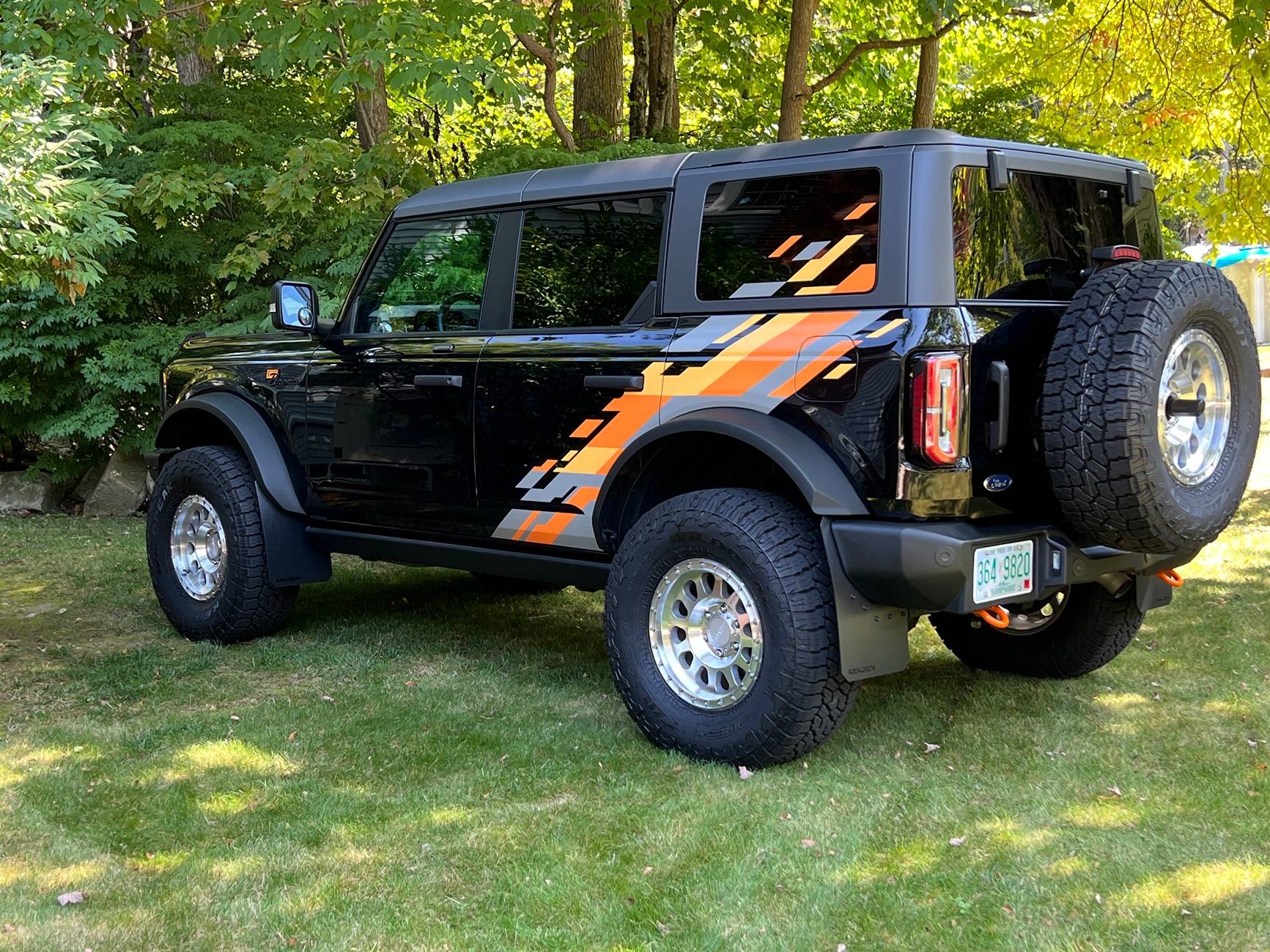

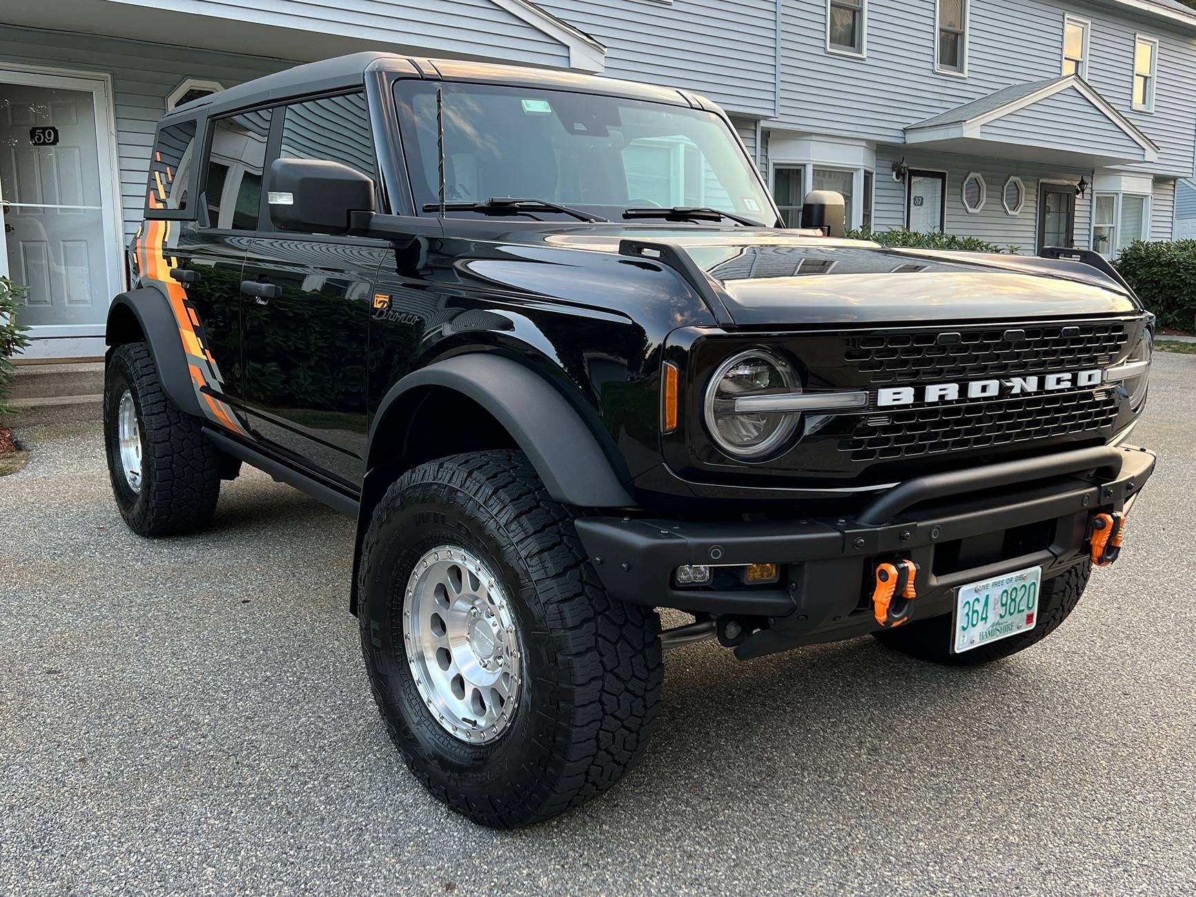

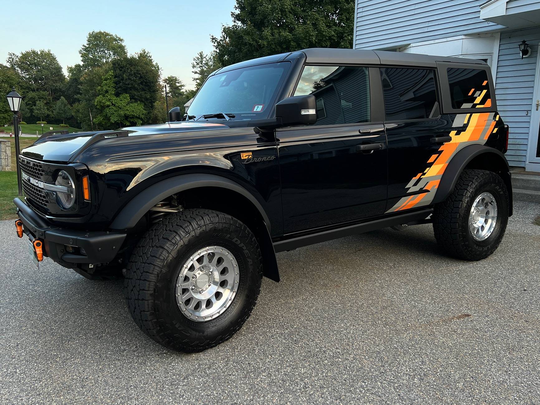

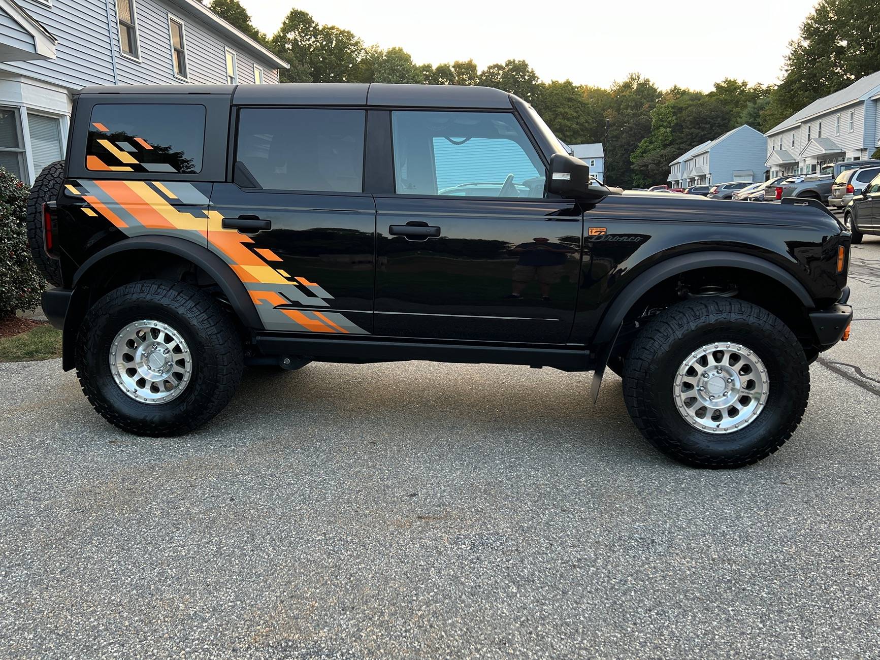

I have the Eibach 3.0 Pro Lift coil springs on my 2023 Wildtrak 3.0 HOSS Fox set up. I wanted more clearance up front for the Method MR315 wheels. I went with a 0" Offset wheel and Falken Wilpeak ATW4 315/70/17 tires which are a little bit bigger than stock and had a little rubbing on my mud flaps at full lock when backing up. Eibach advertises +1.9" Front +1.3" Rear increase with the 3.0 Fox setup. I got almost exactly that amount of lift. Between 1.75 and 1.875 on the front and about 1.5" rear. I still have a little rake front to back of about 3/4" higher in the rear but I'm good with that small amount of rake. So far liking the street ride. I personally think the Eibachs are a little softer and smooth out the hard bumps like pot holes. If it were me going with 37s I would go with the Eibach springs, JKS clearance kit and UCA and you should be fine.
Nice looking rig. On a previous Bronco I had RPG 3/2.25 and had zero rubbing with my BFG 37’s. With true 37 I would be up shit creek. I don’t hate the ride I have now just weighing out my options.
What’s your measurements ground to fender if you have them handy? Would be good to compare and see where I sit now. I have 35” Recon Grapplers currently.
On Falken Wildpeaks ATW4 (35") 315/70/17 tires which are just a little bigger than the stock Good Years and Method Racing 315 wheels with 0 offset. I got FRONT DF 40-1/8, PF 40-1/4 REAR DR 40-7/8, PR 41.0
Thanks! I’m running 35x12.5x17, Nitto Recon Grapplers, and Method 315, with Foutz 2/1.5 collars and honestly I’m a littler underwhelmed by the amount of lift I got. I may move the 2” collar to the rear and get a 2.5 for up front.
I also added about 80lbs of gear in the cargo area after the lift, my wheel/tire setup is only 7lbs heavier than stock. Also running 32psi
DF: 39.375
PF: 39.5
DR: 39.75
PR: 39.875
