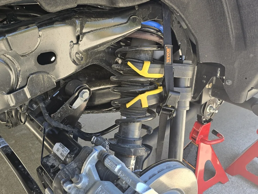

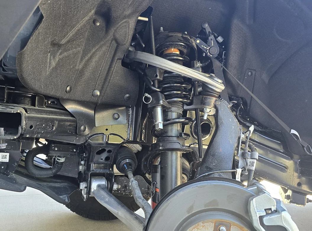

I actuall was successful with installing mine. I used the traditional spring compressor from Harbor Freight for the fronts, and the strut compressors for the rear. Took about 4 hours total in the driveway and a floor jack. I was not worried about it being sketchy because the springs never were removed from the Bronco. If the spring compressors ever let go, the springs werent going any where. Just watch your fingers.

Ford Bronco RPG perch collars. Bronco front coils
Ford Bronco RPG perch collars. Bronco rear coils

To be fair, the collars were the smallest 2 piece ones RPG makes. Also, my Bronco was Mfg. in January 2025 so the perches weren't very stuck. I used a small sledge hammer and a 1/2" drive x 10" ratchet extension and just the hammer. Basically a metal solid bar. I tried a wooden dowel, but the wood absorbed most of the impact and the perch wouldn't budge. All in all, the RPG are top quality and lifted my Bronco about 1".
