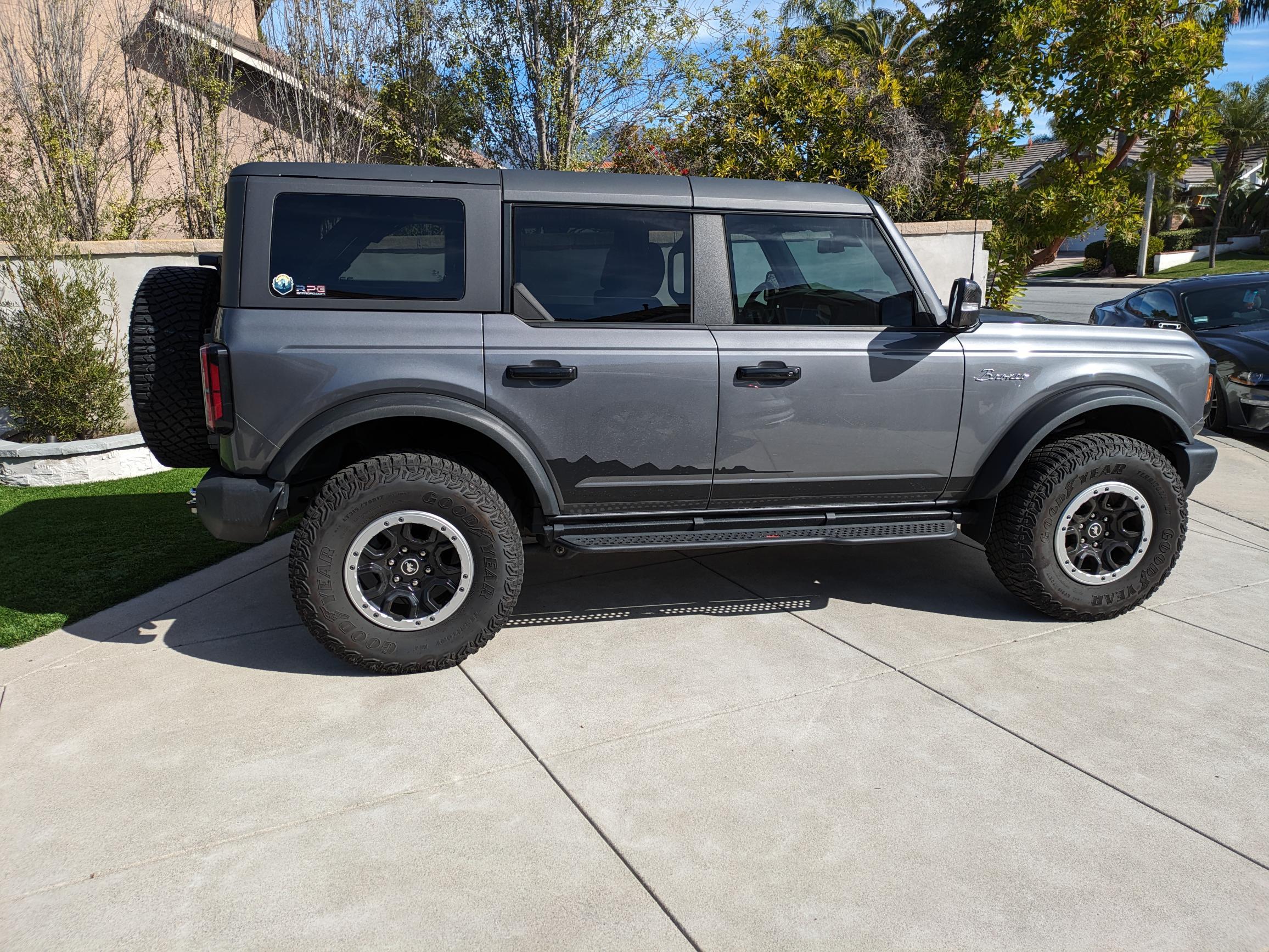

Before and After Measurements (not exact and I suspect suspension may need to settle a bit)
Before lift
Rear: 6 3/4", Front: 6"
After lift
Rear: 7 3/4", Front 8"
Before and After pics:
Ford Bronco RPG Perch Collars Installed. PXL_20240127_191954277
Ford Bronco RPG Perch Collars Installed. PXL_20240129_201750805 (1)
It looks like the post install measurement difference in lift from front to rear is potentially due to the angle of the shocks as they are designed (front being more upright and rear being more angled) which changes the actual lift. I had read that somewhere and was hoping that would be the case as I didn't want a crazy high front end anyway.
I love the stance and the way this looks and it actually seems like it handles a bit better on the road, through turns, and with a bit less nosing when braking.
