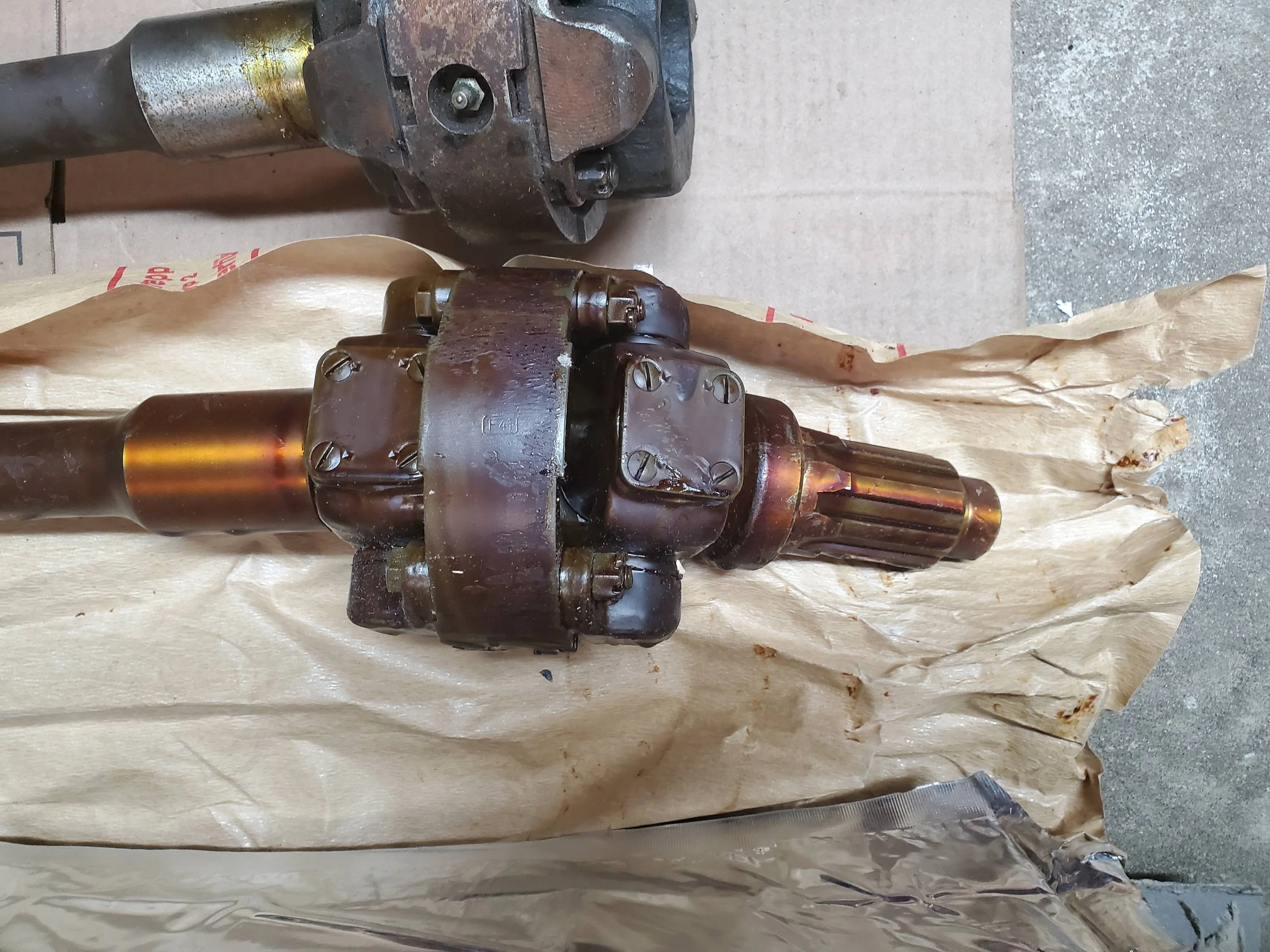

@ only 22% reduction @ portals, I agree. My mogs are 2.13 (with 3.54 diff gear), so it's ballpark "100%' difference between axles and tire (obviously I'm very limited on top speed).
They also use a double cardan for steering axle, which I've never broke @ 6200 lb and 43 stickies. I've always wondered why no one tried the double U-joint style instead of CV's. Maybe packaging I guess. (and you'd need 4 of them with 8 joints, UGH!!)
