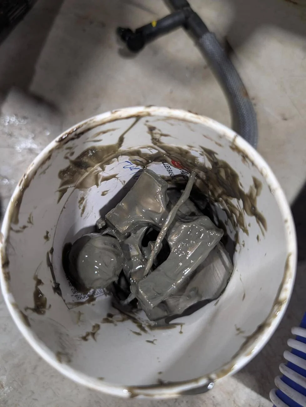

God @!#$@#... You can hear it popping right at the end..... Passenger one again. And yes, It's my fault, 5 inch lift with 37's.... And also should of not "sent it" . But @#$@# it was a fun time!
I need to figure out my set up once in for all....
This trip was EPIC. Hardest trail yet. It's the same KM9 trail as my "How deep can the bronco go Video". I'll have the full video out in a few weeks. But felt like starting a new CV shaft conversation.

5” lift needs 2+” diff drop…

Shredded....

If you watch my videos, you know my 11 year old is with me most of the time... Well you know you break a lot of CV shafts when you tell your kid and the first thing he says is "Oh, can you keep the little metals balls for me!"...... :sadface:

In our wheeling group, once you strengthen the CV (such as RCV), we’ve had a few of us, myself included, lose the intermediate shaft . We are working with a company on a group buy to get a chromoly version of that as well. Definitely should do a diff drop with that much lift as someone above said.

Blew at full droop, you need to either shorten your your shocks or a differential drop. Get out the welder because nothing off the shelf is going to help you.
Spicer units might handle the higher angle longer.
