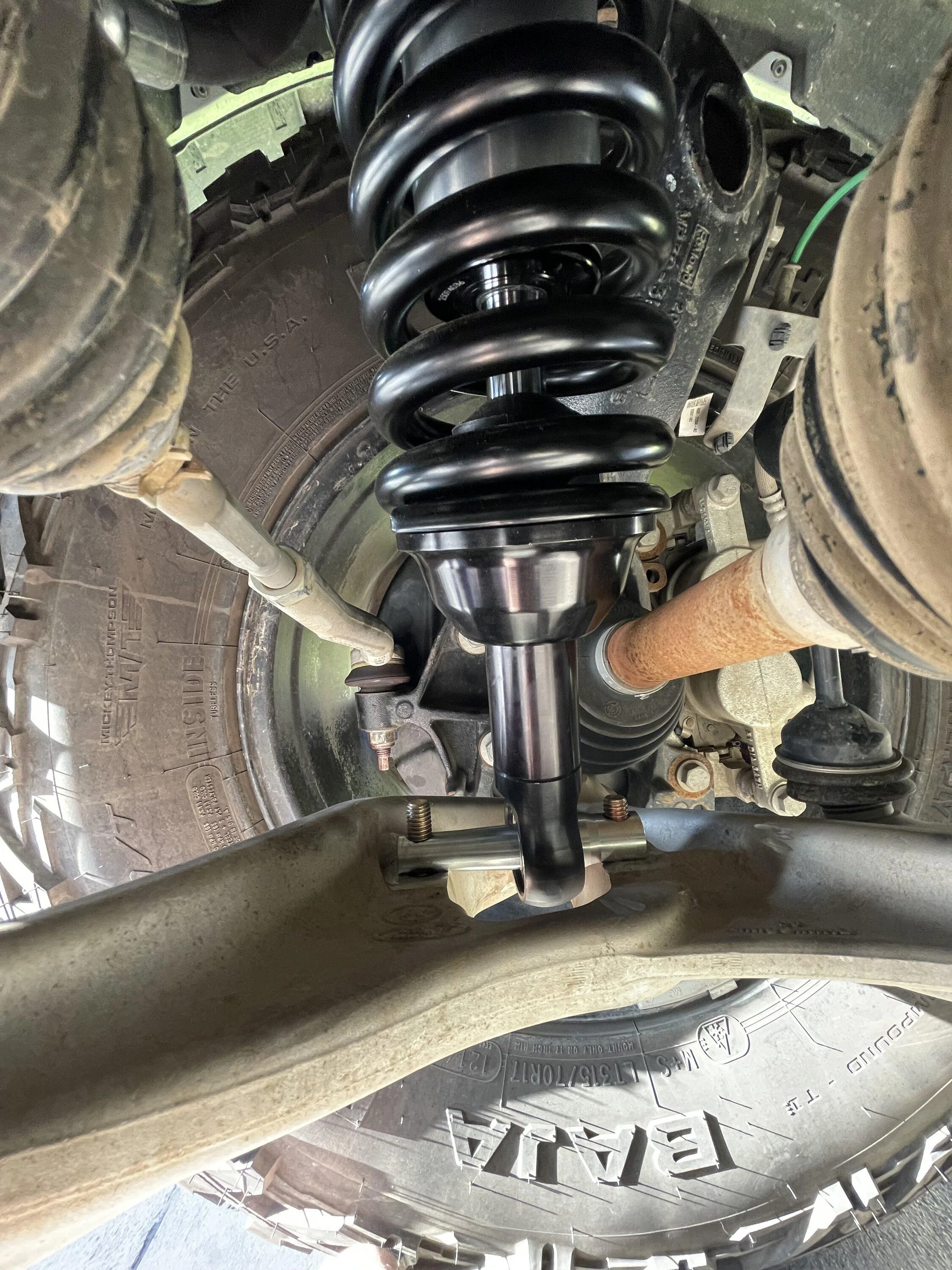

Icon 'Stage 8' Billet kit just installed...and, "oops!?!"

Looks pretty good! Looks like you might have an older kit? Not sure, looks close to the tie rod, but that’s not really an issue. As long as your hoses are good. You can buy the plastic spiral wrap. I run it on both my Raptor and Bronco, saves the spring from rubbing.
Got it. I‘ll mention this to my installer…btw, how can you tell it may be the older kit?
Take a pic looking down, or just look. If the shock is closer to the tie rod, old style. Closer to, basically right above the axle, new style mount. Going swimming, down to 104😂

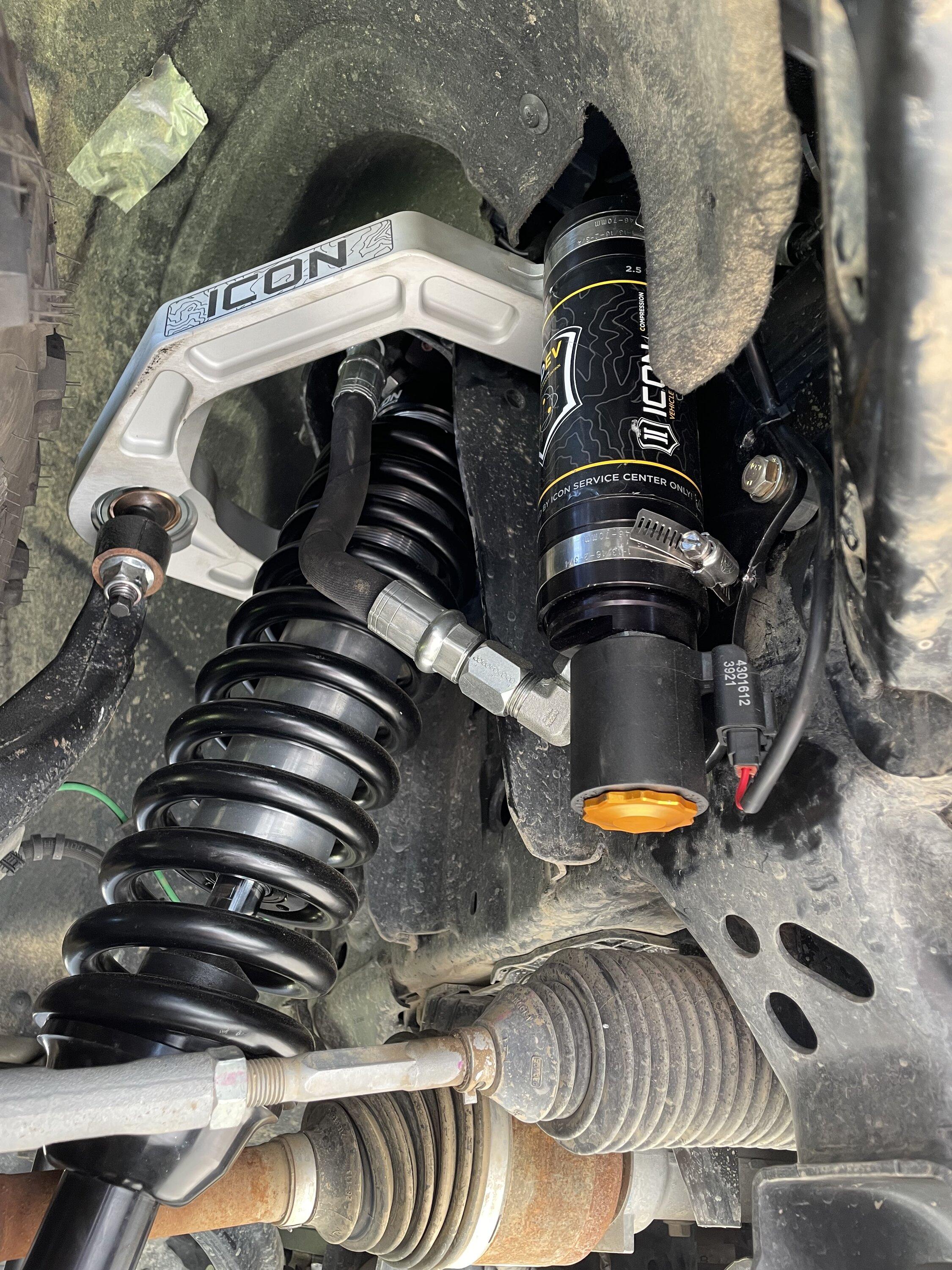

Yes - +30 offset moves the wheel inward 30mm (1.18 in). That is why you are rubbing if they recommend 0 offfset.
Well, that‘s important to know…as math doesn’t lie…unfortunatly, seems that can’t be said about ICON! Their TECH INFO stated “YES” fitment works with stock Sas wheels & tires. Ugh!!
Well, it does fit. You just can't turn. ;)
104...global w-w-w-whhhut? lol enjoy the swim, good sir.
looks like I have the updated version, all clear, actually closer to the axel than the tie-rod

I have Icon stage 8 tubular with Method 703’s and 0 offset running KM3 37x12.5 r17.
I know it’s not the exact same of course but this setup on the stage 8 has been amazing for what it’s worth and no rub.

Well, looks like mine clears the UCA but may rub on the springs 😳

Like others have said you need to run a 0 offset wheel. I am running a Method 705 0 offset snd 35 K02s with the stage 8 kit for a year and it has been fantastic. Note if you plan to run 37s at some point you will need to run a bumpstop and Icon can set you up.
