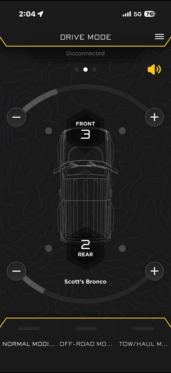

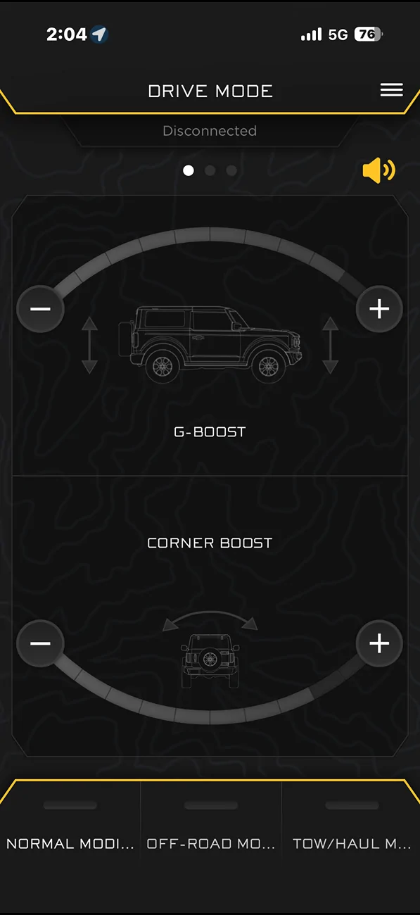

Thanks for the response above and it helps some. That said the Stage 8 Icon suspension includes new coils, upper control arms along with the Icon CDEV shocks. These shocks can be adjusted using a phone App to be light to stiff. The front and rear shocks can be adjusted separately. Levels are 1 to 10 with 10 being the stiffest. The amount of body roll (they use the term corner boost) and front to back compression during stopping and acceleration can also be adjusted using the App (G-boost on the App).(See pictures below)
The suspension has been amazing I’m just looking to find the best settings for washboard roads since I drive several hundred miles per week on those much of the year.

I know folks that have removed the sway bar as those shocks can see and adjust side to side in real time.
Anyways 2 and 3 is super soft. Great for onroad plush. I only need to run 5 or 6 on a fire road but 8 if I want to be aggressive. 10 if your going all out and want to hit all the whoops.

2&3 are my pavement settings. Even those are way better and stiffer than the stock Sasquatch it came with. I took the screenshot while out of the Bronco and App wouldn’t allow me to scroll to the off road setting unless it’s connected to the Bronco. I used 6 the other day on the dirt and that was better and more stable. I’ll give 7&8 & maybe even 8&9 a try tomorrow. I run stiffer on the front since I added a winch.
