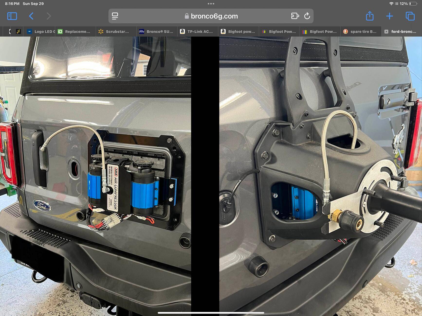

Has anyone seen or done the AGS Air Gate mixed with a rear bumper tire carrier? Trying to avoid air under the hood or somewhere inside.

There is this one I saw but for the life of me can’t figure out who it’s from,

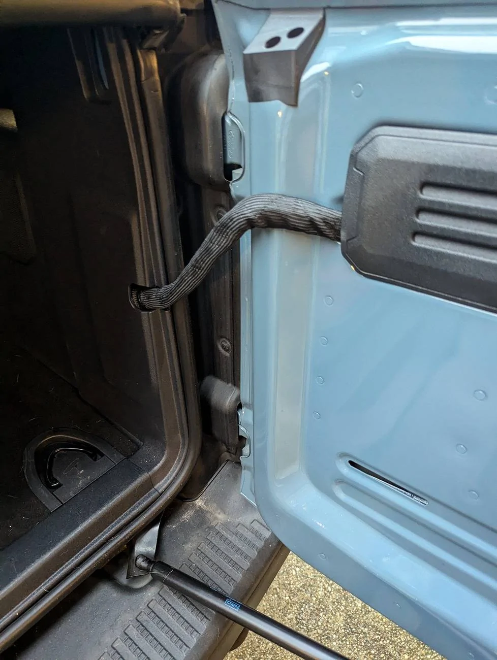

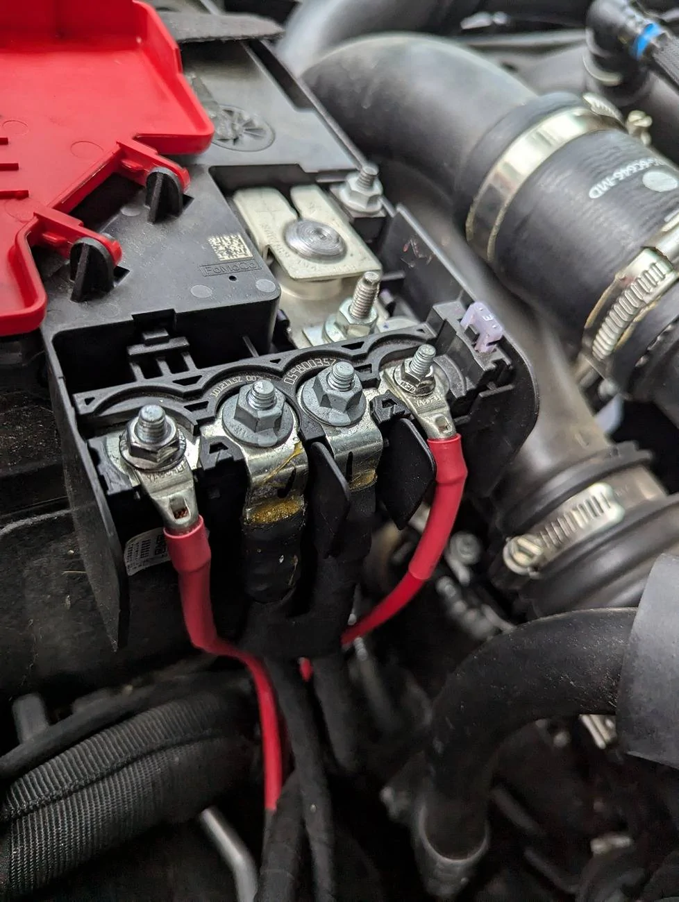

I installed it on my Bronco.
I really like it!

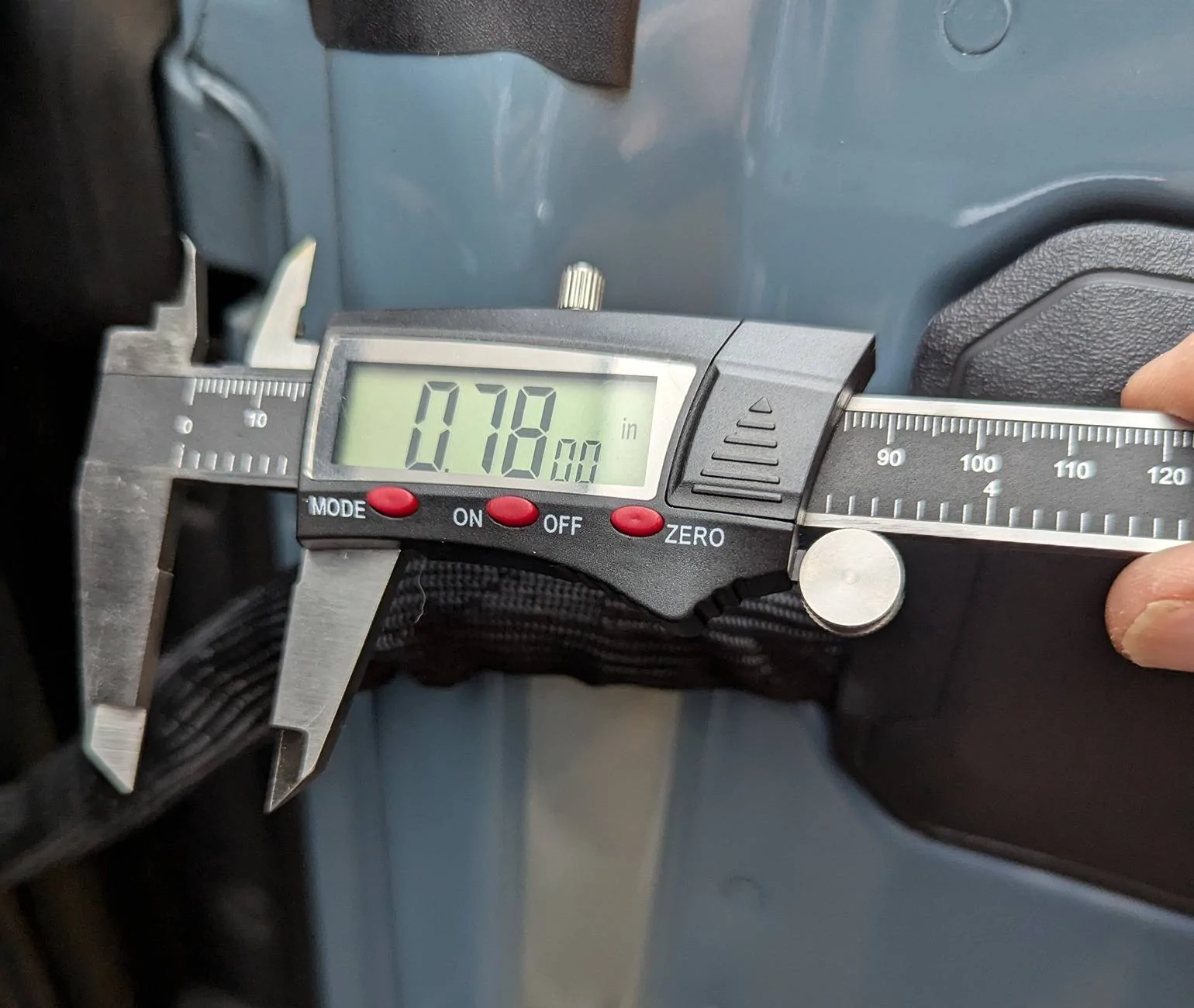

I really like this setup. Was it a pita to run the power cables... especially though the hinge side of the tailgate, I installed my twin under the hood, with kr brackets
RoverDude
Oct 28, 2021
321
378
Maryland
2021 Bronco (First Edition)
It was a small task. Not a huge ordeal/problem.

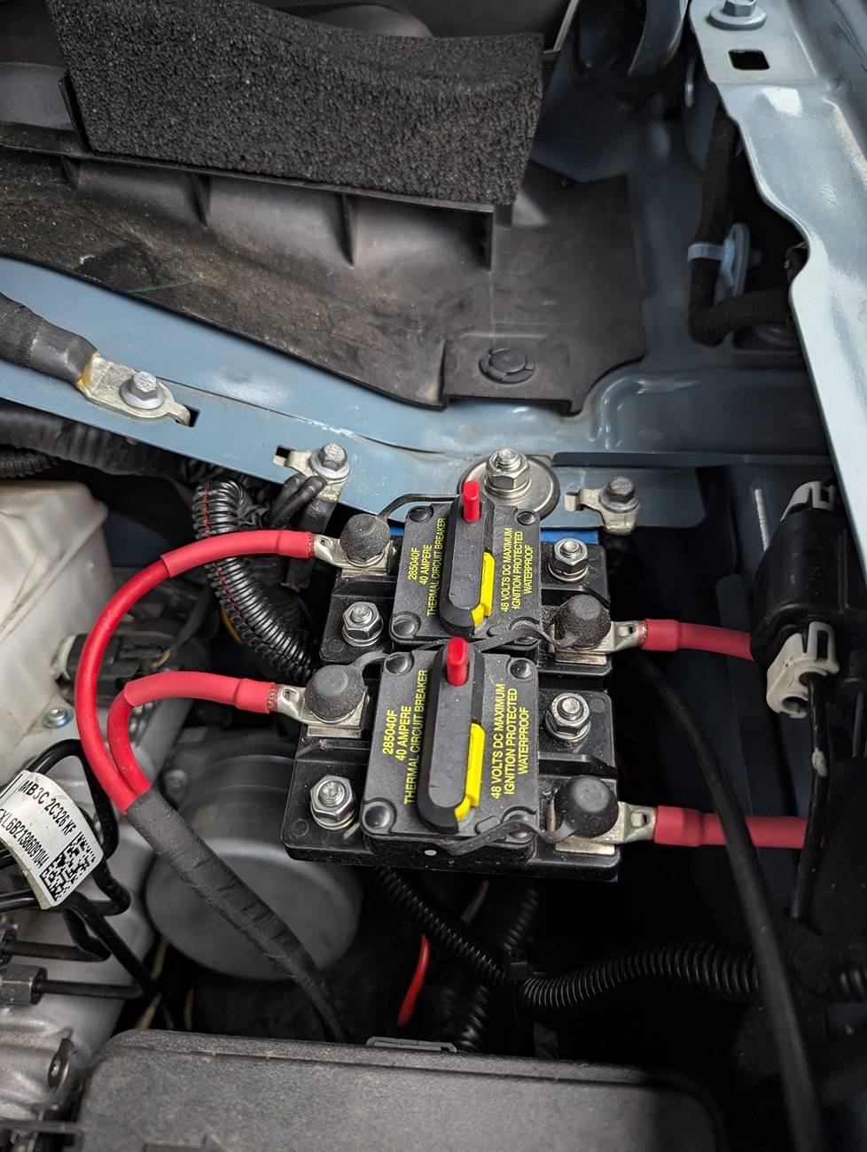

I used the supplied molex connector, But I repined it for larger gauge wire. (Bought different Molex terminals)
I ran (2)#8's for power and 16's for control (via aux switch)
Used a circuit Beaker versus supplied fuses.
I also got their air filter relocation it.
Overall, I think it good as works great and it not in the way of anything and barely visible.
I would recommend it, solid built quality.
Very nice! Thanks for sharing.
