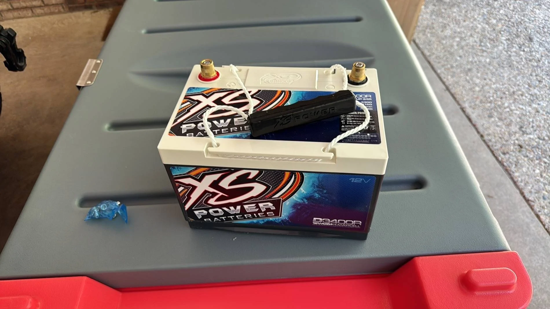

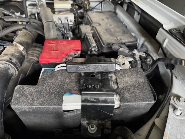

Bradley Thornton
Bradley
39
856
1,593
Hattiesburg MS
18 Sequoia TRD sport, 2021 Badlands Sas, 93 Cobra
Added an XS Battery it fit great nice and tight, Its not a perfect fit by size but it fits and it got tight with the factory bracket no movement.
This is the best battery on the market.
The video about battery testing is great BUT manufactures don't all test at the same temp. You have to look in FAQ to find what time they test. I have done a ton of research on the subject. They one battery will do the job of 2 its insane in the real world how good it does.
