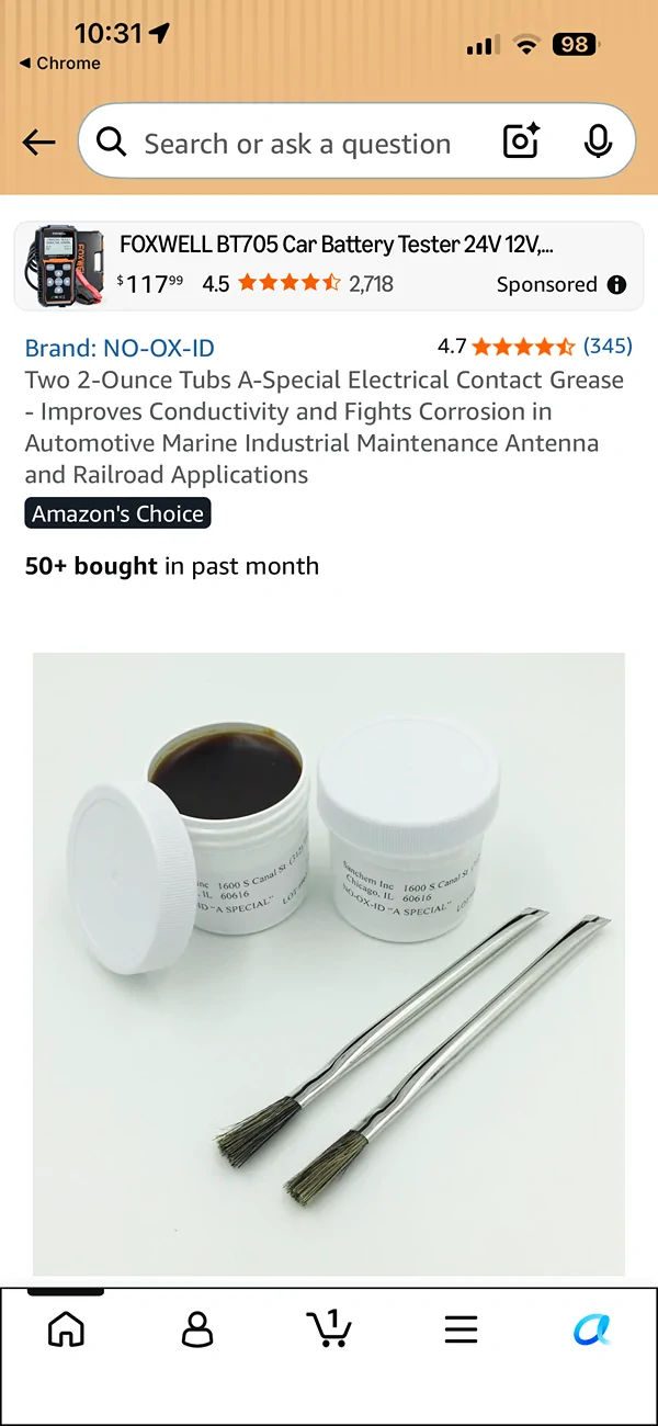

After 25 years in the telecom industry i highly recommend No-Ox Id special a for all DC connections. We used it on all of the DC connections in cell sites. It basically eliminates corrosion.
