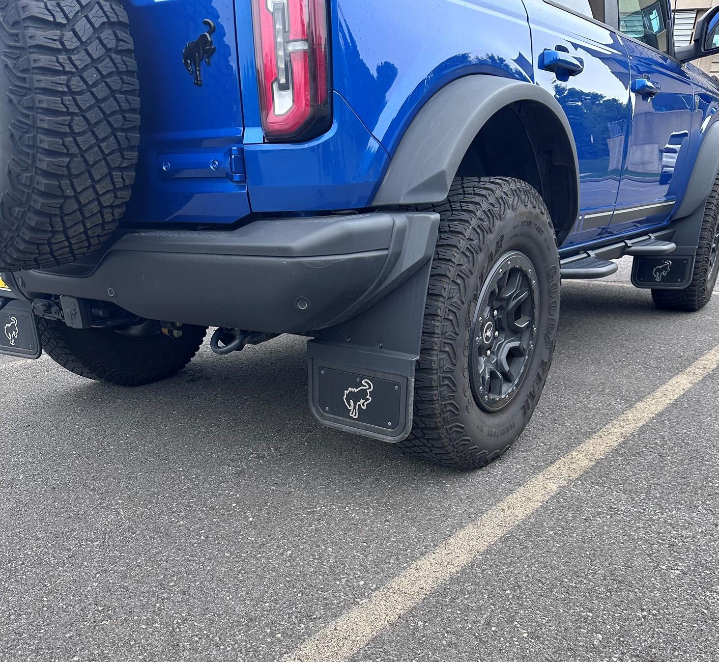

I bucked up and got the expensive ones (gatorbacks I think) from the Ford site. No regrets. They've taken a beating (especially during winter) and still look good. I think I actually like the way my bronco looks with them opposed to without.

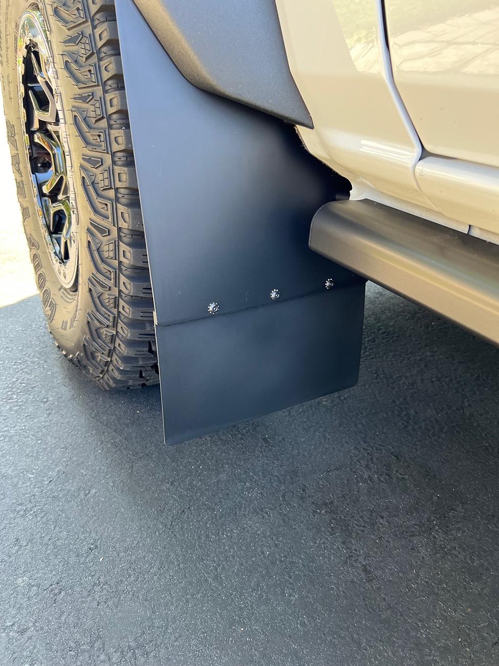

if you have a crash bar, make your own like I did. You can custom cut to any size you want. Mine are stout and perform perfectly.

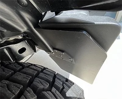

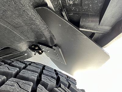

We installed the Mabett/IAG type mudflaps and used them for a week or two. Finally decided we didn't like the way the mounting brackets mount to the fender and extend into the active fender well area (both front and rear). A good hit to the bracket could damage the fender. The vast majority of mud-flaps simply screw/bolt into the fender or nearby plastic trim pieces. Great for ease of installation and lowering costs.
Finally went with the Rokblokz, which to my knowledge, are the only Bronco mud-flaps where both the front and rear mud-flaps are 100% frame mounted. Nothing is attached to or supported by the fender or anything else in the wheel well area. They can be removed quickly, cover the full width of our SAS tires, are extremely flexible and very hard to damage. The XL Long versions hang very low and provide excellent rock protection.
