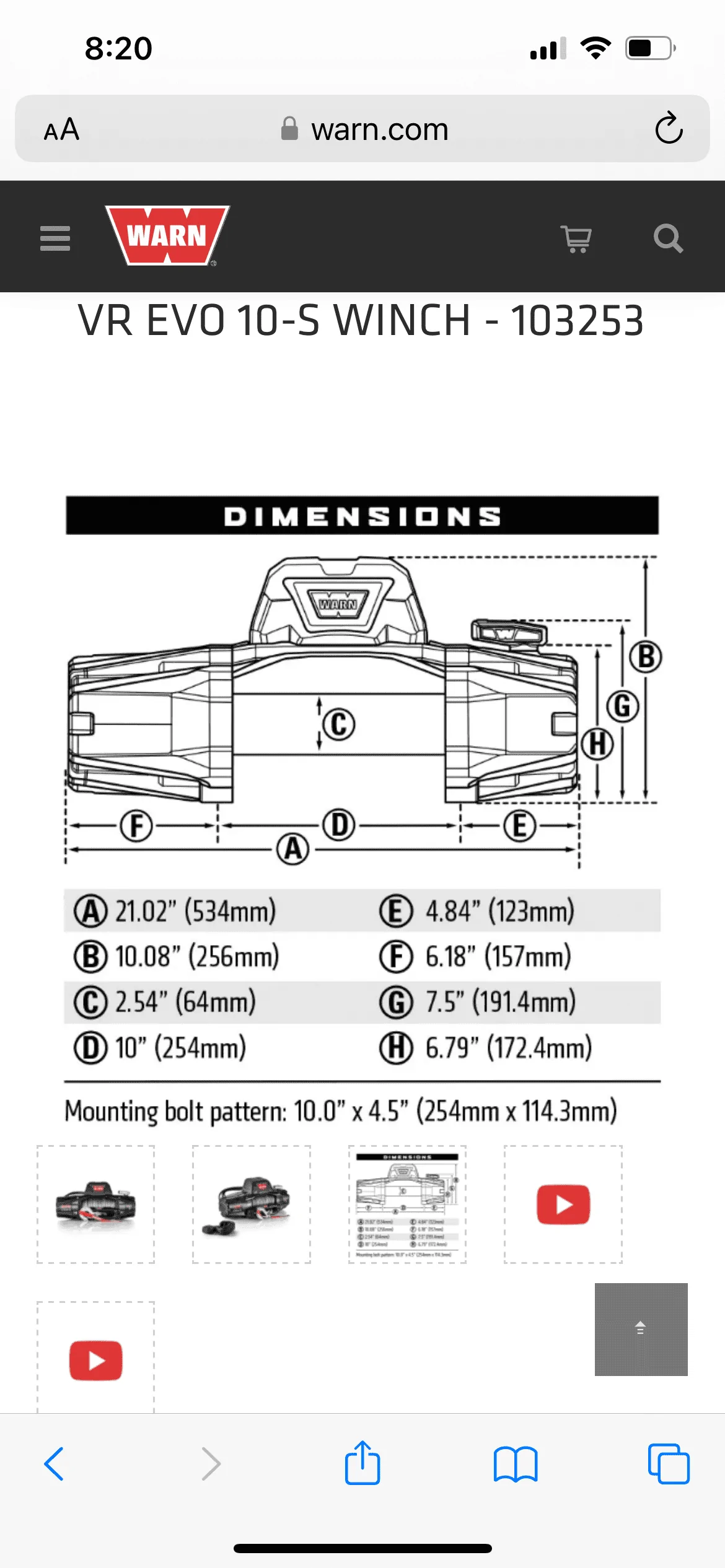

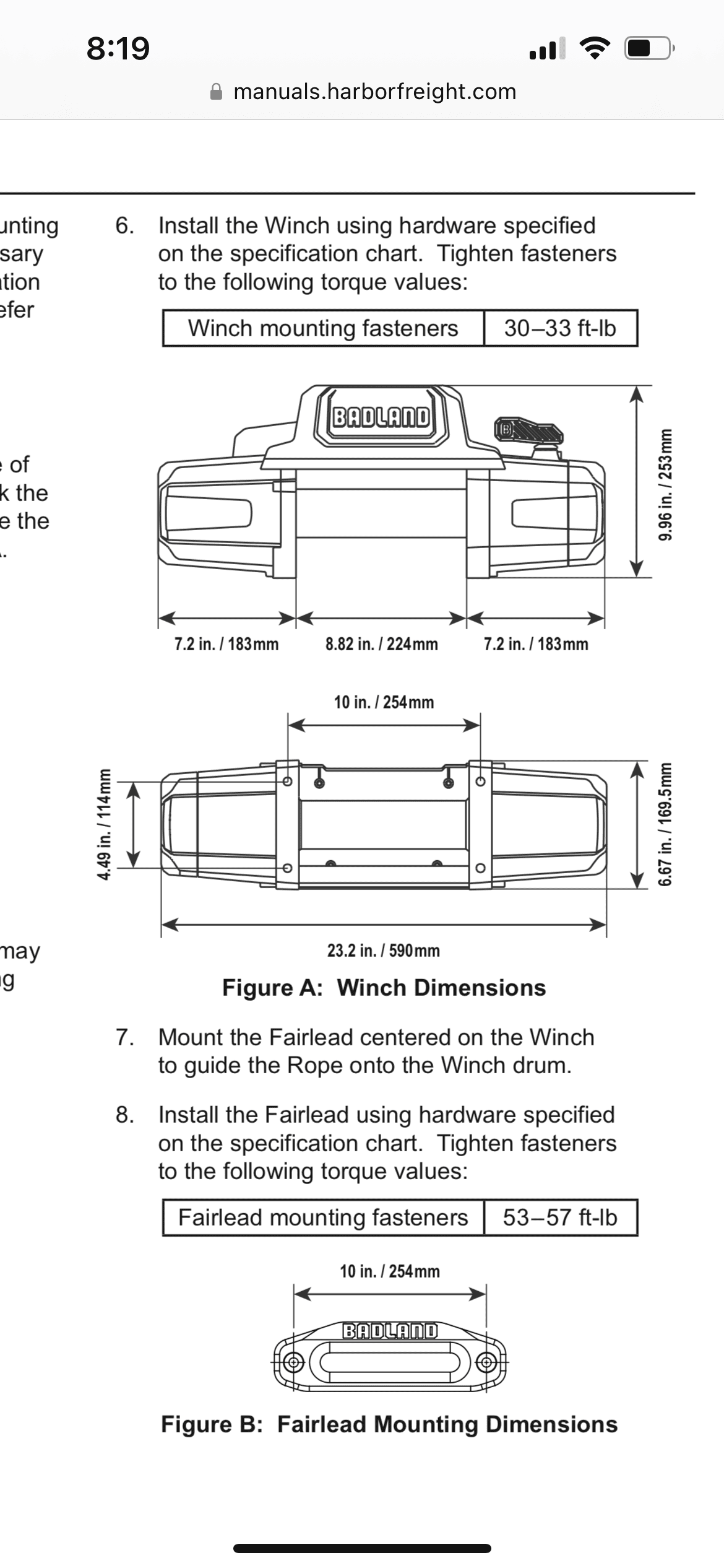

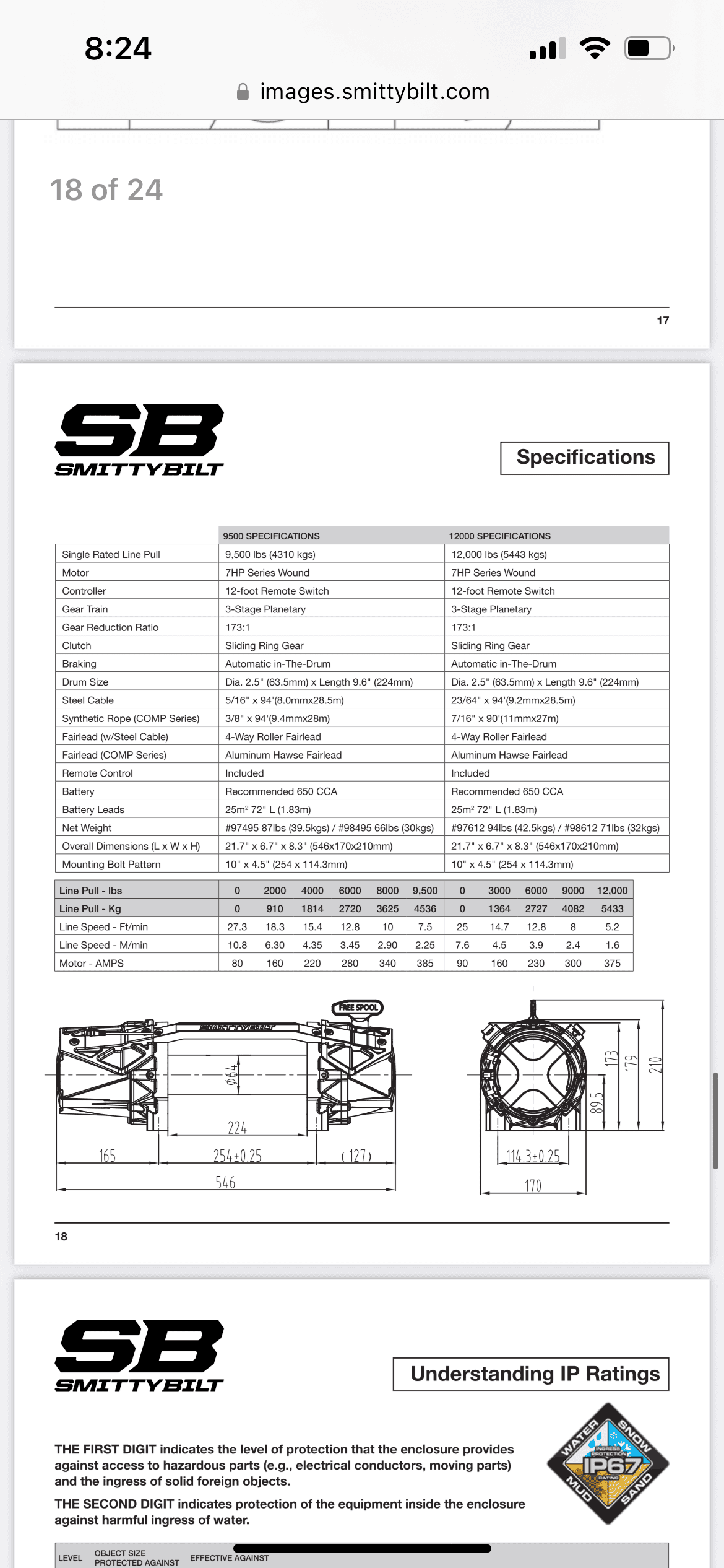

Now have to figure out what winch will fit between the frame horns and the bumper
So far the warn evo10s and the smitty built are at 21 inches wide
badlands is at 23

Thanks for the link

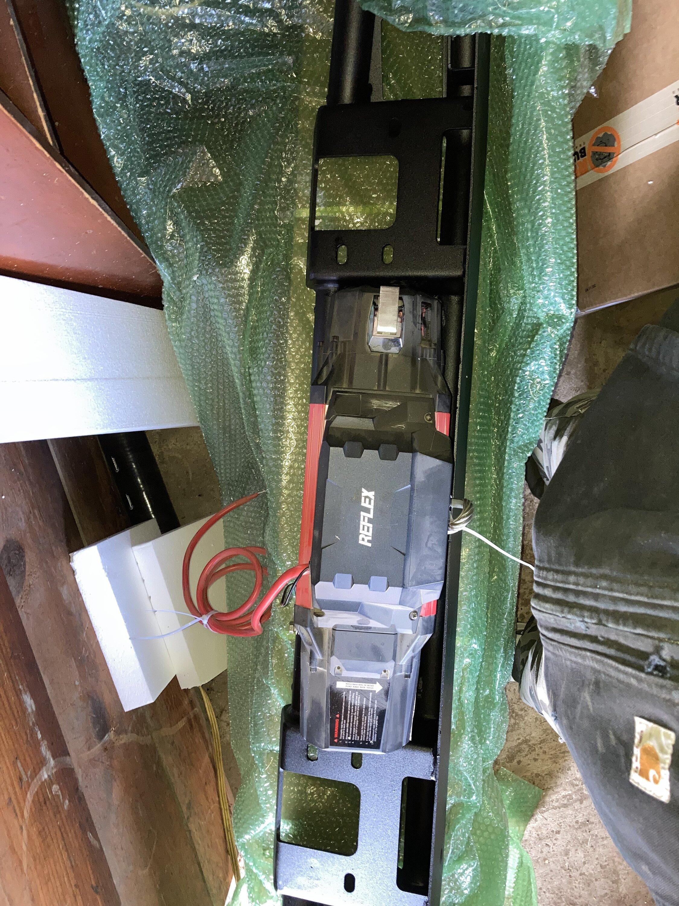

I'm running the older model 12K that is 20" wide. First thing I checked to see if it would fit between the bumper pads. I had not realized they upped the width of the new models. You might still be able to "massage" the pads to fit a new model in there it is only a half an inch on each side. Those pads have some room for that. TBH, those pads could use some reinforcement as well once they are "clearanced". Have you seen the DV8 tow video???

Wow glad I found this thread. I’m looking to do the exact same project for a hidden winch mount. I was looking at that warn 9.0rc winch but have you found any others that would fit? I was expecting more clearance between the intercooler tubes…
BigMeatsBronco
Allan
Nov 25, 2021
52
3,432
10,640
97301
2021 FE 2 door
I think that's the narrowest one and likely the same one I'll buy.
