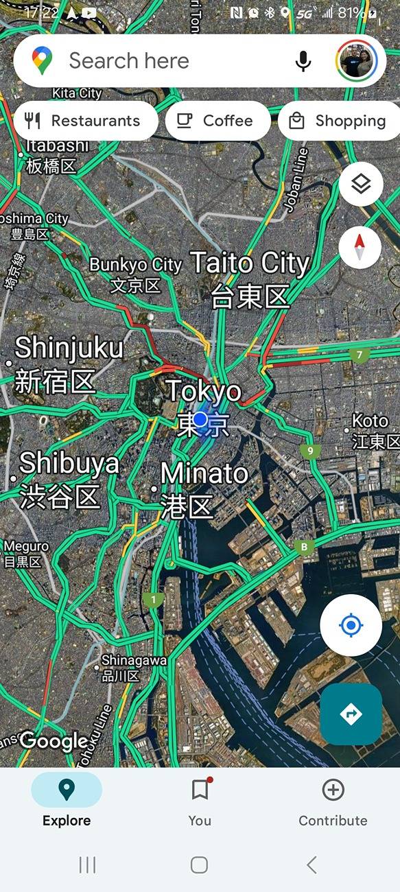

Sorry not that this helps your situation at all, but I thought it was interesting. One of our vehicles at work has a weird issue with the Android Auto. Every now and then the map location will start freaking out and it thinks I'm in Japan... 😂 It's pretty funny, other than the fact that it will switch back and forth repeatedly and get pretty annoying.
Think of how much you’ve saved on airfare! 😏
