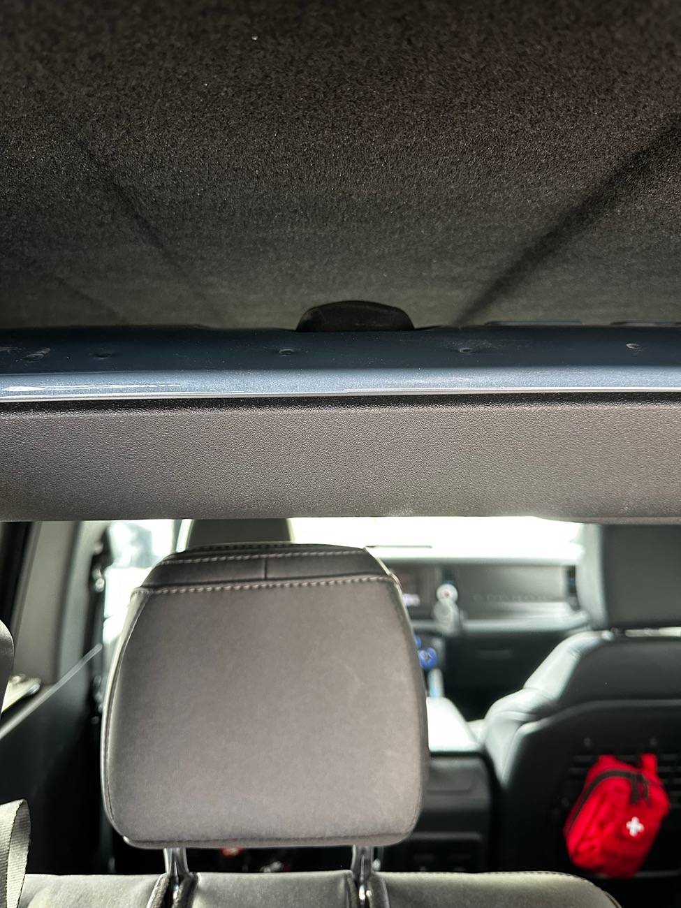

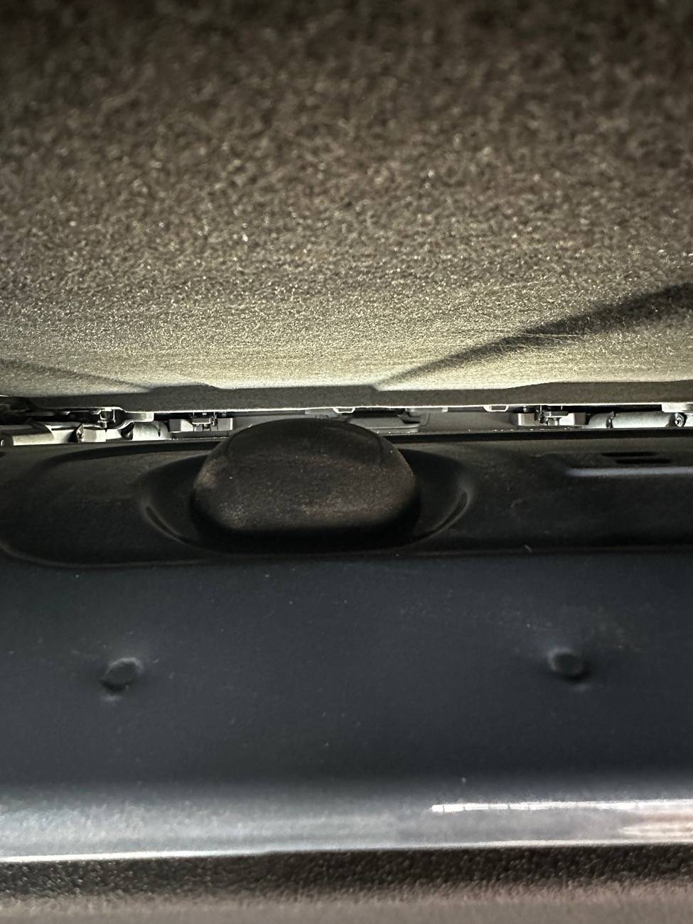

I believe this is the GPS antenna on the rear cross brace on my ā€˜23 BD.
This is likely the SiriusXM satellite antenna. Its location can cause problems when the roof rack is loaded with stuff (as found on this site) and Ford has recognized that the location can cause problems when (for those with a softop) the front section is pushed back.
