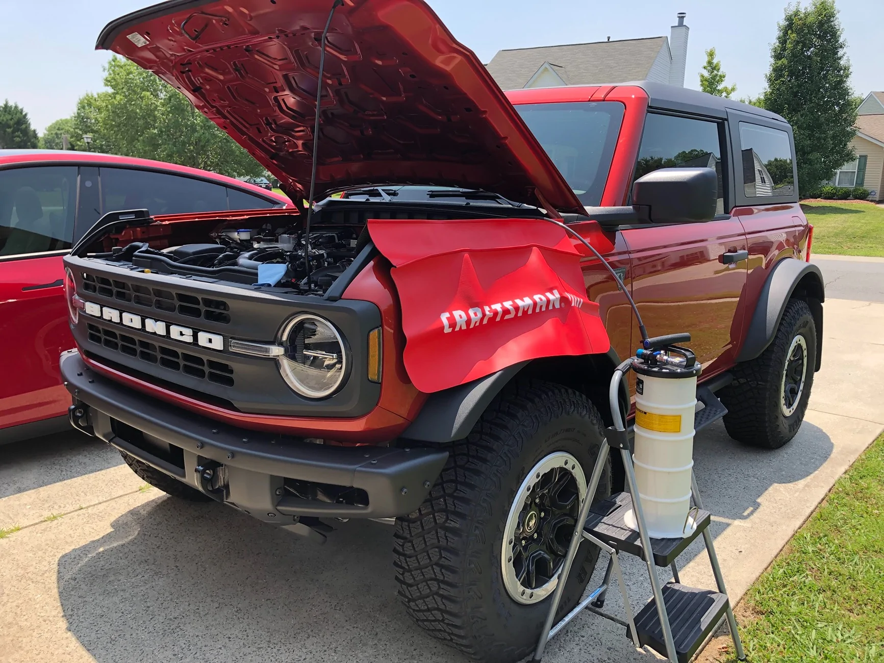

Great advice, I'm about to do it's 4th oil change at 10,500 miles and I usually change it through the top without the need to remove the steel shields. I'll get those bolts lubed up.
Ford Bronco Lubricate shield bolts IMG_1637
I truly hope this fad does not catch on widely. This way of oil change does not empty the most important part, being the bottom of the pan and perhaps particles floating on top. Maybe doing it once every now and then but not normal practice.

I installed the Fumoto and didn’t have to drop the shield on my last oil change.
https://a.co/d/9uuXm0R
Its probably okay if you change the oil every 2500 miles, just do a real drain every 10K. That said it only takes a few seconds to remove the plate, and you still have to do the oil filter from the bottom. Not worth it.
