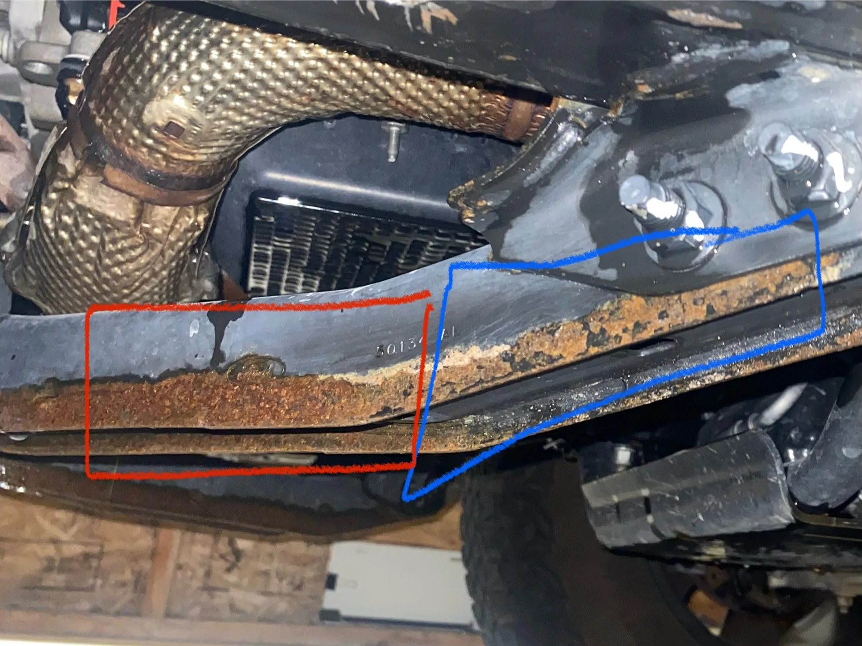

The skid plates on both cars are attracting rust, especially where the bolts are. I also did a professional rust treatment of the underside and frame when the Wildtrak was new, but I am still seeing a notable number of rust spots on seams in metalwork and other areas, including skid plates, modular bumper, factory hitch, and metal fasteners. My wife's 2018 CX-9 with 115K miles looks cleaner underneath.
I am now also using flat black rust reformer spray to try to keep it at bay with spot treatments:
Rust-Oleum 248658 Stops Rust Reformer Spray Paint, 10.25 oz, Matte Black
Anyway - if you live in New England, and care about long term, I suggest you take a proactive approach and buy a can at minimum.
A nearby friend of mine with a 21 Badlands (also lives in MA with ski house in NH), and his looks notably worse. Below is a pic of him trying different rust treatments. Red is before, blue is after. This was a rust dissolver, but it proved to be too much work since it requires sanding, scrubbing, waiting, painting, etc. The reformer spray is one step and far easier for hard-to-reach treatments and ongoing touch ups.

I grew up in NH. All my northern cars suffered tremendously. If i had a vehicle I cared about and still lived in the area, I'd have undercoating treatments done preventively. I haven't done much research since, now living in the south, but some type of fluid film or similar done annually before winter seems like the best way to save your vehicle.

I live in Florida and have the same rust on those cross members. I have rust in a tone of areas with the seams like you mentioned. I've never been on a beach either. Mine is a 2023 and I'm constantly chasing random rust underneath. Ford failed to coat the frames.
