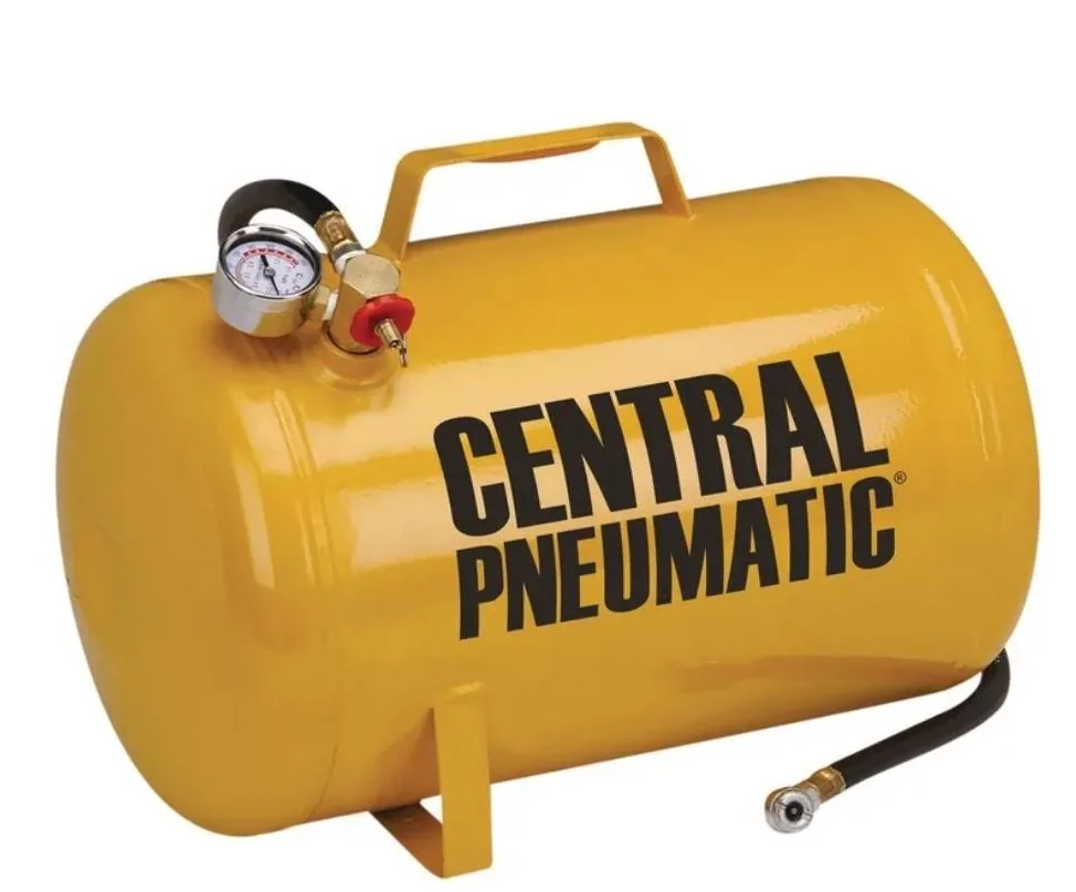

Back before people had fancy pumps, in the 1950's and 1960's, these type of simple air tanks were very popular for trips to the beach. Assuming you air down to 15-20#, a tank might let you add 10# per tire, or more depending on tire size, to allow safer highway travel for the trip home. Since you plan to install an inflation pump, this $38 tank is only 16x12x9 inches for 5 gallons of air, and a cheap solution for the interim. You'll have to do the calculations, there's an 11 gallon version for $70, but that takes up more space 14x23x13. These work well, if you fill them! My installed ARB pump cost $750 so those aren't cheap. A good portable pump is a good value as well. But there's an elegance to a simple tank with a 3' hose to get you home!
https://www.harborfreight.com/5-gal...7cEpesU6923A_7Q-5H0jup11fZmazGVhoCjXoQAvD_BwE
