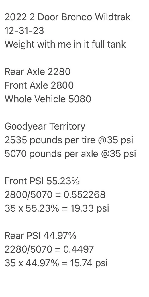

This is what I use on all my vehicles to “ballpark” what the tire will carry at what air pressure. The Goodyear Territories that come factory on a Sasquatch model will carry 2535 lbs at 35 psi. So 4 of those will carry 10140 lbs. So I weigh my vehicles at the local elevator (I know not everyone will have access to a free scale) by front axle and rear axle and come up with a ratio for the MINIMUM amount of air pressure needed to carry that weight. If you know how much weight (vehicle plus cargo) you’ll be carrying then you just put more air in to carry weight. I usually run 5-10 psi over this minimum to make sure I have enough and use the majority of the contact patch. Please realize this will make for a little cushier ride and it might feel a little sloppier on the road because of a softer sidewall. But it’s a trade off.
Ford Bronco Question about proper PSI on E rated tires IMG_0283
A prime example using this technique is on a HD pickup where the factory wants you to have 80 psi in the tires and when you’re not hauling a load you wear the center tread of the tires out before the outer treads.
