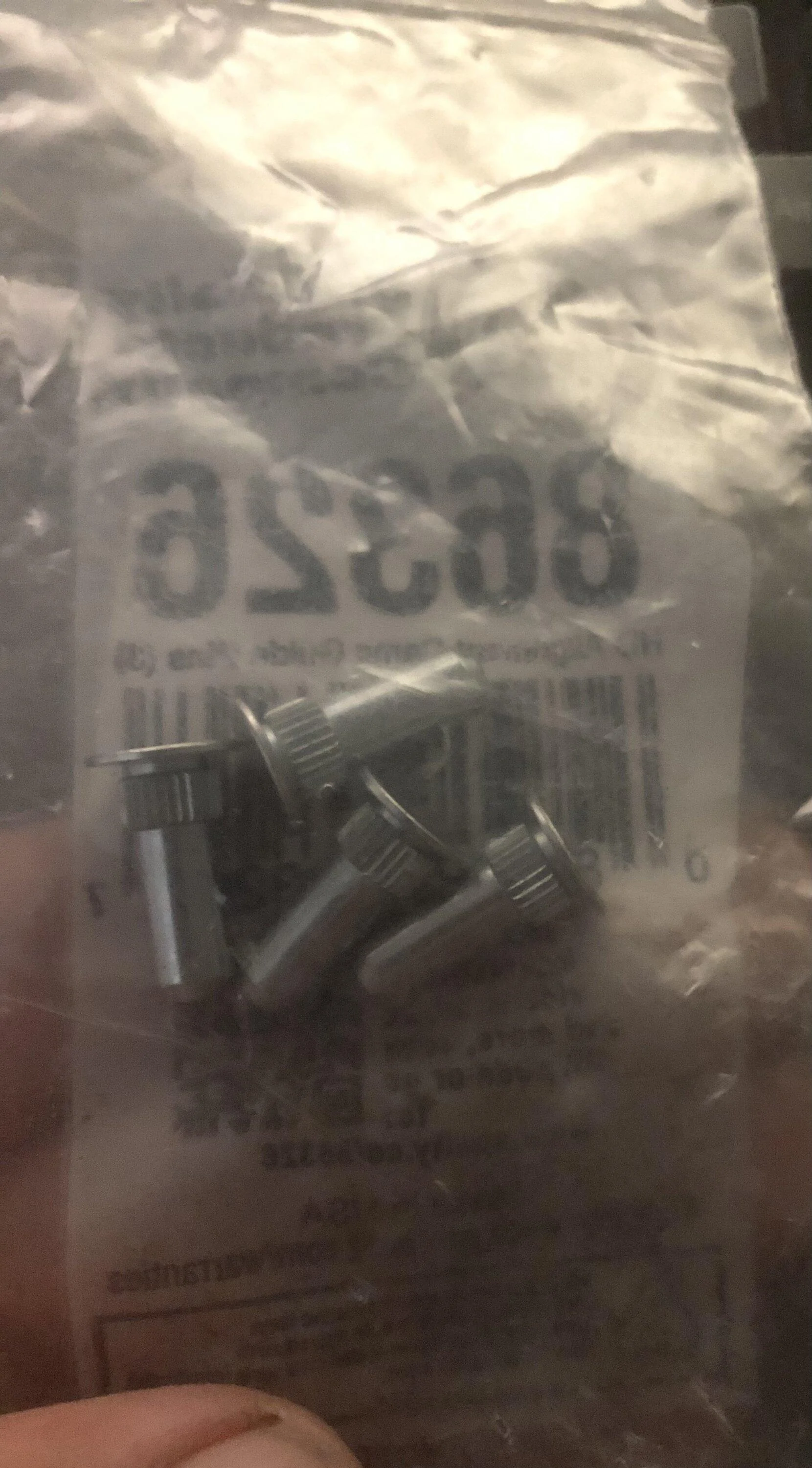

These are the pins that worked for me, vs the shorter one because the back part of the pin was flat vs the shorter one was domed. After installing these I trimmed them to match the oem lenght.

Where did you get them from?

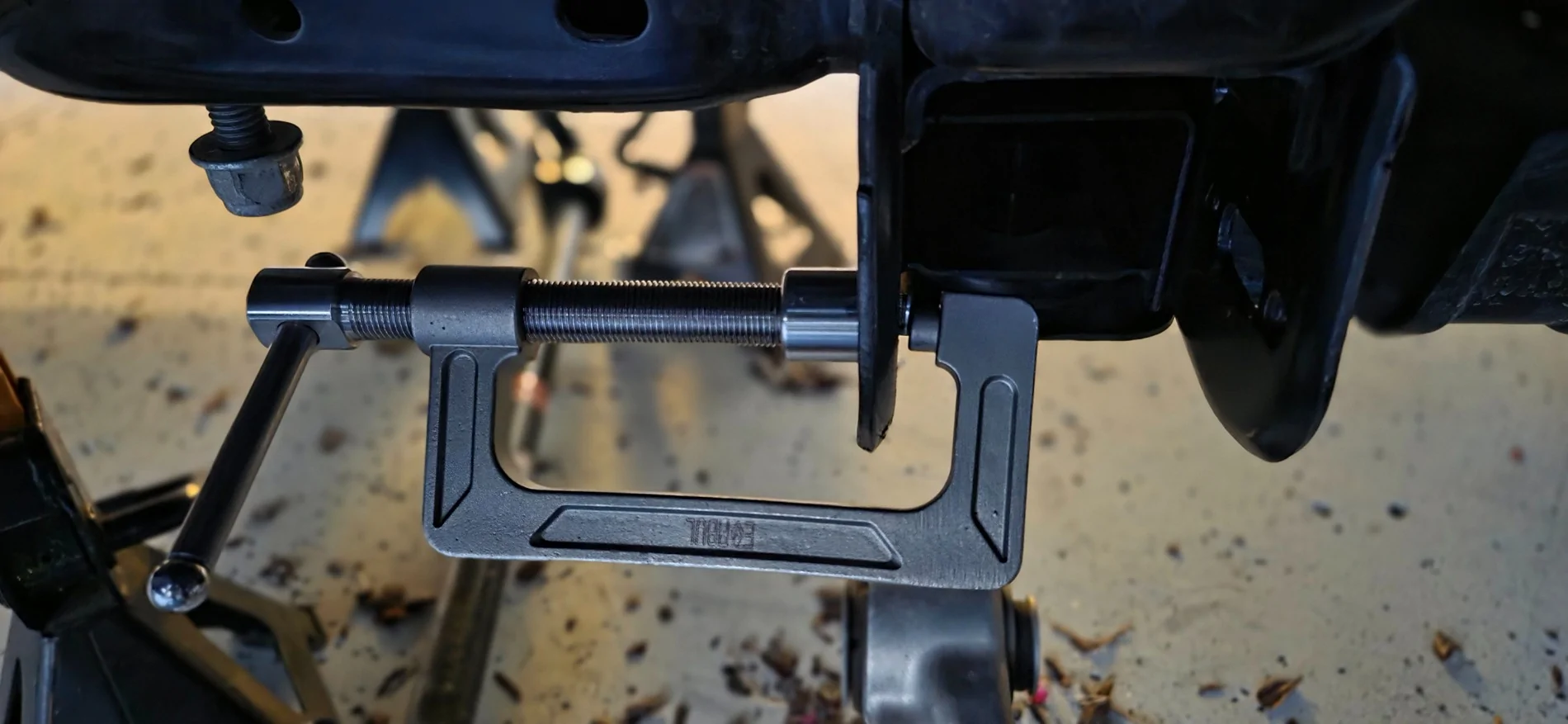

How did you press them in?

Still no ford part number for these?
How did these end up working out? 2 out of the 3 reviews on amazon said they fell out right away.
no issues at all, they have been on for over 1 year and no signs of falling out

removed the lower control arm, used a C clamp and a socket to press them in, no issues
I tried this, because it made sense, and still had to drive them in the last bit with a flat 1/4" punch... which was harder to get an angle with on a couple pins. I used a small 3" C-clamp that didn't give much leverage, though. Maybe a C clamp with a hex head to torque it down?
I imagine the Amazon people didn't press them in correctly or they were using them on a different vehicle. There's no way they'd just fall out after being pressed into our LCA brackets.
Yeah now that I put them in I see that. They are tight.

I bought the SPC pins mentioned earlier. They aren't working well for me. I tried a couple different clamps, and even an alignment installation tool. I think they are just slightly too large. I can't get enough leverage on the clamp to press them in fully. When I really crank on them the clamp tends to shift off to one side. Ant other tips? You can even see the clamp starting to bend in the pic below.
