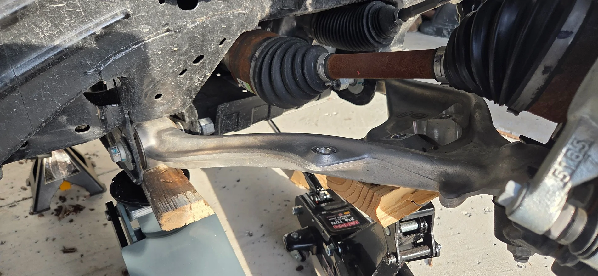

On a related note, I can't get the lower control arm bolts out no matter what. I've tried to relieve pressure by supporting both the outer and inner joints them using a hammer. No luck though.
Ford Bronco Help- can't remove front lower control arm cam bolts 1776124490637-s
NateTTU
Nate
Feb 24, 2026
47
Fort Worth, TX
2025 Bronco
Yes, it’s now clear. I didn’t remove via the nut side and, therefore, torqued the cam washer onto bolt pinning washer to frame. Not fun to remove. Note to others…. Put a wrench on bolt side and don’t allow to move and use impact on nut side and bolt slides out without issue. Very simple and kicking myself for such a no brainer. I have all new hardware. Other side was done in an hour and even installed revised crash bars. I look brilliant on other side of car😁
I ran into the same issue. I’ve already got replacement bolts on order and was able to complete the other side the correct way—it only took about 10 minutes to disassemble.
How did you end up removing this bolt? I’ve tried using an air hammer without success. At this point, I’m considering cutting it out with a Sawzall and Dremel.
