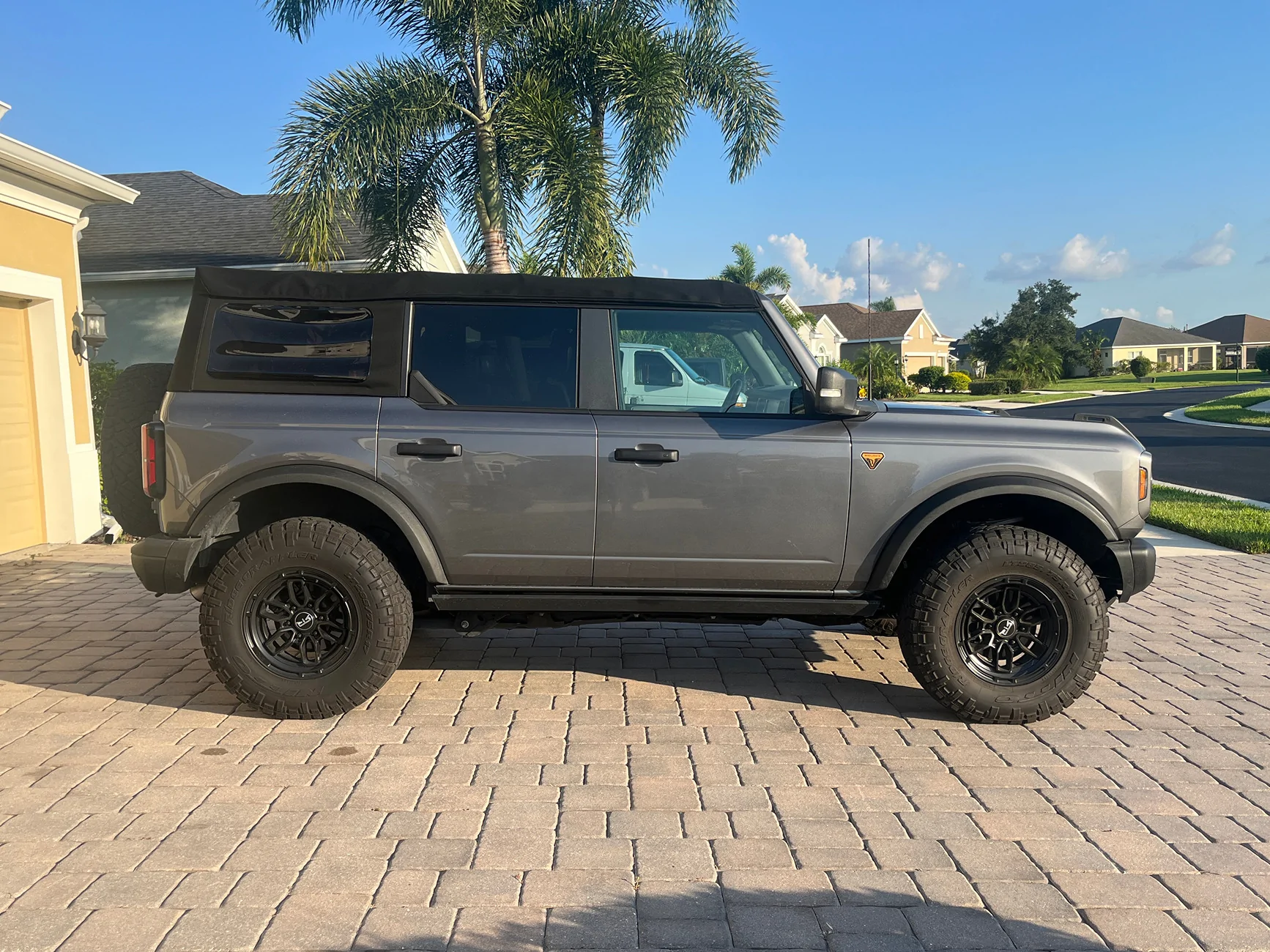

I have a non-sas Badlands with the 6100s and stock springs. I have the clips on setting #2 in front and #1 in rear. The Bronco sits level, around Sasquatch height. I had the same issue with jarring over the smallest bumps; I really hated the ride on the stock shocks. The ride is much smoother with the 6100s. I don't get any of the squeaks, rattles, and jarring/shaky ride like I did before. There is only one very specific scenario in which I don't like their feel. When on the highway at high speed, there can be what feels like a lot of tire movement. For instance, going over a change in pavement height or pothole WHILE also going around a curve at highway speeds, it feels very active. I think the factory shocks felt more controlled in this specific case. I will say that I have been on dirt roads at high speeds (not as high as highway speeds though) and it feels great.
Of course things can feel different depending on clip location and wheel/tire setup. FWIW, I have RTR wheels (22 lbs), with 285/75r17 Ridge Grapplers (65lbs). I run 36-37 psi on road.
I also have never owned Fox, King, or Eibach (so I can't compare), but yeah, it will definitely get rid of that jarring feel on road, they feel great.
Thats what I have and what I am looking to do. Do you have some pics to show along with what tire size you are using? TIA
Here's the only photo I can find. I can take more later from different angles. Tire size is 285/75r17. Eventually I'd like to go with 35x11.5 or 35x12.5, just because that rear tire well is huge, but I get compliments all the time on the "34s" though. I've parked next to Sasquatch Broncos many times and you can hardly tell the difference between these and the stock Sasquatch tires.
