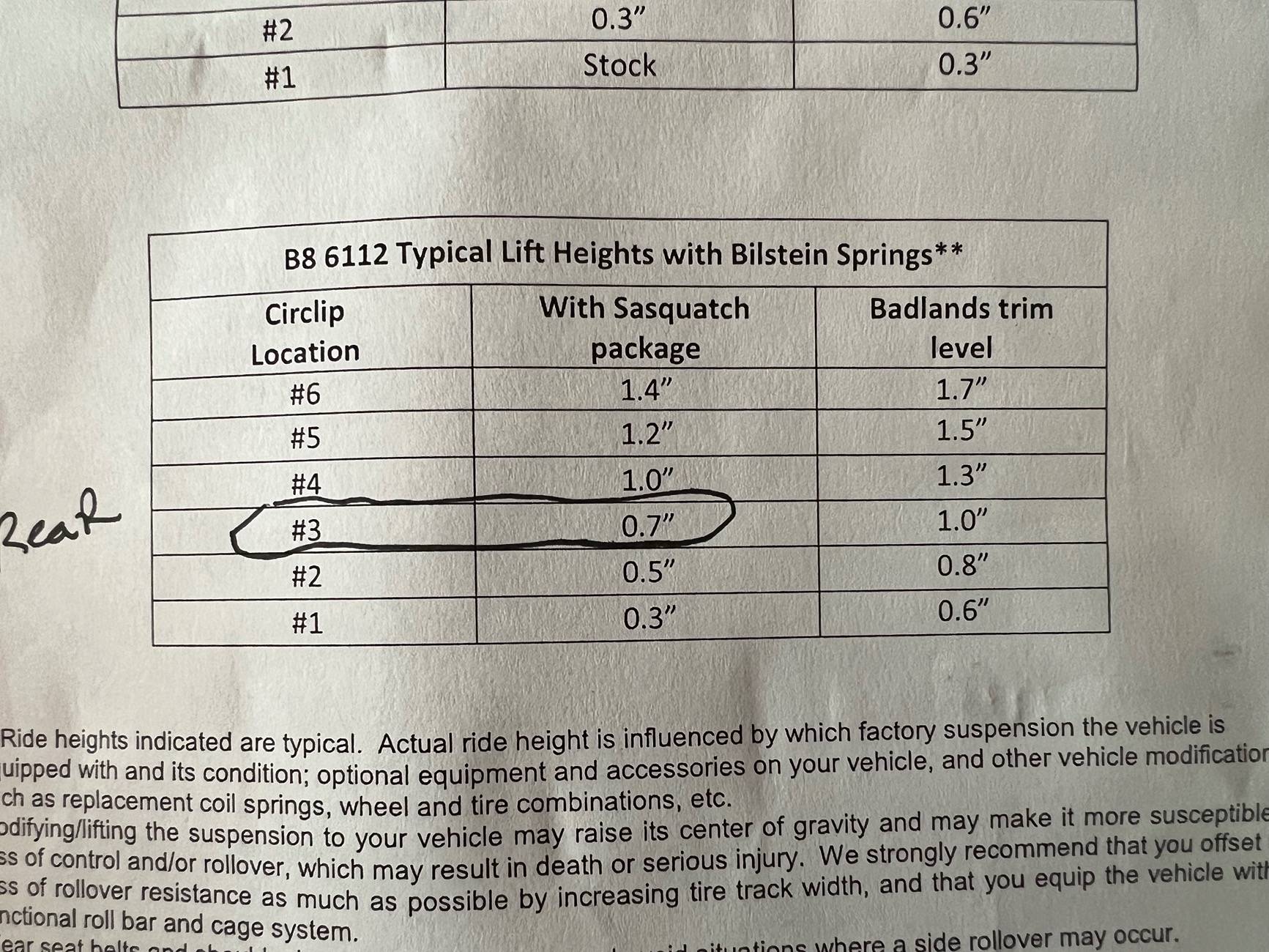

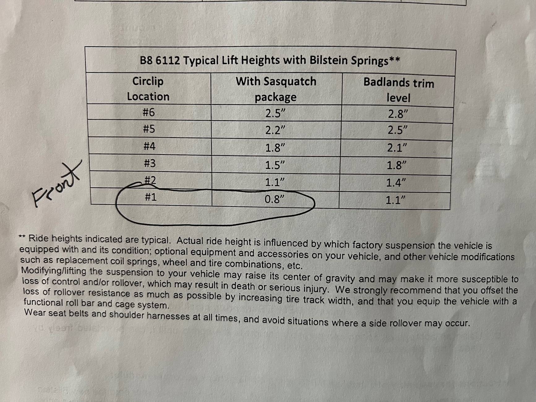

As I said above, actual vs stated was pretty close for the front. The rear was twice the stated amount. Mine is a Sasquatch. I ended up using location #1 front and rear.
