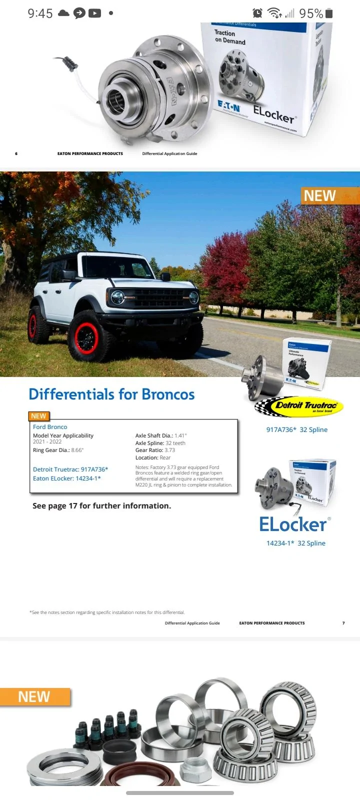

Here's the part number for the e-locker and the true track
Ford Bronco Locking axles recommendations? Screenshot_20230913_094541_OneDriv

how plug and play is gettin the eaton tru track and 3.73 jeep gears into the bronco diff?
Not very - yes there is a part that exists but if you do not have the factory ELD the ring gear is welded so you have to replace all of the internals. By the time you do that, you’ve pretty much just paid for the entire Ford Performance rear end.

But if you want to maintain the 373 gear you use the true track and the Jeep JL ring and pinion up the true track is $760 and you can get a Spicer ring and pinion for 299 and if you're capable of installing it you'll save a lot of money
