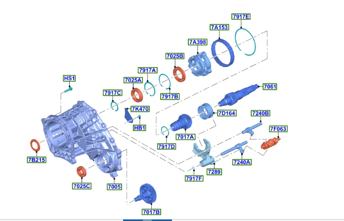

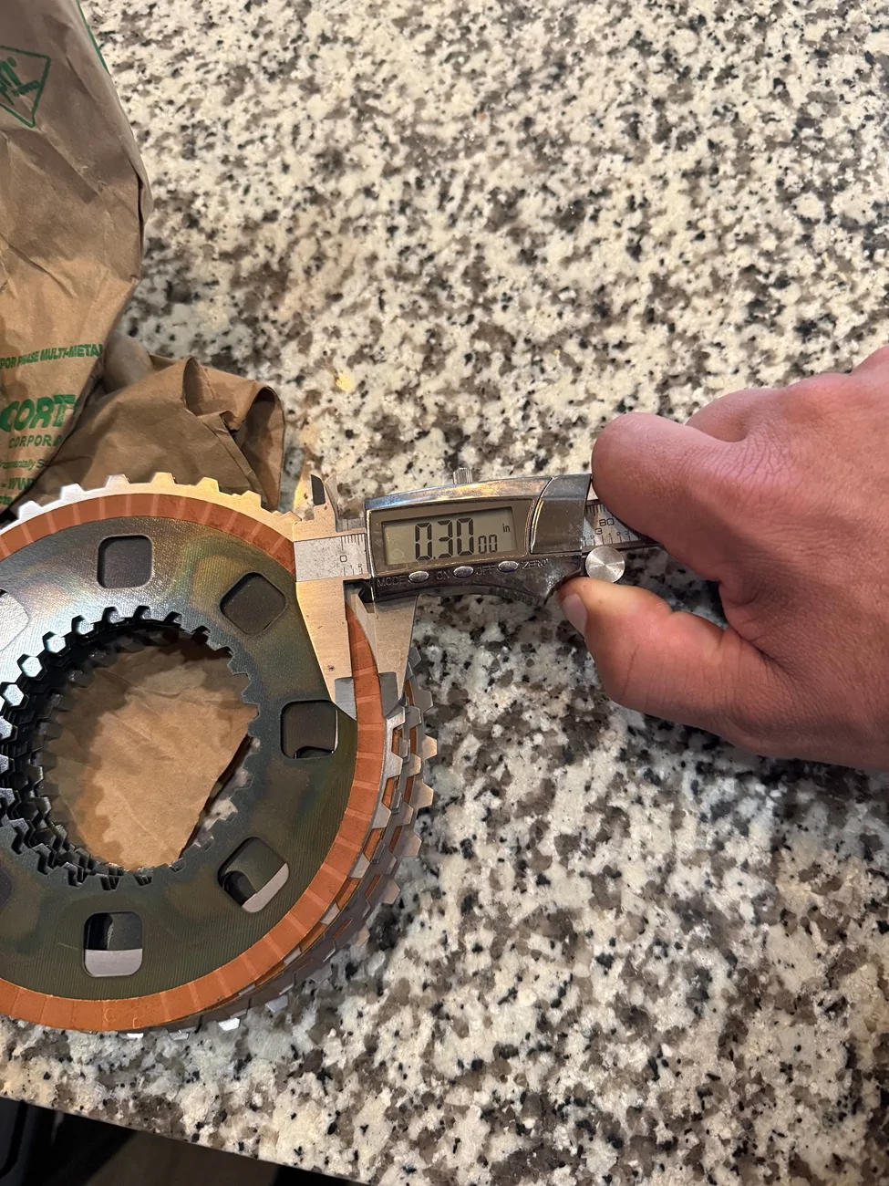

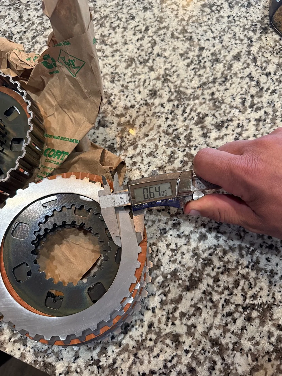

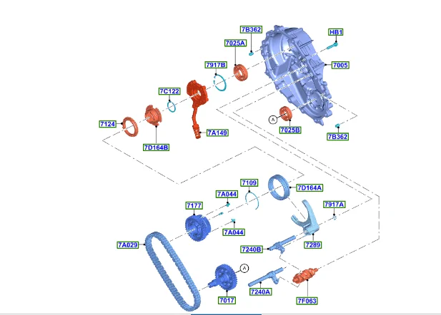

Yes an no. In 4H or 4L the transfercase is 'locked'. In 4A 4wd engages and disengages as required automatically (with no differential) when needed. There is no true transfercase differential in any drive mode
With 4A the transfer case is a differential, using a clutch to send variable power to the front differential. 4H or 4L doesn’t have a physical lock on the advanced transfer case, just a ball ramp that is fully engaging the clutch.
Non-advanced tcase does in fact have physical locking dogs and is not a differential.
