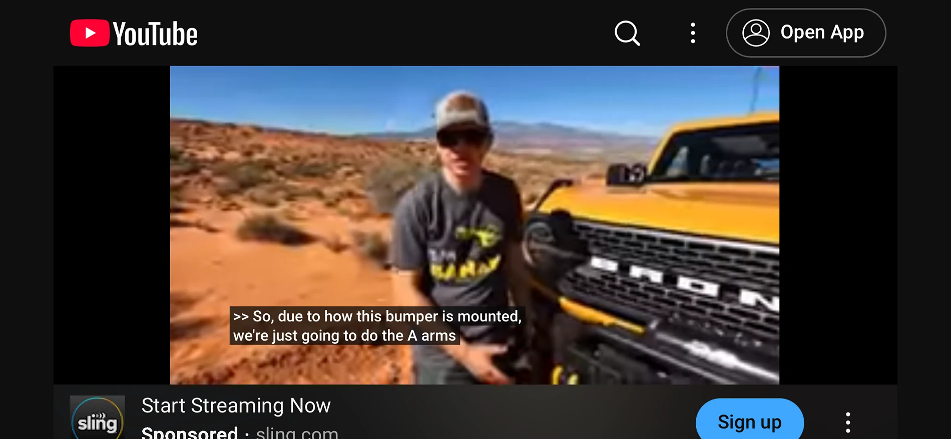

… topic is lockers BUT
The recovery guys didn’t like the aftermarket bumper (brand that is supposed to be a good one) or winch (brand ?)…
Set the tow rope to the A-Frames
Raises questions about having good connections between frame and bumper…
Ford Bronco Locker failure question IMG_7025
Getting towed out will happen more often than losing a locker
