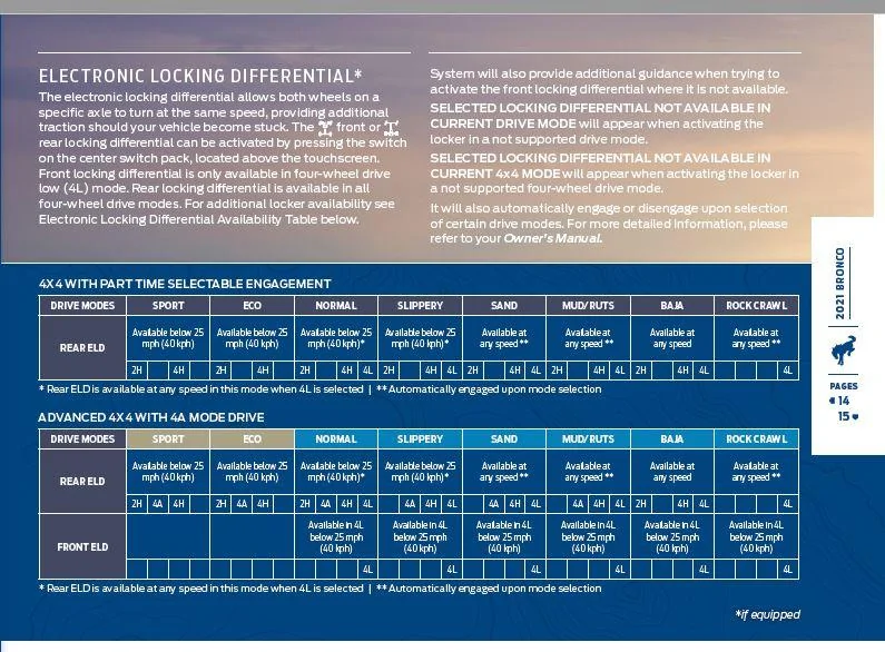

So I have Baja mode which is designed for high speed desert running and my front lockers won't work over 25mph?
I'm guessing this is just another Ford lack of proof reading, no?
No, I think the document is correct. Why would you want your front lockers for Baja mode? I don't think that is the intended purpose of a LFA.

Maybe you're correct... I was under the impression that going through soft/slippery sand (which typically requires speed) one would want all 4 wheels working for you.
I mean when people are spinning them in sand, wouldn't your speedo read over 25 even if you were literally barely moving?

The whole point of lockers is to keep the tires spinning the same speed no matter what. The wheel speed sensors should expect to see the tires turning the same speed when the lockers are engaged.
I suspect Ford will do something similar to what Jeep did with the Rubicon. You can only run lockers in low range under 25 miles per hour. Beyond that, you have to engage the rear locker first before you can engage the front. Since the end with more weight (i.e. the rear end when going up a hill forwards) has more traction, engaging the rear locker first makes sense. My experiments with independently selectable lockers on obstacles confirms this. (I tried a front locker only and then a rear locker only and the rear was much more effective.)
Jeep doesn't seem to have much trouble with breakage on their axles with the lockers with those restrictions. At least not until people put huge tires on factory stock axles and hit the throttle hard. I would be surprised if Ford had weak CV axles in the IFS when lockers are installed so I expect them to hold up to "normal" off road use well enough.
Just remember how to use selectable lockers when you're on the trail. Turn them on only when you need them. Turn them off when you don't.

The document that I checked does not say auto or manual. I wouldn't think it would matter and would still kick the locker out when it reached 25mph.
So from this post, it seems that the normal 4x4, not A4x4 gets to have more fun... 2wd locked rear at any speed in sand, mud, and Baja. Thats odd to force 4x4 in the Advanced tcase for rear locker except for baja.

An old school speedometer cable in the transfer case would see over 25 MPH if that happened. But modern vehicles don't use that any more. They use the ABS sensors in each wheel. The computer will see that one tire is spinning and do the traction control bit to get you moving.

When in 4L in either transfer case there is complete lock F/R, there will be no sensor driven slip or unlock. Driving with both axles locked require prudence by the operator.

The rear locker releases above 25mph, indicated. Vehicle can be still with the wheels spinning and it will unlock when the Speedo hits 25. The 4A won’t have any affect on locker operation. The front locker is not a clutch type, it’s is a electro-mechanical. I have not operated one, but I have no doubt it will release at the same point or lower. Front locker makes the vehicle very difficult to steer. It would be horrifying at speed.

You also have Rock mode and that is absolutely where lockers can be used.
